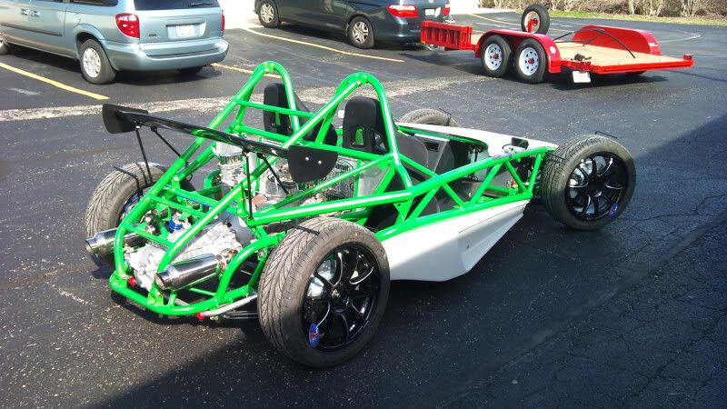

    I'm assuming this will be a road worthy vehicle with lights and signals, right? I didn't read that anywhere in the thread. However, this is a super awesome build. Very impressive. I'm glad I wore brown pants today, because I crapped them when I saw this. And one other question... those are cup holders I saw in the center console right? Awesome!

    Yes those are cup holders. I did not want them till I saw them. It comes with a lighting package that I have to install.
    The car after mine wants a scoop. I am going with out for the beginning. I may fabricate up something myself. I would think a verticle intercooler might be the most effiecient option but not look the best. I am not all that worried about horsepower, so my first step will be just getting it up and running.

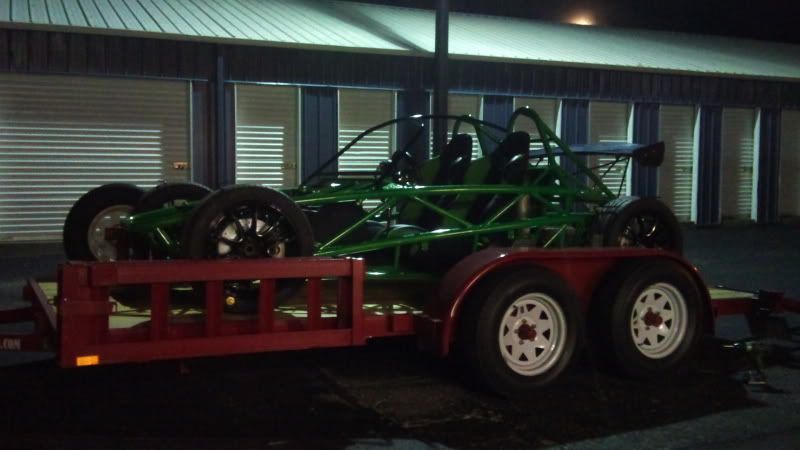

    I know people were talking about a lack of windshield in a few posts... I see on the tailor in the first pic and on the car in the second pic that there is a removable piece of cage that looks like you could throw a piece of lexan over it and have yourself a windshield.

    There is an option for a windshield. That is what the black frame is for. I am going without, it just weighs it down. Plus if you have a windshield you have to have windshield wipers and defrost to pass inspection to get the plates.
    I got a helmet, its a full face. That covers the windshield for me.

    Thanks for cleaning it up! I am heading to pick up my trailer this afternoon. 81" x 12' single axle aluminum. 610 pounds.
