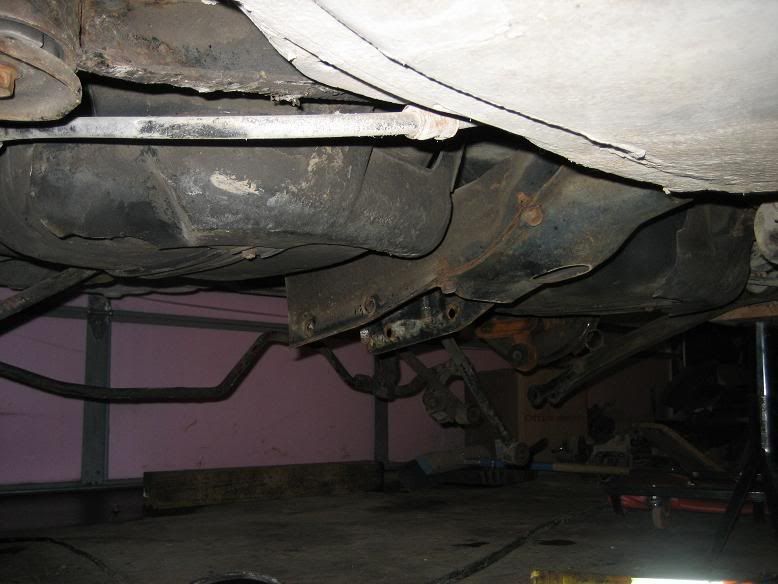

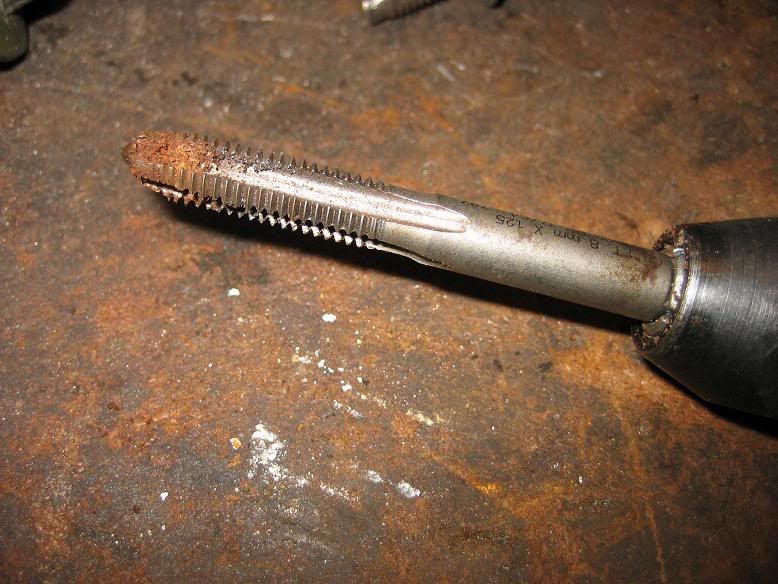

    Old, unused captive nuts are ftl.....

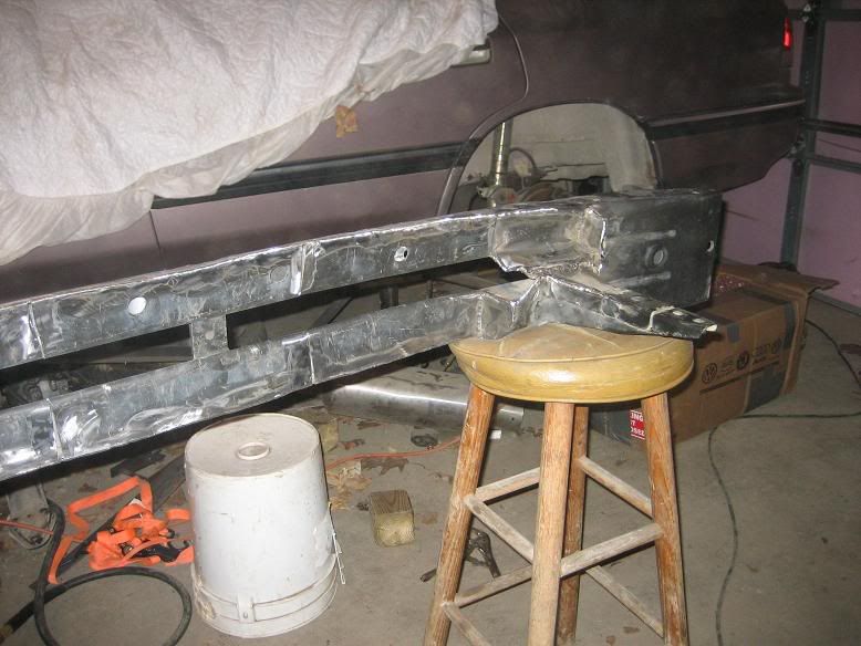

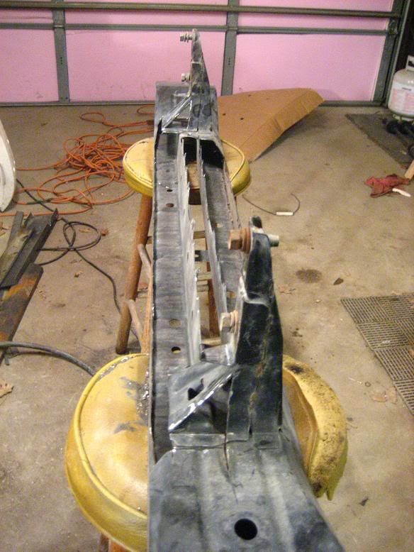

    After that fun I was able to get the front half of the rear crossmember in.

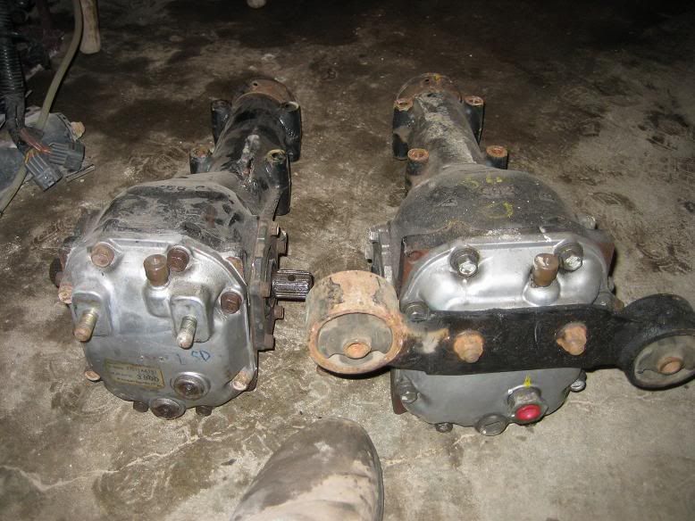

    Hmmmmm. What do I have here? Looks like an R180. When I get my axles this week, she'll be ready to go in. Hopefully it is a 3.90. When I get my axles I'll know for sure.

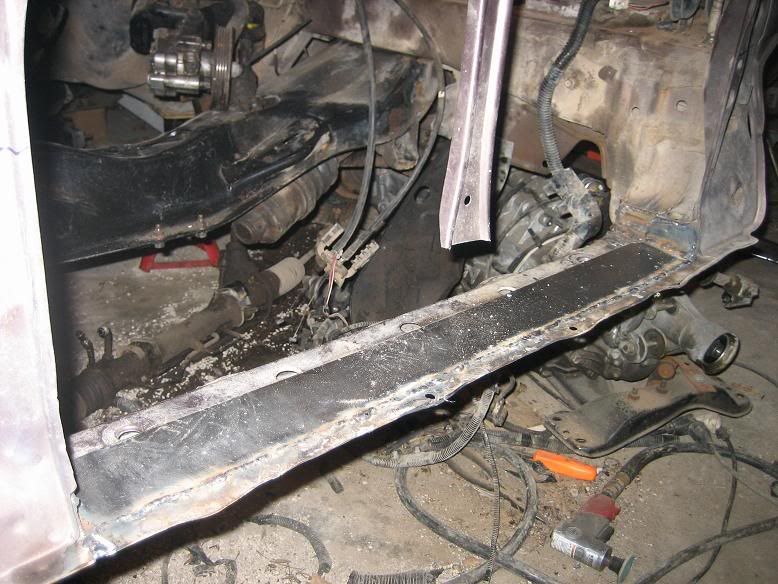

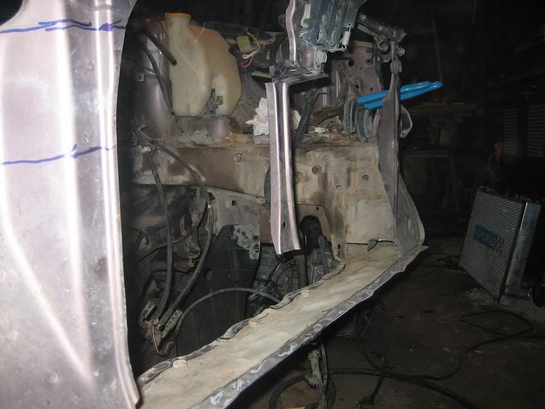

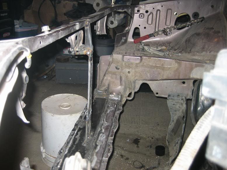

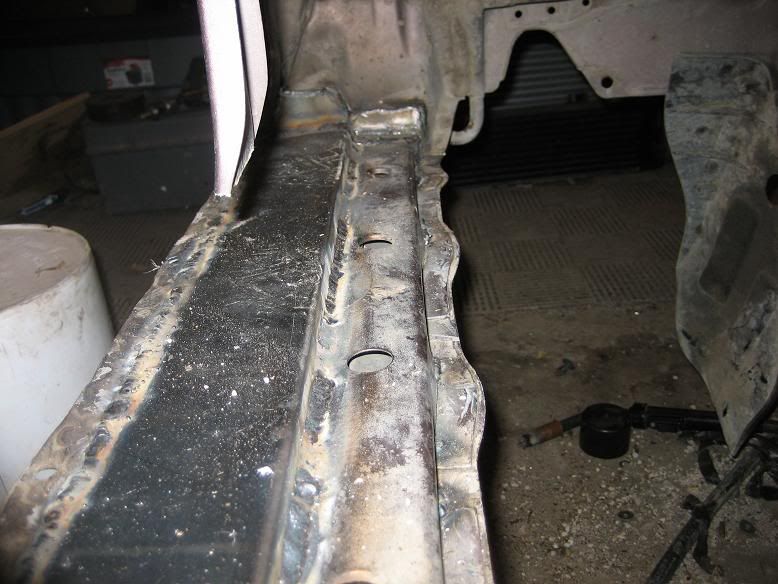

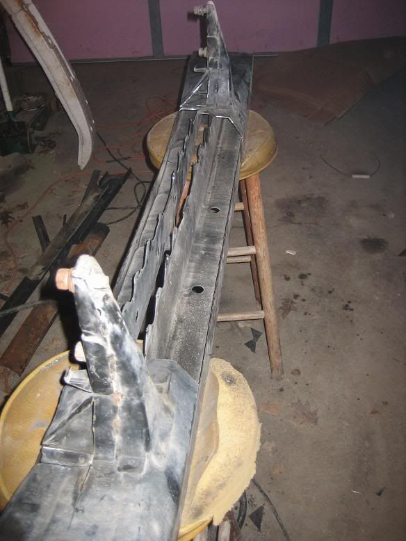

    I didn't get much time to work on the car this weekend due to having to install a laminant floor in my mother's kitchen. I spared a little time though.

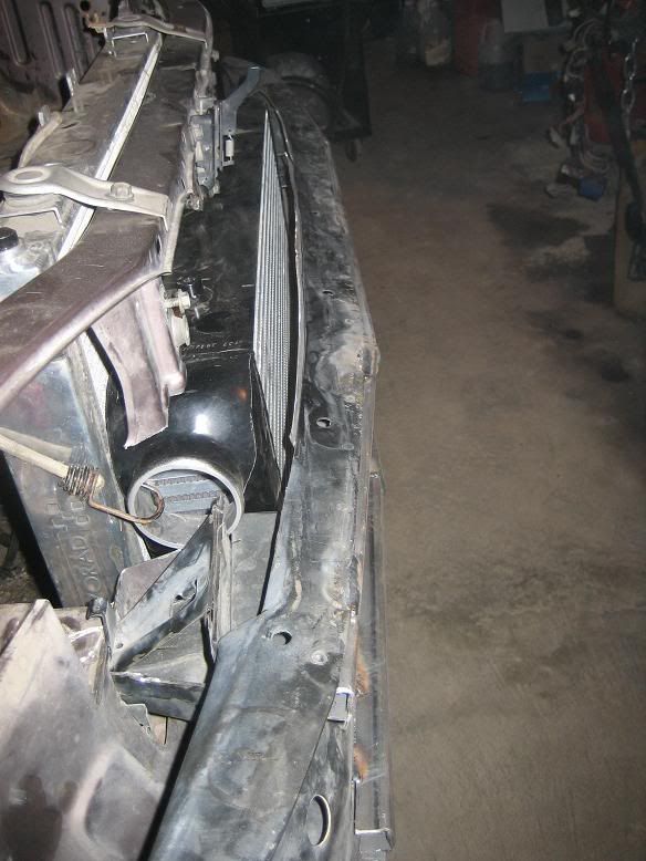

    I started working on the front core support where I found that the lower core support is taller than AWD cars. Weird. :dunno: Oh well, it makes a little more work out of it.
    Therefore it all needed to be cut apart so I can modify it. Also, I started my jog in the center support. It might still need to come up a hair. Everything will be boxed-in and reinforced to be as strong, if not stronger than the original.

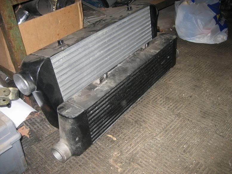

    Why am I going through all of this? I want to fit a decent sized intercooler in there and maintain some semblance of a bumper beam, which is also being modified extensively.
    Old in front of new :biggrin:

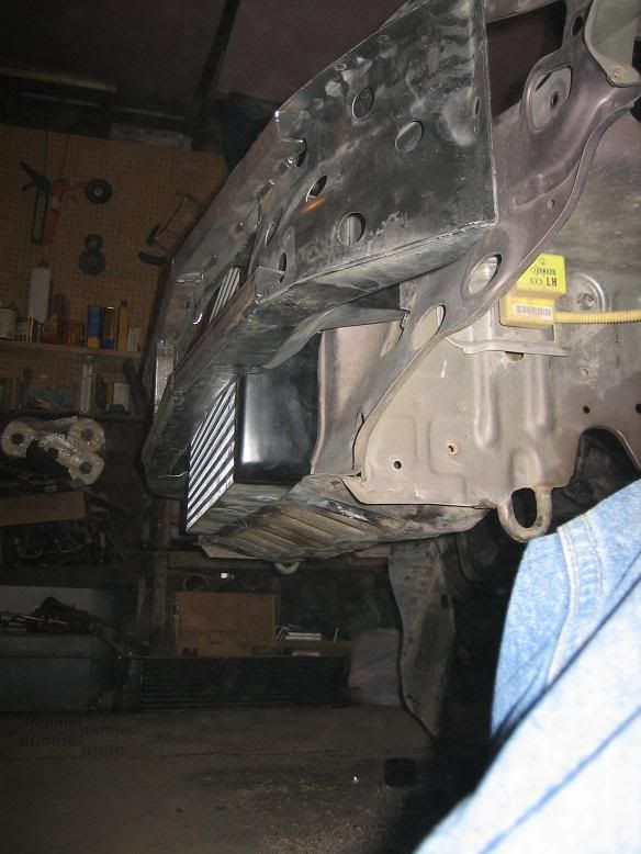

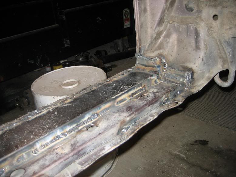

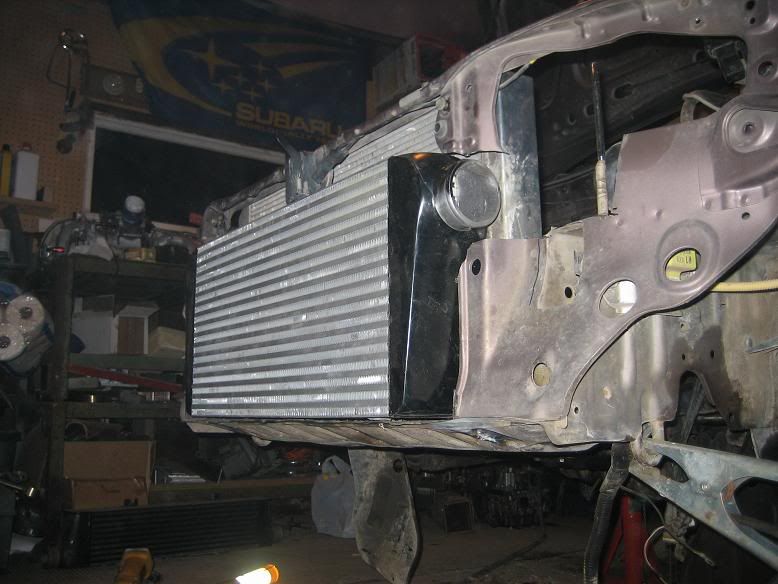

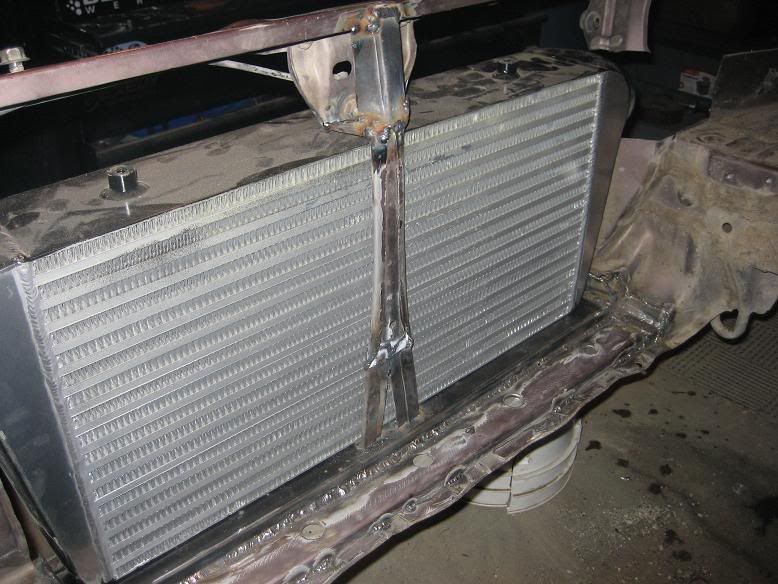

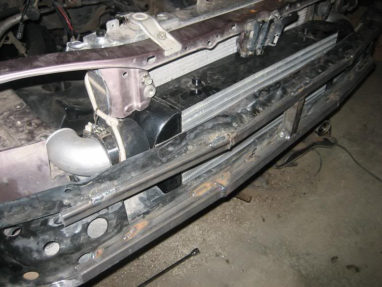

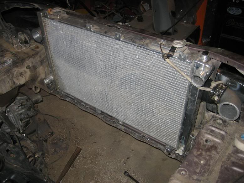

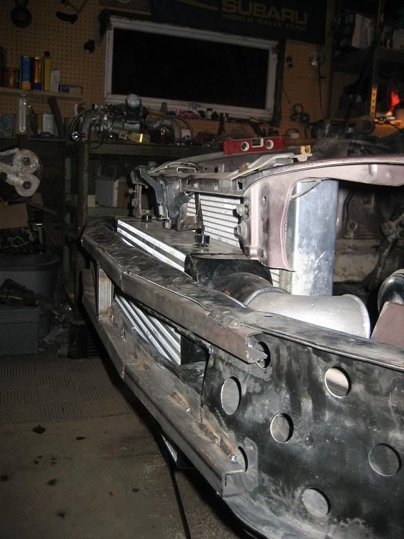

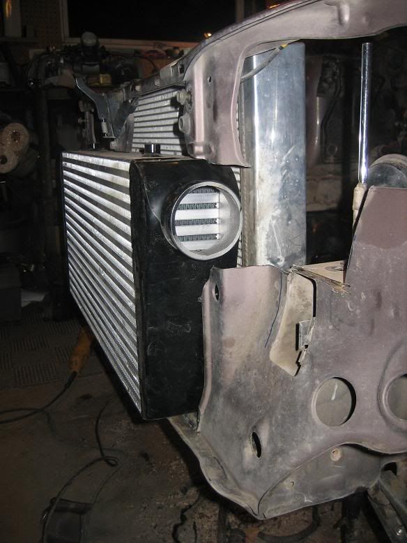

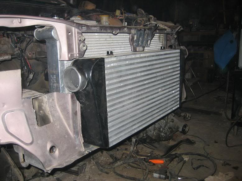

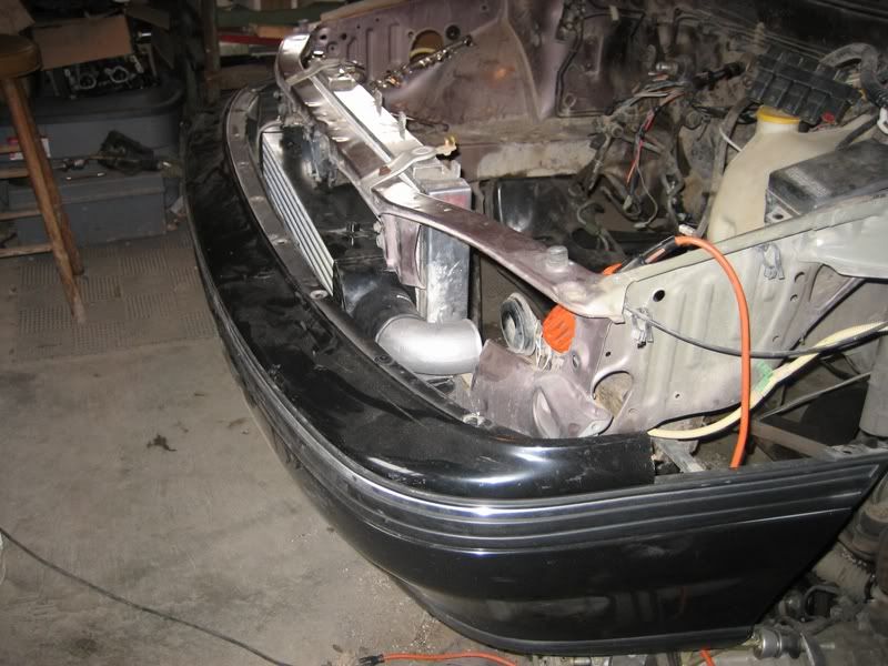

  8. piddster

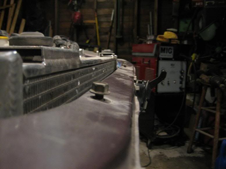

    No class tomorrow means I got to work on the car tonight. All I have to say is welding contaminated 18 GA. is the toughest welding I've ever done. Damn.
    That is the tentative IC mounting, ish. I need to weld brackets to the bottom of the IC, and some mounting brackets to the bottom of the core support. I had to buzz off the center support so I can move it up a RCH. I'm not close to done yet with this part...
  9. fobiawrx
    fobiawrx Fabiola
    is that ic tight up against the radiator?
  10. piddster
    There's about 3/4" of room to get my center support through. Why?

  16. dipp
    dipp Well-Known Member
    25
    nice e-bay intercooler. looks kind of sloppy there autocross.
  17. piddster
    What's sloppy? The welds? Half of them are covered in residue so you can't even see them.
    Lets see you so any sort of fab work or welding on 18 GA covered in paint and e-coat.:hsugh:

  27. piddster

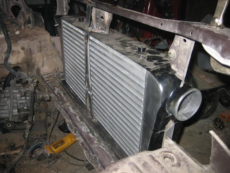

  29. piddster
    Thanks Carl. It's starting to take shape. I have a lot of welding to do still, and other adjustments.

  31. piddster
    Uhhhh, what? :dunno:
  32. dipp
    25
    the intercooler is the bumper beam.
  33. piddster
    Not in this case. As you can see, it's not a structural member of the car. ;)

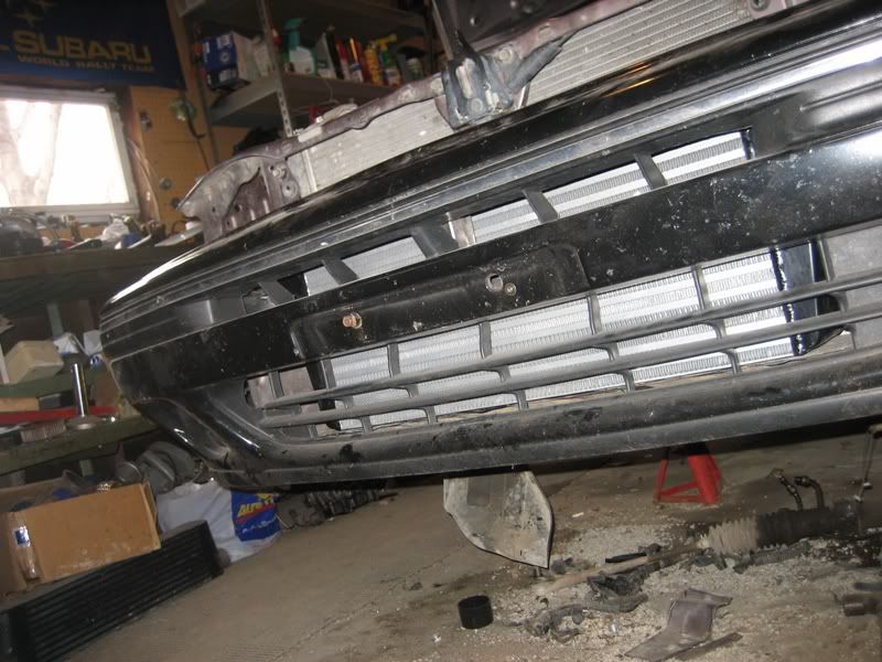

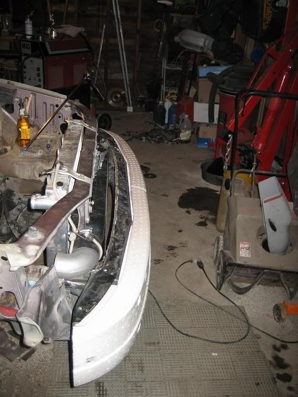

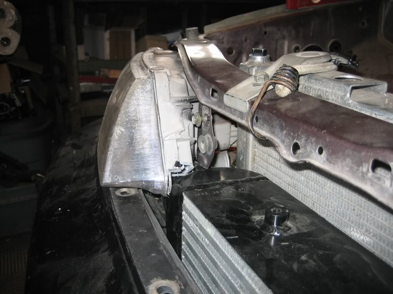

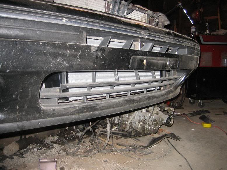

  35. piddster

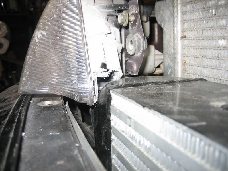

    Did some test fitting. The bumper cover fits great. Ran into a little issue withthe headlight though. I'll most likely cut them like I did with that junk headlight, and reseal them up with windsheild urethane.

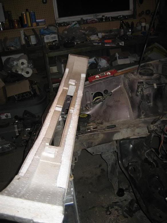

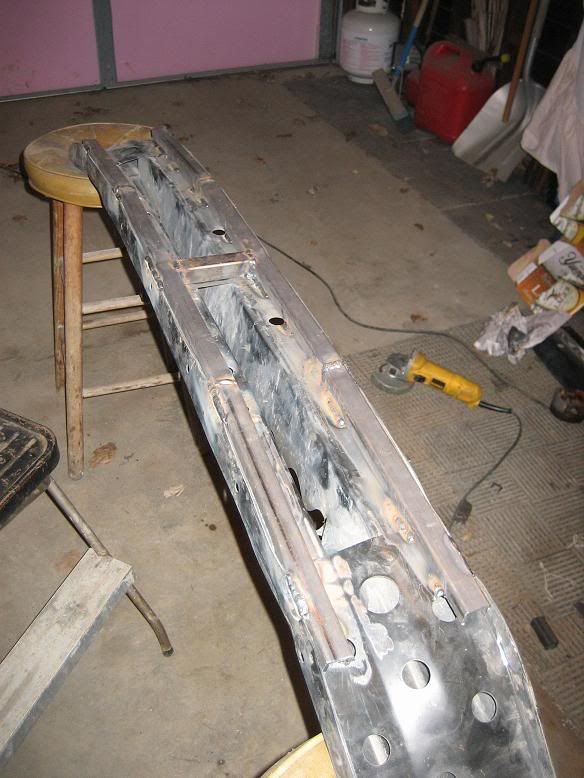

  42. piddster

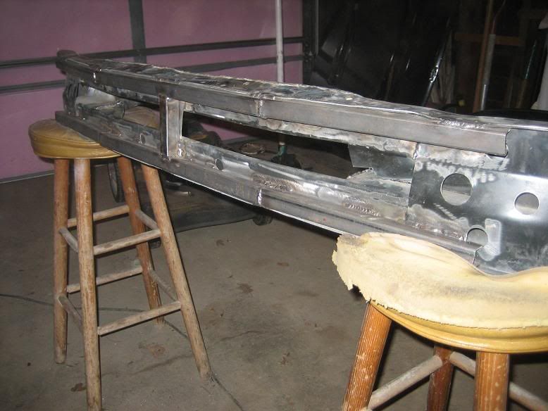

    Finished the bumper beam. And the foam. Like a percuset, and a couple vicodens, very nice. And then the pantys drop.
    Anyways, she's fitting together nicely. The beam still lines up up with the factory holes which is amazing givin the amount of pretension in the bumper beam and how far off it was before I welded it. She sucked back together nicely though. The foam wasn't a big deal either. The good ol Stanley 99 took care of it.
