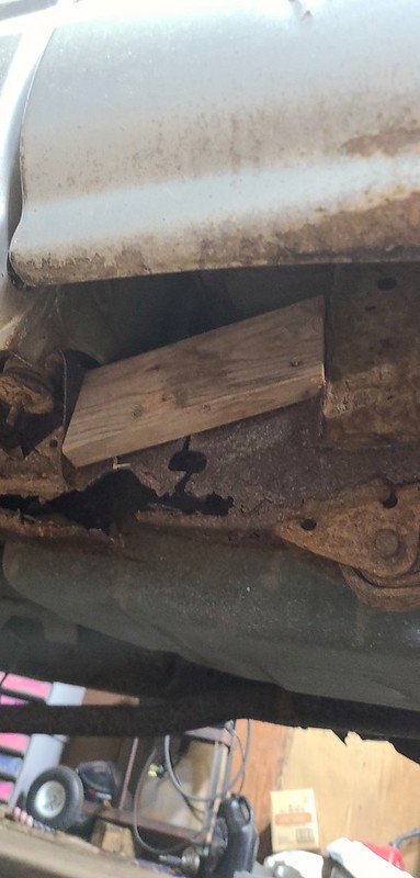

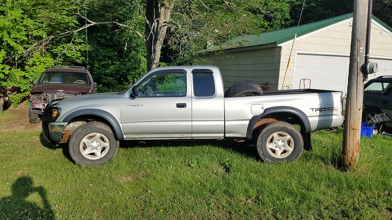

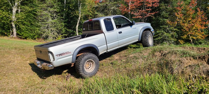

    It's a Tacoma, but it also folds up like a Taco...
    Bought it last summer. You may notice the bed is resting on the cab. Frame is broken, badly.
    [​IMG]2020-07-01_11-29-42 by Numbchux, on Flickr
    BUT, being a 3.4, 5speed, TRD Off Road, it has a 4.10 electric locking rear axle, which will bolt into my 4Runner.
    Plan is, swap axles between the 2. Weld the diff from the 4runner that goes into this. Then patch this thing up enough for a yard truck.
    It's been very low on my list, and I haven't really touched it, except to sell the brush guard and headlights.
    Well, offroad/farm/etc. bachelor party weekend in a week and a half. So I'm going to try to patch this together enough that I can beat the hell out of it for the weekend.

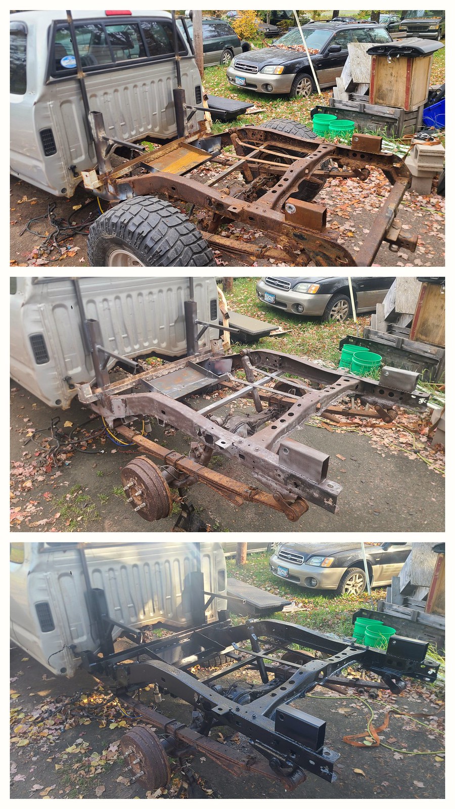

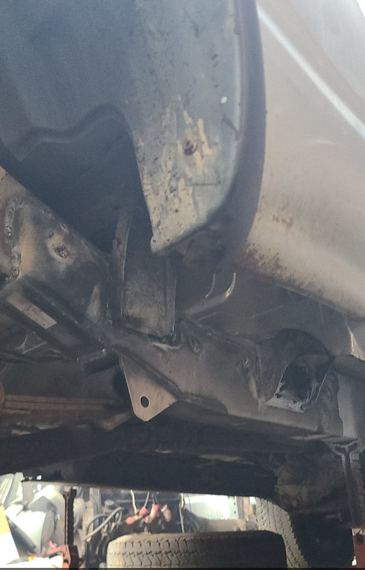

    Frame caps showed up last night, got the RH one welded in:
    [​IMG]Snapchat-1348479405 by Numbchux, on Flickr
    Planning to weld the LH one in tonight. Which leaves me 4 or 5 evenings (I get 2-3 hours in the garage at night after the kids go to bed before I run out of steam) to patch the brake lines, plumb in an inline fuel pump to a marine tank. Wire and mount an LED light bar in place of headlights, swap wheels/tires from the 4runner (and likely cut/pound the bodywork on the Tacoma until they fit), and hopefully free up the locker motor (or, just lock it, and put it back together seized in the locked position). I'm crazy....

  2. Chux
    1,492
    Got the LH side welded in last night. Much more sturdy, still flexes a bit, I'll probably have to do the section under the cab, at least on the LH side. But should be strong enough for a weekend.
    Helping a friend rewire his Saab Sonnet race car tonight so he can leave next week for the Put-in-bay vintage races. But hopefully I can start on fuel/brake lines tomorrow night. And I ordered a pair of 5" LED flood lights on Amazon. I'll mount those in place of the headlights.

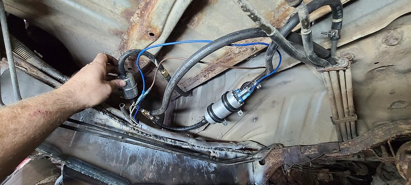

    Fuel system basically plumbed. I plan to use a marine fuel tank in the bed with a quick disconnect so it can easily be removed. These only have a supply line. So, low pressure filter as a pre-filter, A cheap inline pump (fits many '80s Fords...), and some fittings from the plumbing aisle at Menards....
    2021-09-09_08-50-54
    The return T's into the supply line between the filter and pump. This is not ideal, as the only way for air to escape is through the injectors/engine and fuel temperatures are a concern. But being that this won't likely be driven much, I'm not too worried about it. I'm going to bring the cooler that I plan to use as a power steering cooler for the 4Runner along this weekend, just in case, as that could easily be added in the return to help dissipate heat.

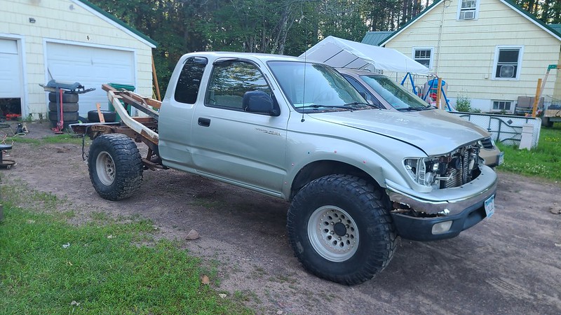

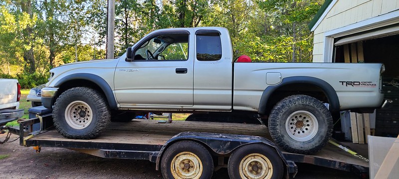

    I did it! I literally drove it out of the garage, and onto the trailer. My son was so kind to help me while I wired in new trailer lights:
    [​IMG]20210911_124816 by Numbchux, on Flickr
    [​IMG]20210911_170502 by Numbchux, on Flickr
    But it worked. Big 33" tires rubbed like crap if I turned more than a little bit, so 3- and 5- point turns were my MO.

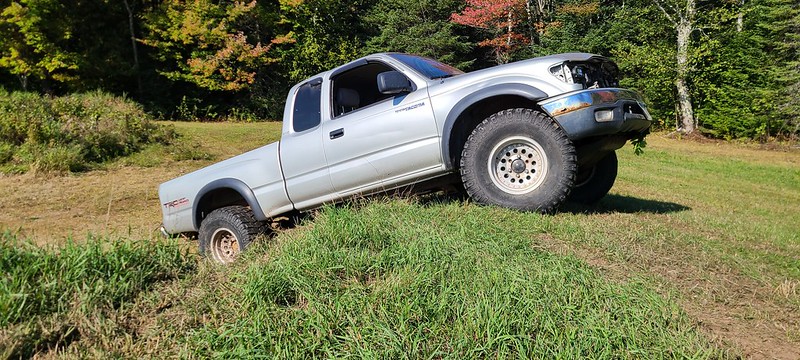

    I did not get any exhaust on it, so I did not go to Gilbert (although, as it turned out, they didn't do any sound check...even on the 2 stroke dirt bikes in the group that were questionable.
    Trails were very dry, so traction wasn't an issue (didn't really notice that the locker wasn't working).
    [​IMG]20210912_101605 by Numbchux, on Flickr
    [​IMG]20210912_101544 by Numbchux, on Flickr
    Now, to yank off the bed, clearance the front fenders, and start modifying it to do some work around here!

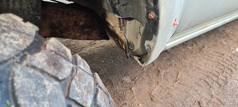

    Home with sick kids, but got a little work done during the day. Yesterday, I applied cutting and bashing tools to regain some steering angle
    [​IMG]2021-09-15_01-21-09 by Numbchux, on Flickr
    And today, I got the chain, and drove out into the woods for some trail maintenance (trail was blocked by a down tree, didn't feel like cutting it up, so I just dragged it out of the way).

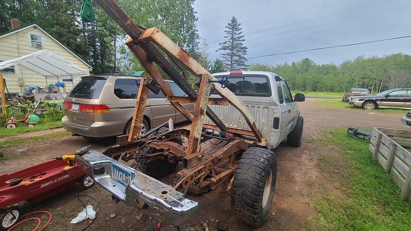

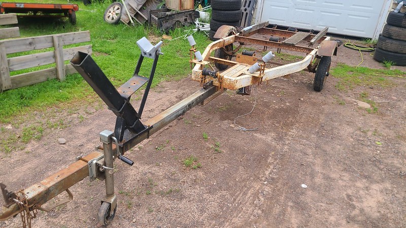

    Sold the bed, and bought a scrap boat trailer.
    20220714_150504

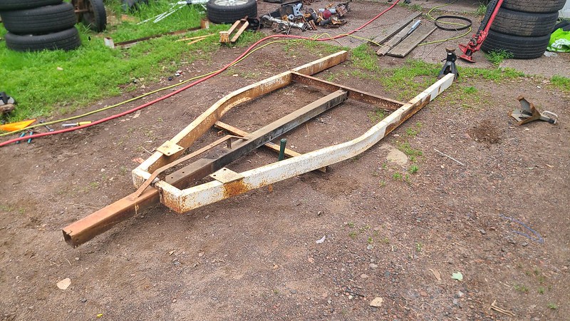

    Removed all the brackets, narrowed it by 4", set the tongue inside the frame.
    20220718_163144

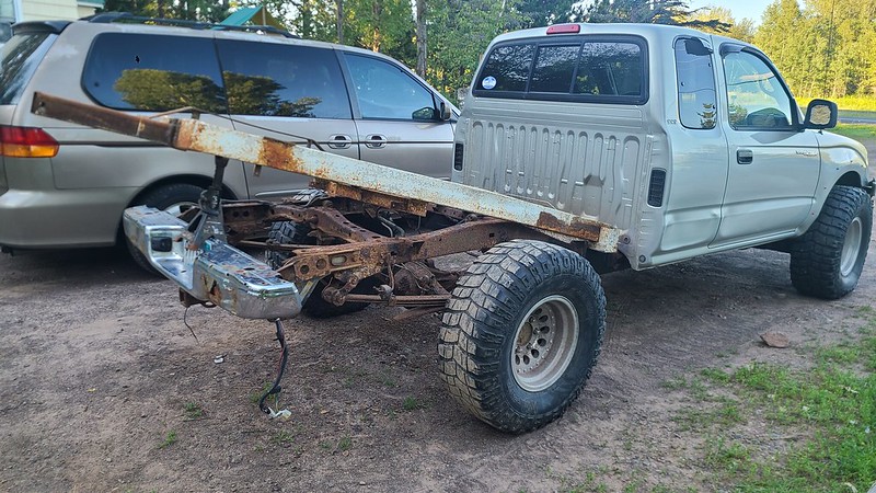

    First mockup on the back of the truck
    20220721_191143
    20220721_191157
    Found out the hard way that Russell Steel closes at 4. Hopefully tomorrow. And then I can build the rear uprights and winch mount. Ordered a Harbor Freight 5000 lb winch. The truck came with a bed toolbox, I'm hoping to build a headache rack and mount the box to that, above the winch and front of the boom.

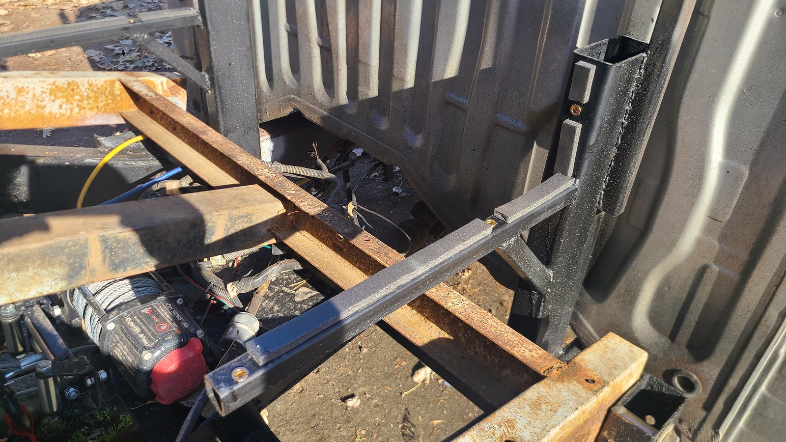

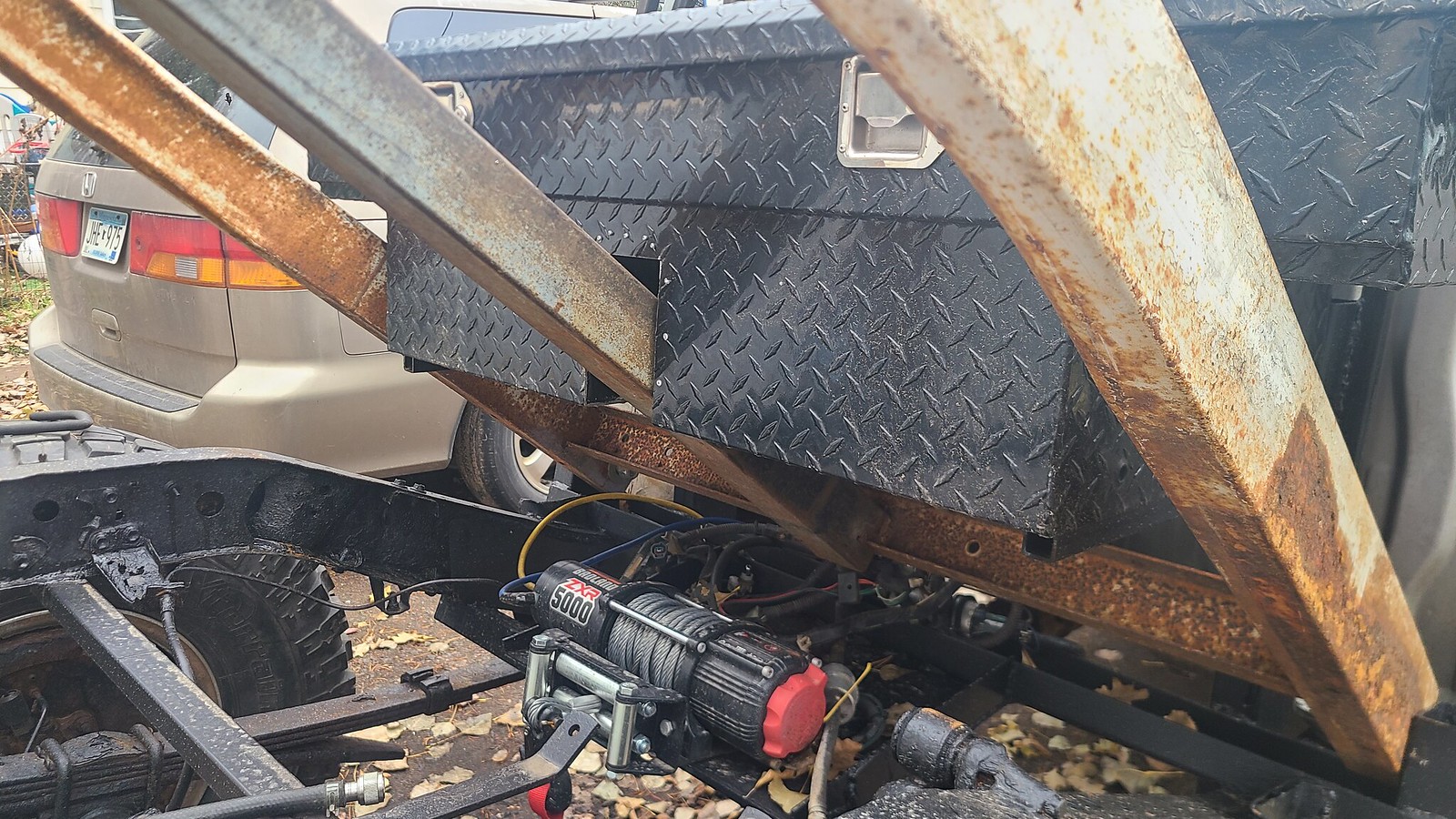

    The truck came with this bed toolbox, which I wanted to mount so I still have some storage onboard (straps, chain, chainsaw, winch controller, etc.)
    2x4 box tube welded to the frame, with 1x1 base sticking forward from it, with a 1x1 gusset. This hangs entirely above the boom, so it can still be removed. I also cut a notch in the bottom of the box for the center section of the boom to recess into it.
    2022-10-05_08-34-47
    Next is to build a headache rack from more 1x1 off that 2x4. The remove the toolbox, winch, gas tank and boom so I can apply a quart of POR15.
    I also have either rebuild the diff lock motor or put a freeze plug in the hole in the rear axle before winter (and probably change the gear oil, as it's been open for 2 months....oops)

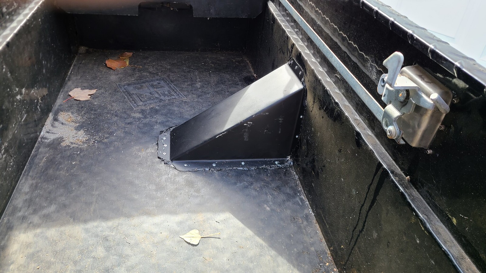

    Making a panel for the notch in the toolbox. My daughter helped me with the cardboard template:
    20221020_155000
    Cut from 20g steel, bent, painted, riveted and glued/sealed in place:
    20221024_134313
    Put the boom back on, and set the toolbox in place:
    20221024_155103
    Plenty of room for chainsaw, straps, tools, etc., and doesn't block the back window.
    Welded up a few pinholes in the axle "cover" (not removable). Began rebuilding the elocker actuator (gutted it and sandblasted the cases). Once that's done I can put gear oil in the axle and see if it still leaks.

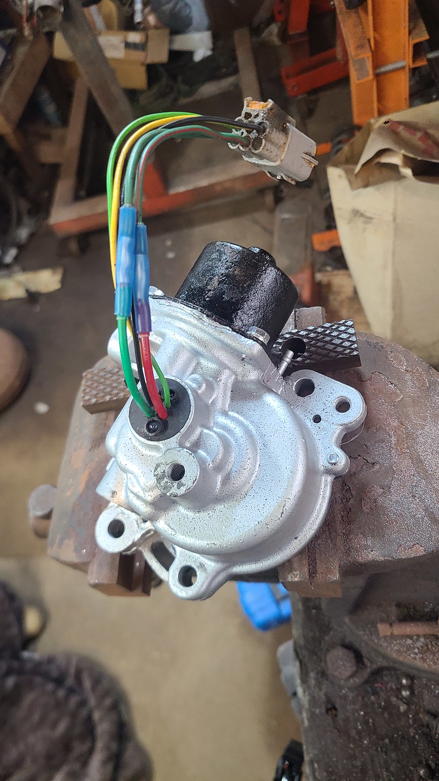

    Elocker actuator rebuilt.
    20221106_160407
    It turns when out of the axle housing, but once installed, it doesn't seem to unlock the diff. Might be indexed wrong (there are internal limit switches in the motor, so if things aren't lined up correctly, it won't travel far enough). But, the diff is locked, and the gear oil stays in the diff, which were my main objectives. So, I'll worry about the rest some other time.

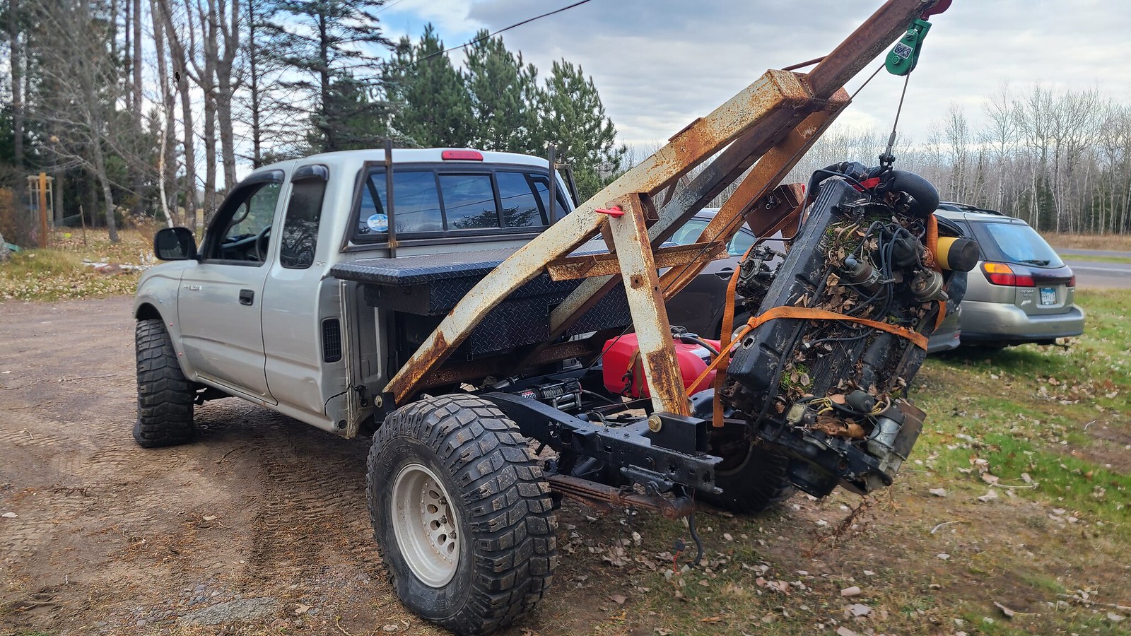

  32. Chux
    1,492
    The truck has been putting in some work this spring cleaning out scrap. Dragged the XT6 onto the trailer before stripping it.
    PXL_20240628_232816938
    Rear suspension needs some serious help. It sags to the bumpstops with very little weight on there. But other than that, it works great.
    Nhibbs and silver03 like this.
