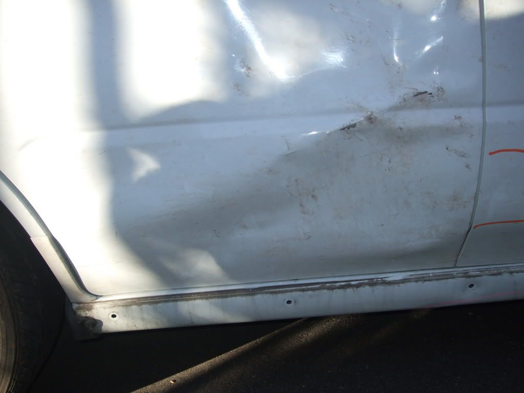

Eww, I think I see some blood on the center console. That teg musta smacked the big bale of hay pretty damn hard - the thing went waay down hill. I agree with the swap too, as usual, but only if the motor is still good enough to swap. Otherwise there'd be no reason to. Did they tell you details on the under-the-hood stuff? If the motor/tranny is good, a full drivetrain + interior swap could make a white GF wagon extremely sweet. But it'd be A LOT of work for sure, as in project car status for months.

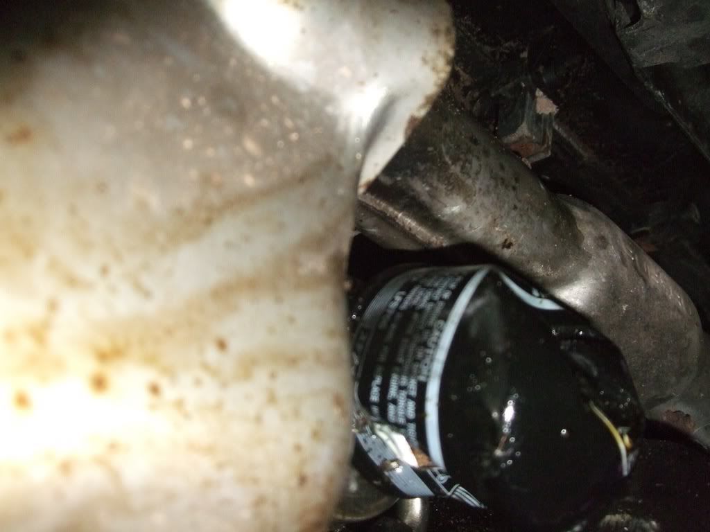

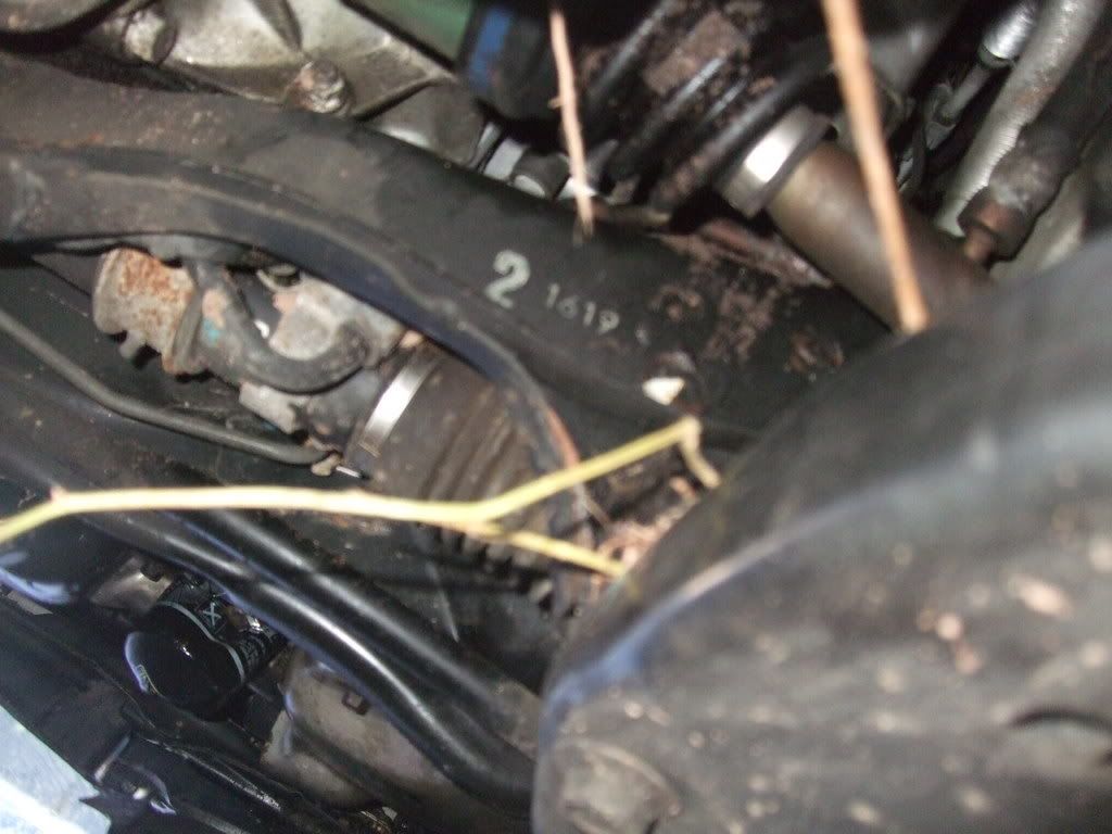

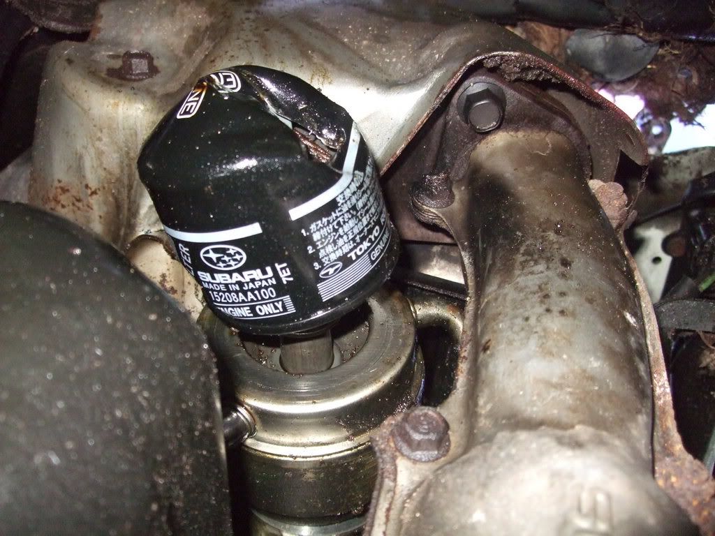

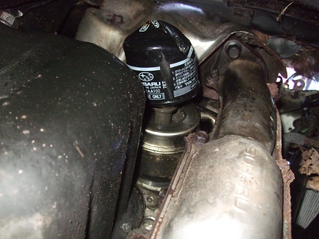

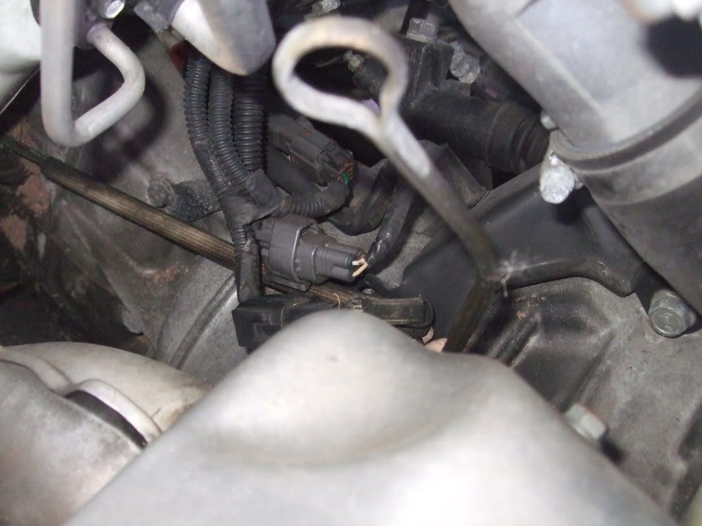

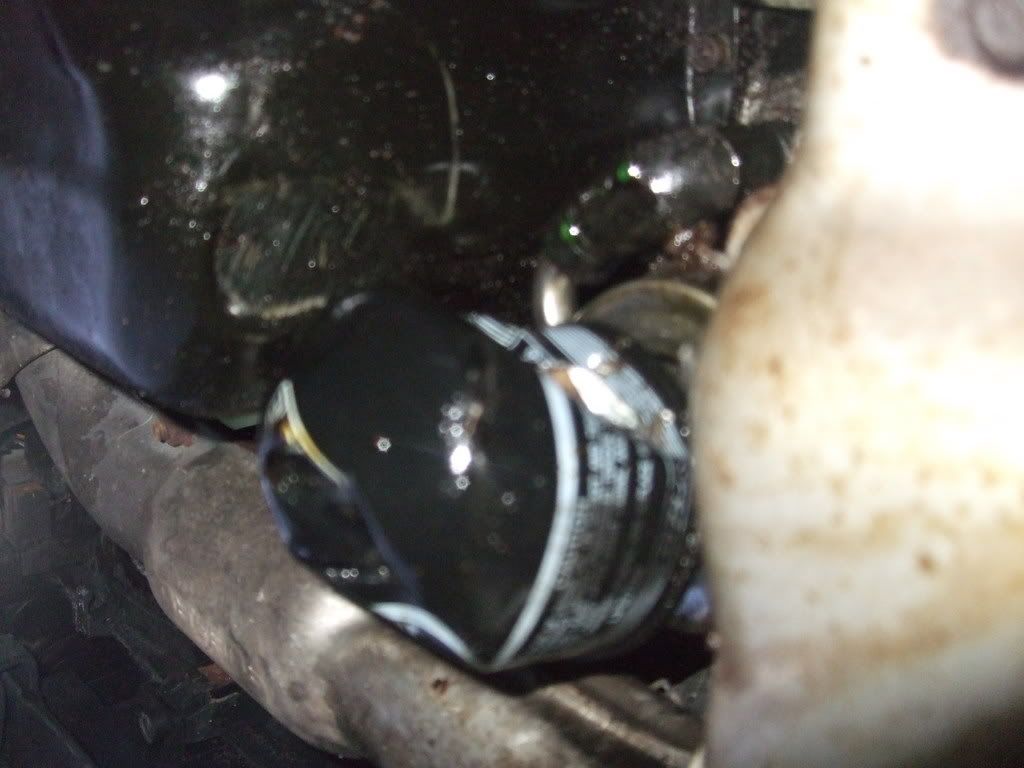

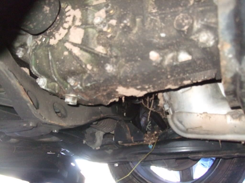

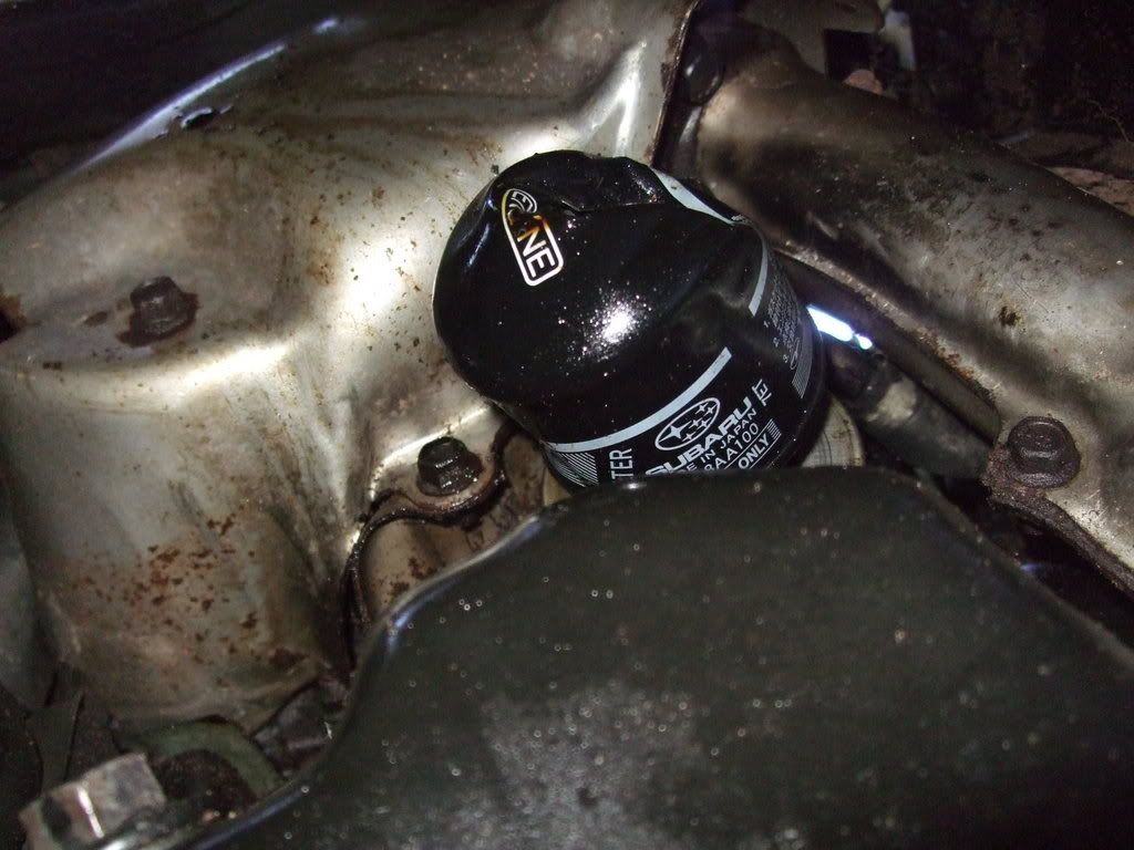

Under the Car and hood: I couldn't really get the best pictures so you can't really tell if there's much wrong, but the oil filter and pan is still there.
From what I can see in those pics, the oil pan looks ok. Looks like your oil spill came from that filter - it looks like something caught it and ripped a hole in it, also ripping it off the oil cooler a bit. Hopefully only the oil filter itself is mangled and the cooler is still salvageable, but not sure. Tranny drain plug is still there too. Maybe the tranny fluid came pouring out the tranny dipstick hole up top when the car rolled? From the looks of it, that drivetrain is still very salvageable, so long as the fire didn't damage too much of the plastic stuff up top, and hopefully your timing belt didn't skip any teeth or anything from the impact.
I think the part of the sign in the ground punctured the oil filter. The tranny fluid came out from the dip stick falling out when the car tipped.

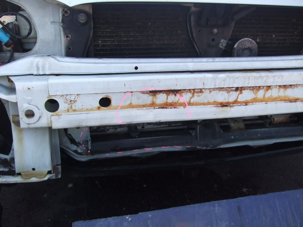

Thank you but the body really doesn't bug me right now , all I want to know is if the frame is okay, and somehow get a good look at where the fire was and what is damaged there. I will find out once they fax all the information to us.

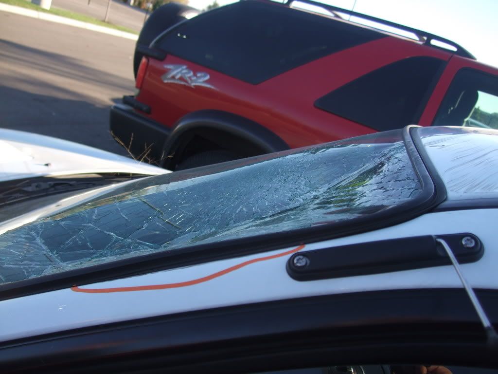

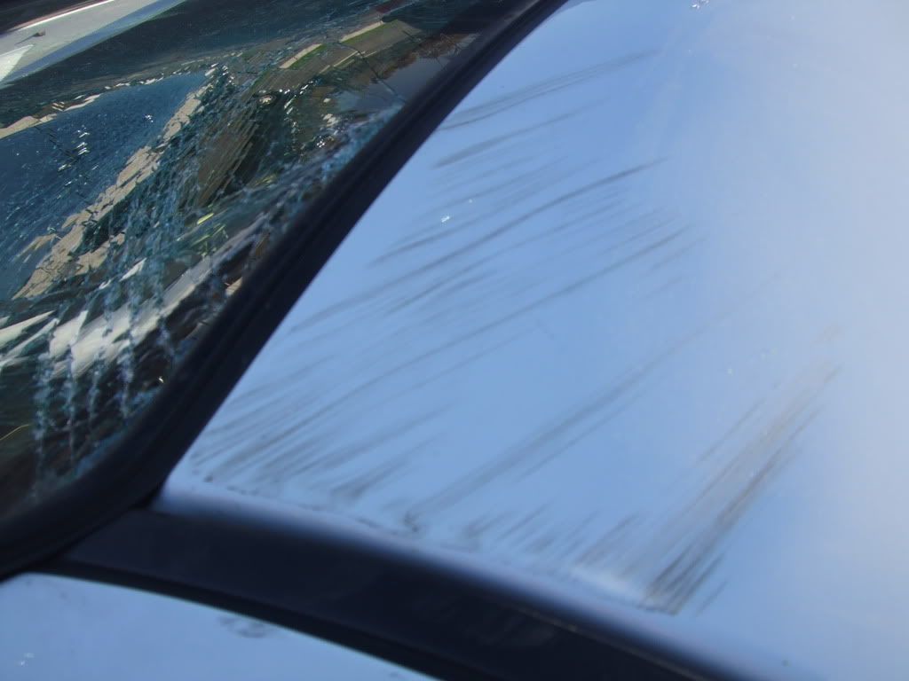

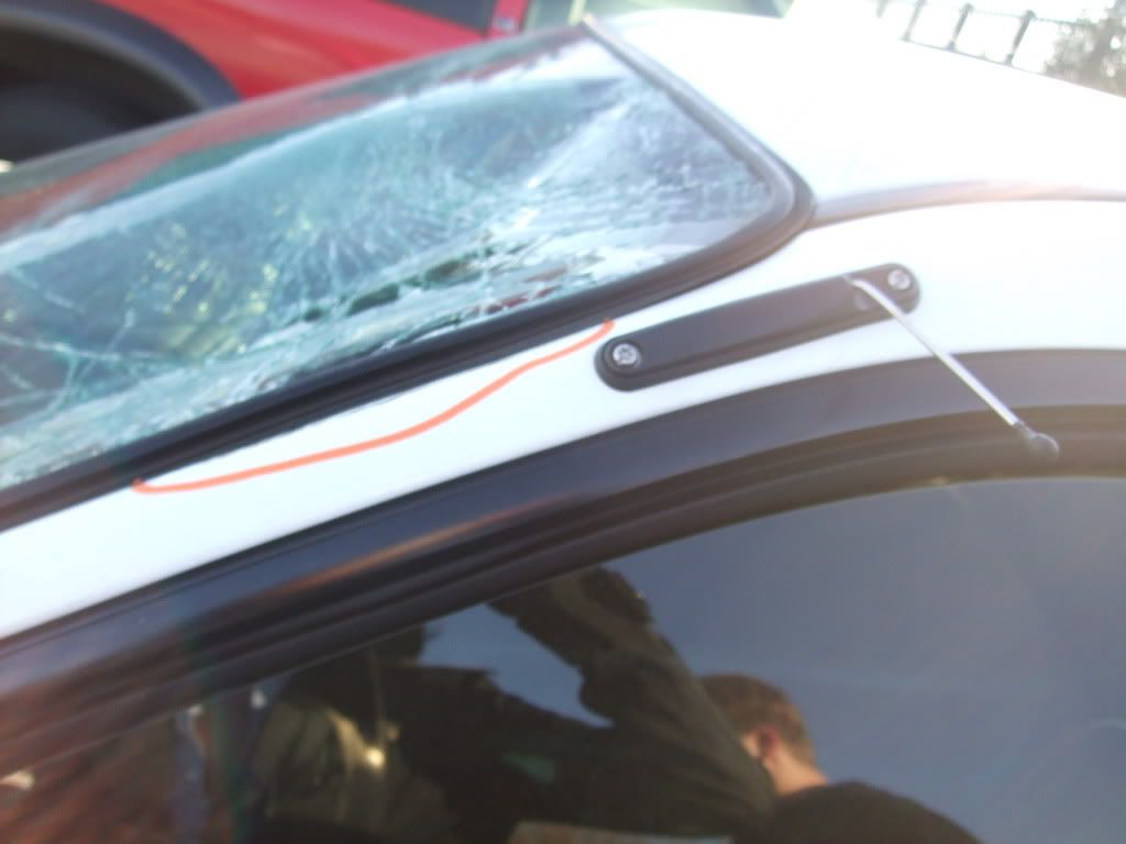

yeah, like i have said before, it looks like it would come down to the roof supported areas and A pillar

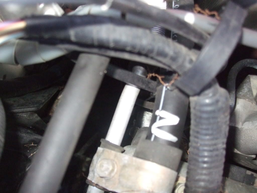

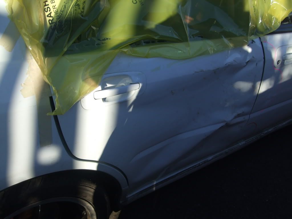

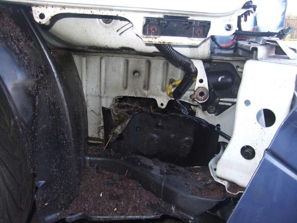

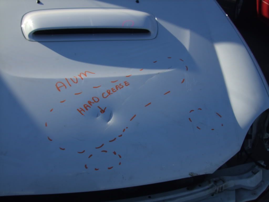

I took a look at the car and I could no see any place on the top of the engine that was hurt by a fire. I tried my hardest to find something and without taking things apart I'd say its fine. Also the body doesn't look too bad in person. There is alot of damage but it looks like all damage that can be fixed with replacing panels. Sorry for your loss Bee but just five me a call and I'll get that thing rollin for ya!

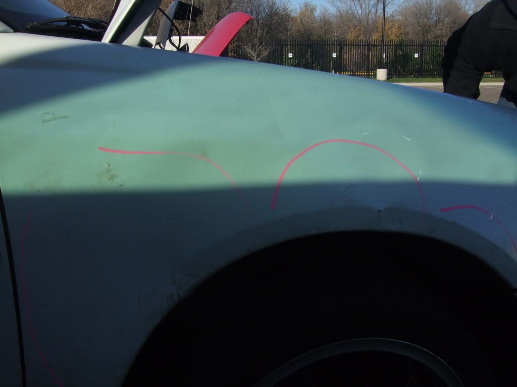

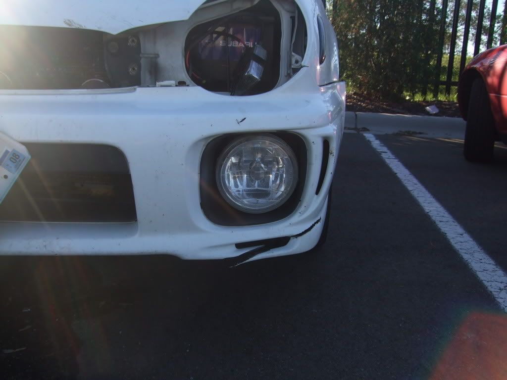

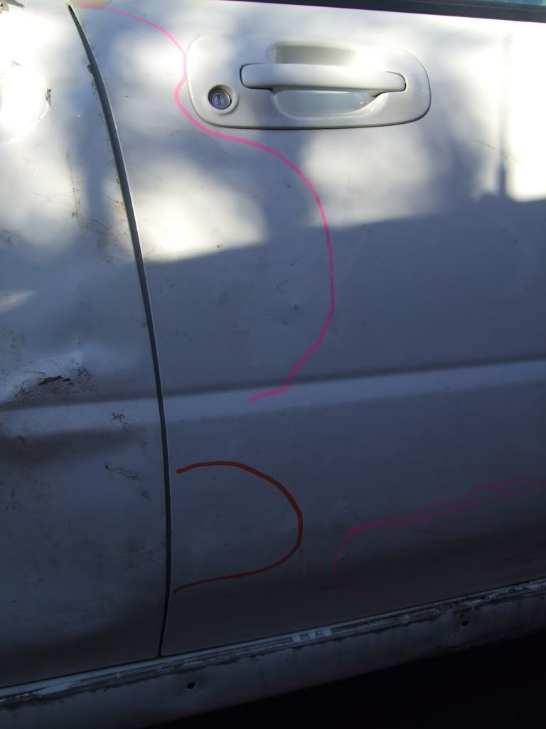

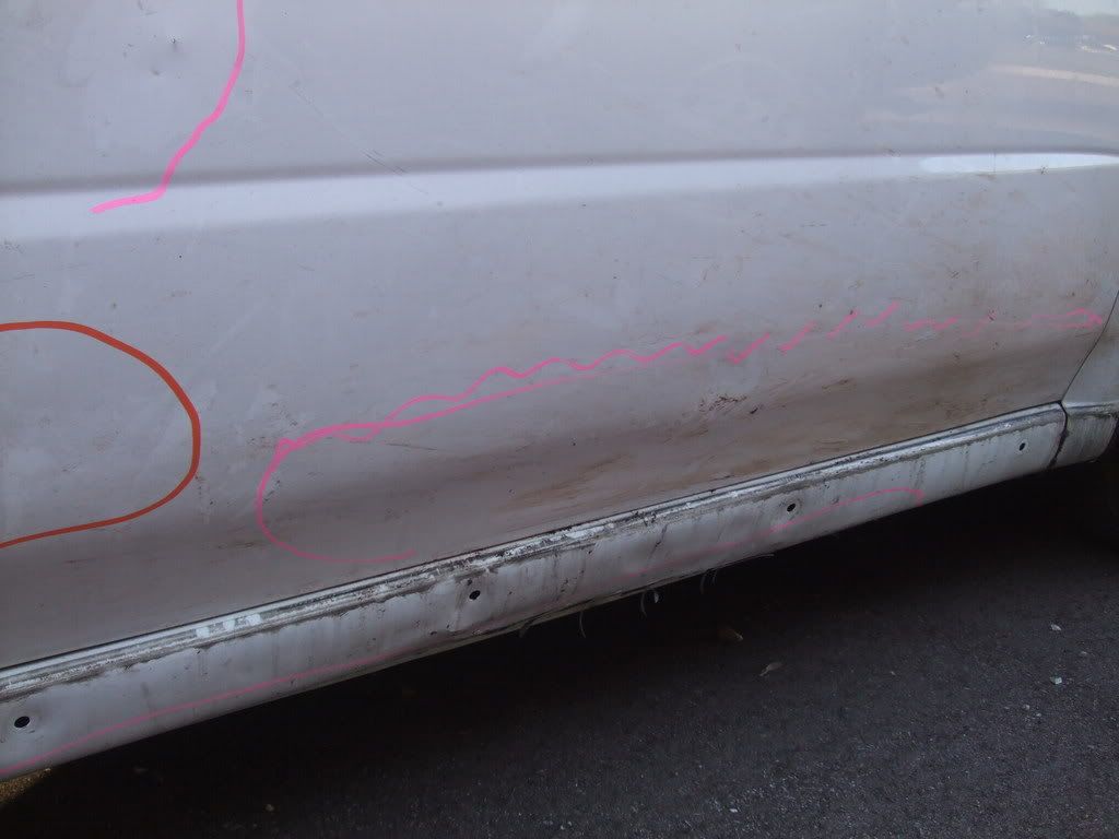

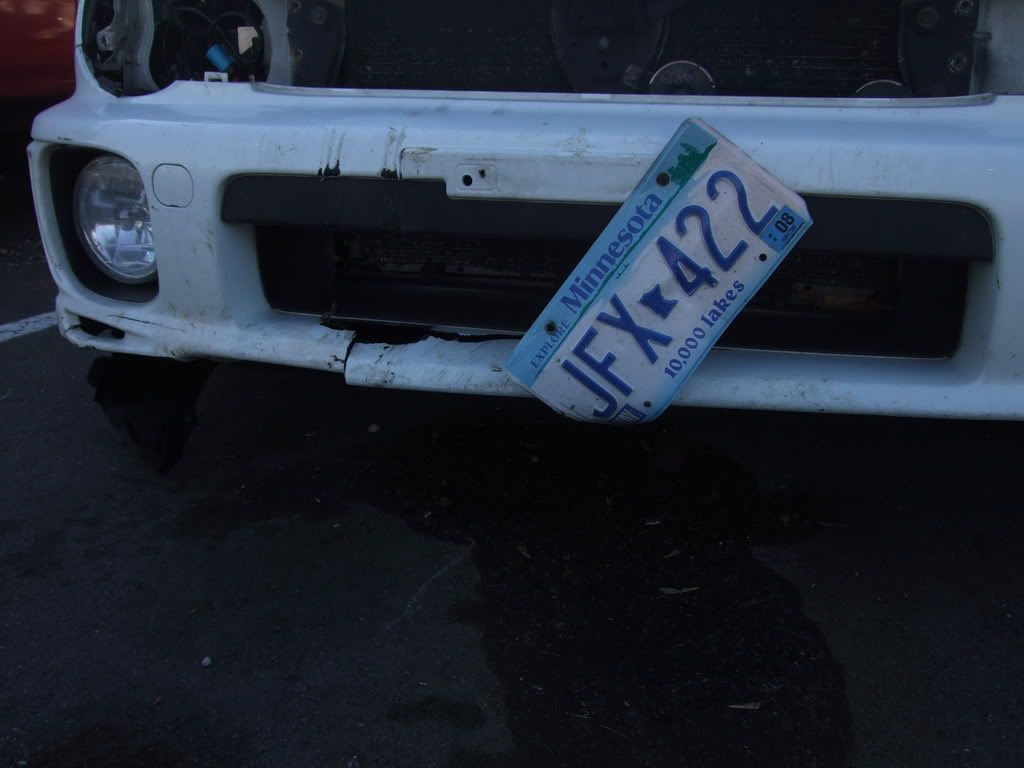

I got the estimates on everything and what they would have to fix... Bumpers Hood and Hood Scoop Right fender panel Sub Frame Steering return pipe Steering pressure pipe Engine oil pan Windshield Right and left Rocker moulding Antenna L florr support Right rear door Roof Drip moulding L rear combination lamp assembly Along with paint engine flush, oil change/filter, alighnment all that stuff... Everything is about 4,000. Labor is 5,000. I'm not buying it back.
