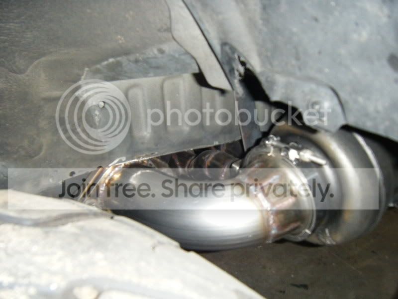

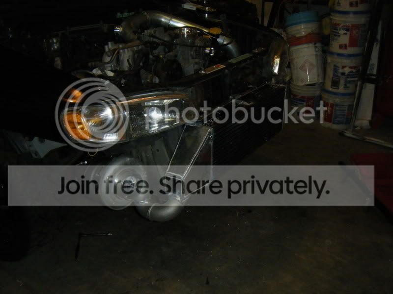

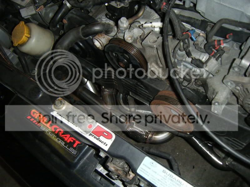

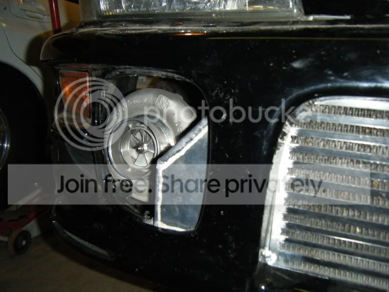

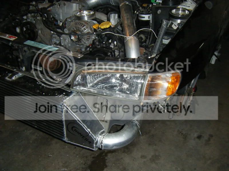

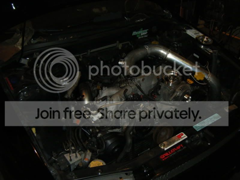

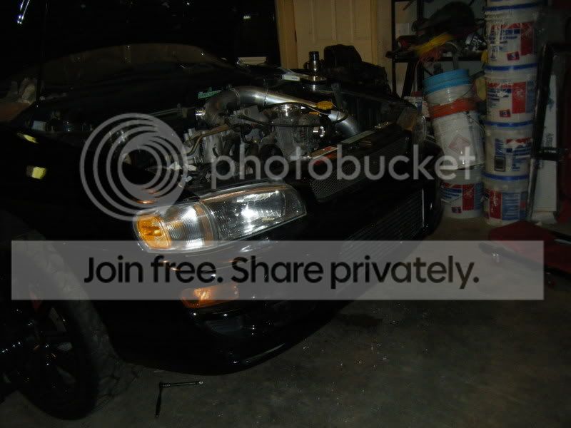

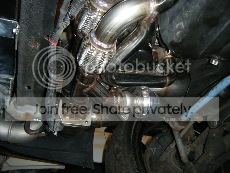

    kind of dark and crappy pics but deal with it:

    someone let the 4yr old loose with the glue again huh :laugh:
    looks good

  30. RichWRX
    RichWRX Well-Known Member
    thats some big piping for your radiator
  31. fobiawrx
    fobiawrx Fabiola
    extra cool!

  34. SubieDave
    SubieDave Well-Known Member
    Why did you decide against the reverse intake manifold?
  35. fobiawrx
    fobiawrx Fabiola
    no room for it
  36. Iroc-Z
    Iroc-Z Well-Known Member
    I was talking about the electric pump not the tank.
  37. dipp
    dipp Well-Known Member
    25
    when you swap an EJ into a GC body you loose 10 CM distance in the front of the motor that plus the koyo radiatior there was not enough room to fit 3 INCH intercooler piping in there im not to concerned its only another ft of pipe
