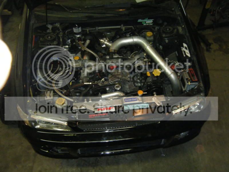

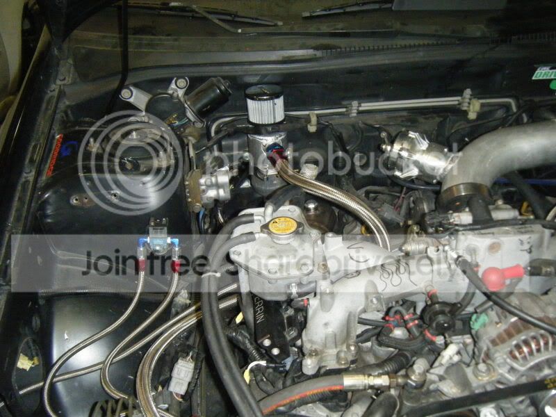

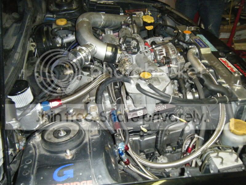

    Well should have some updates tonight, will get some new pics up hopefully to. Got the intake mani on injectors in fuel rails on. Pulleys in radiator in.

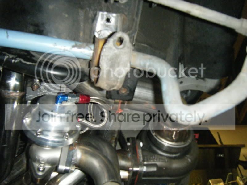

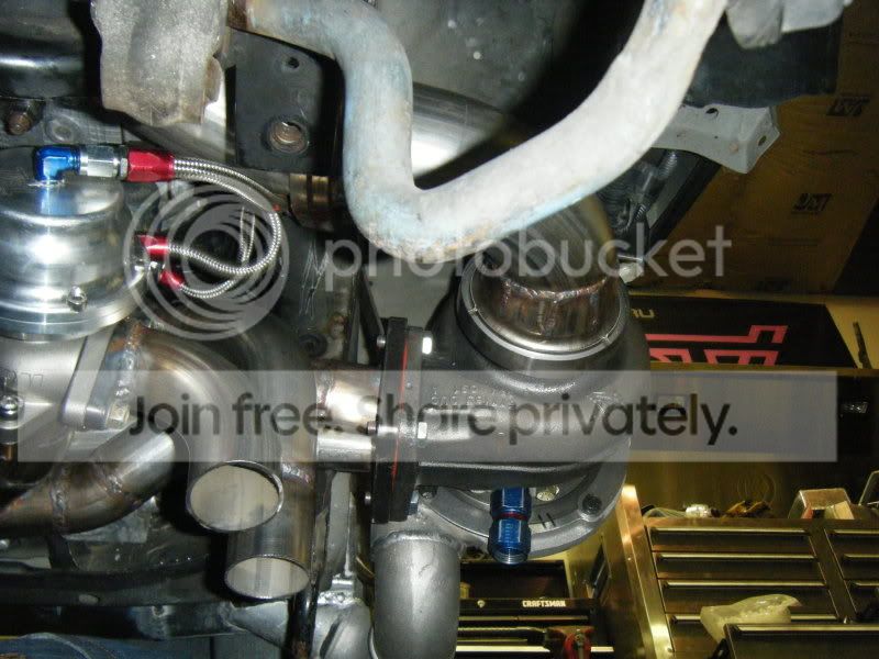

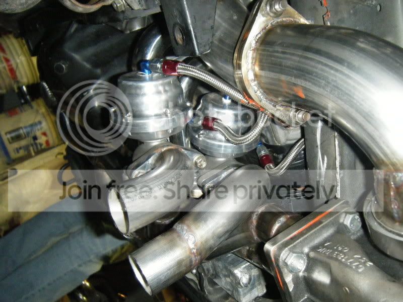

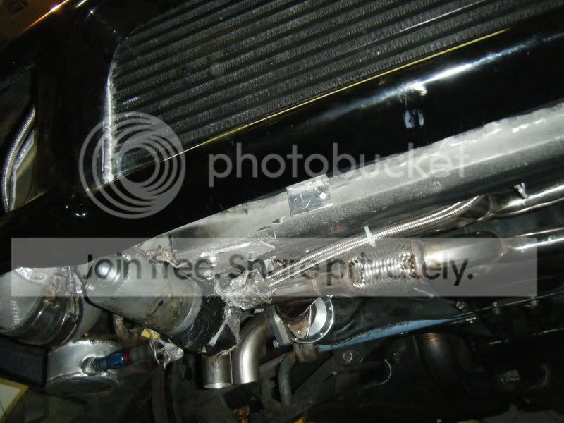

    sorry im not as knowledgeable on some of this,.. Whats the purpose of 2 wastegates? Is it because of pressure? Thanks
  12. Jackstand
    Jackstand Well-Known Member
    Twin scroll dave... One for each half of the hotside if im not mistaken
  13. TSTRBOY2004
    put your sway bar bolts back in....
  14. piddster
    A twin-scroll setup works optimally with two separate wastegates. You want to keep the exhaust pules as separated as possible.
  15. Jackstand
    didnt i just say that:rolleyes:
  16. fobiawrx
    fobiawrx Fabiola
    There is 2 manifolds in a twin scroll setup. you are separating the pulse's between each cylinder to the turbo. If you run one waste gate that is combining each side of the block together you are congesting both pulses and combining them to have no benefit. What's the point???

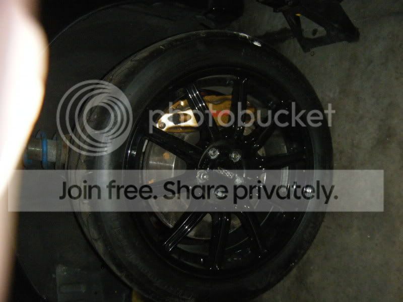

  33. piddster
    'Bout time you got some man sized brakes.
