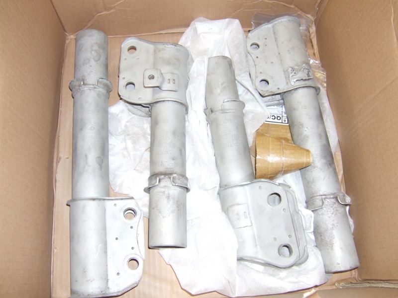

    This all started last year when Jeff did his first ever alignment on the car and we found out that one of the front dampers was blown. I ordered up a fresh pair of fronts with the intention of swapping them into what was already on the car, but then it all started to spiral out of control and I wound up acquiring the parts to build up a set of what are essentially custom coilovers.

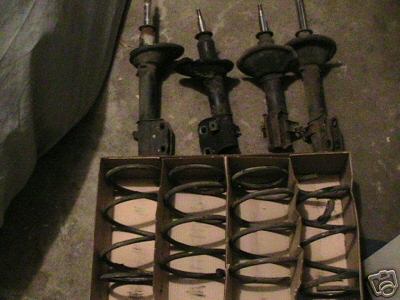

    The old parts that came off were Koni Sport strut inserts in chopped up stock strut bodies, wrapped in Eibach Pro Kit Springs, and topped with Grp N Strut Tops.

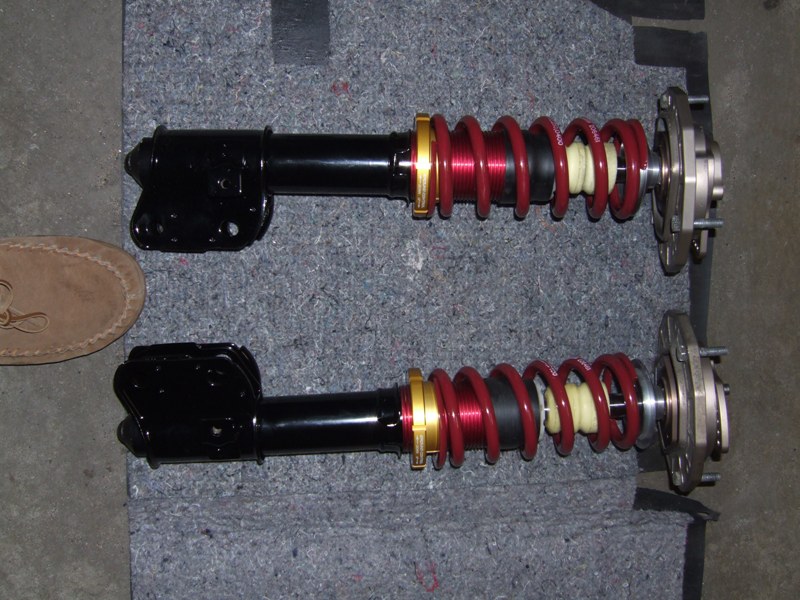

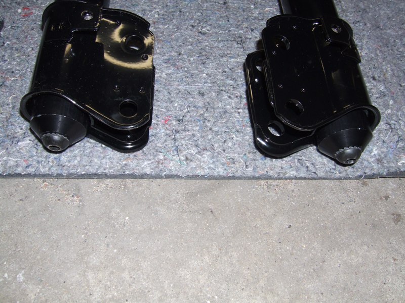

    The new stuff is still a set of chopped up stock strut bodies filled with fresh Koni Sport Inserts, but this time they're wrapped in a Ground Control Coilover kit, and the fronts have PDE camber plates, while I stuck with Grp N Strut Tops in the rear. The fronts also have the D_REX spacer that TiC finally got around to making earlier this year. Dustin's original run of them was long gone, which made them rarer than hen's teeth.
    Original picture of strut bodies on Ebay:

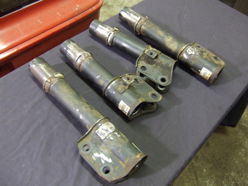

    After they were cut up and ground down:

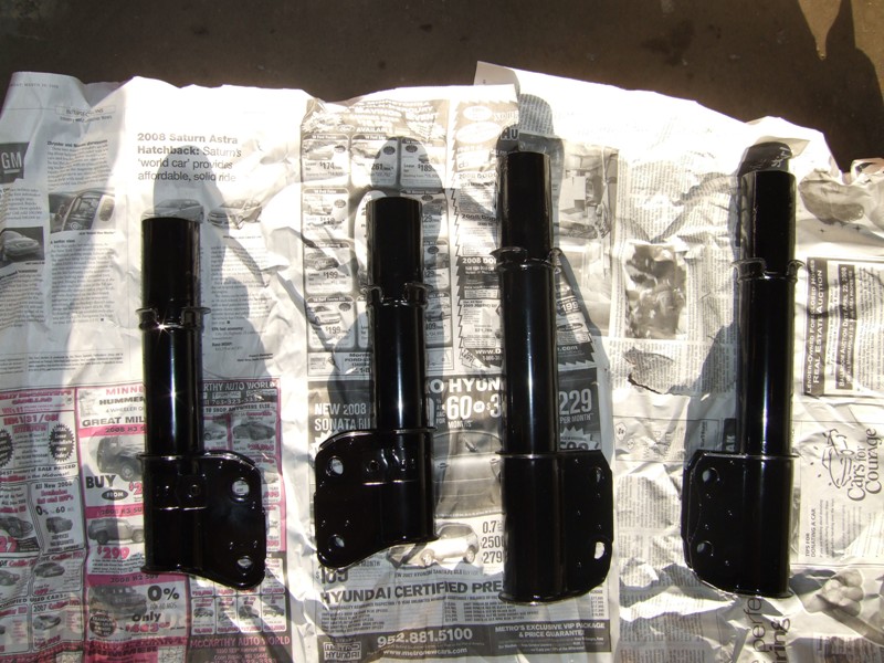

    After blasting:
    After powdercoating:
    Fronts after assembly:

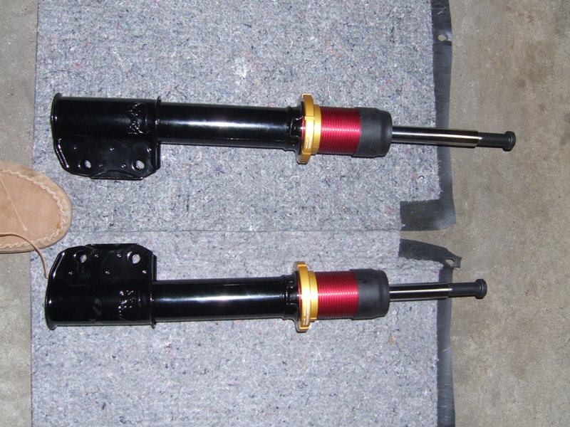

    Rears:
    Sorry the pictures of the rears don't show them completely assembled, but the rear bump stops and strut tops didn't show up until the morning of the installation day. Yeah, that's how close I was to having to run the old setup at Valley Fair this last weekend.

    I think it's the powdercoating that makes all the difference. The ones I took off don't look nearly as pretty.

    Pardon my ignorance - what is the role of the spacer on the bottom? Further lowering?

    The spacer provides an extra inch of suspension travel by dropping the insert down a bit further than it would normally go. I'll try and post up the NASIOC link later that fills in all the details on those little gems. The bump stops were also chopped in half, just to be sure.

  22. hella_sti
    hella_sti Well-Known Member
    where did you get the giant shrink wrap for the upper threaded sleeve? Thats a damn good idea to keep them from rubbing.
  23. stoooo
    stoooo Well-Known Member
    They're actually pretty stiff rubber sleeves that come with the Konis. It helps to keep the water out, as there's a slight gap between the strut body and the insert. In the pictures here, the rim of them is still sitting on top of the insert, but I saw some other pictures online that showed it butting up against the underside of the insert's lip. That made more sense, so I pulled them down a little bit. It's actually hard work getting them to stretch over the top of the coilover sleeves, as they're made to fit just over the stock strut body.
    Does anybody *know* what the little white plastic disk is that goes on over the top of the inserts ? You can just see it under the bumpstops in a couple of the pictures.
    Stuart.

  25. idget
    Yeah, it's just a bushing to keep the bumpstop from getting suction-cupped to the strut.

    Hmm, that make sense. We thought it might be to help channel water away from the piston.
