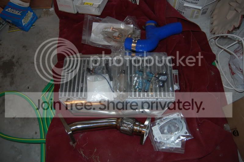

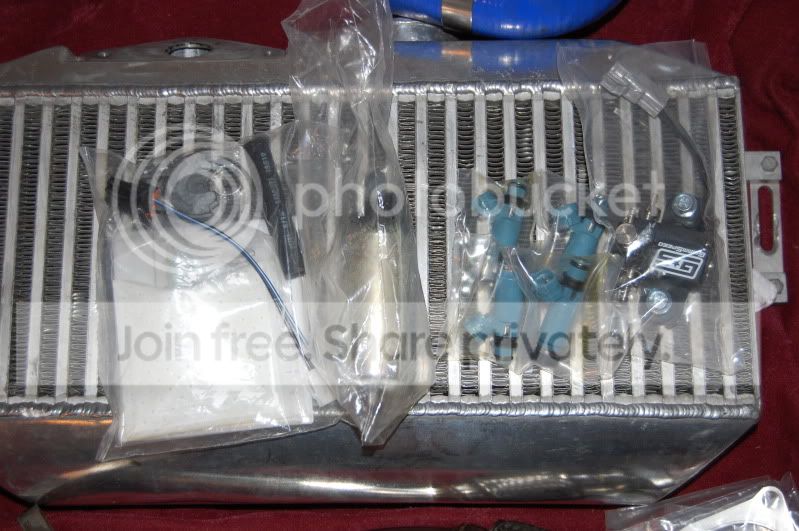

    Getting these parts installed on Sunday and Tuned for them on Monday.
    PnP'd TD05 18g 7cm
    TurboXS TMIC
    GS BCS
    GS Up-Pipe
    DW 750cc Injectors
    Walboro 255
    Current Mods-
    Full Turbo Back
    APS 70mm Intake
    Stage 2 tune
    I will update this thread Monday with my results!
