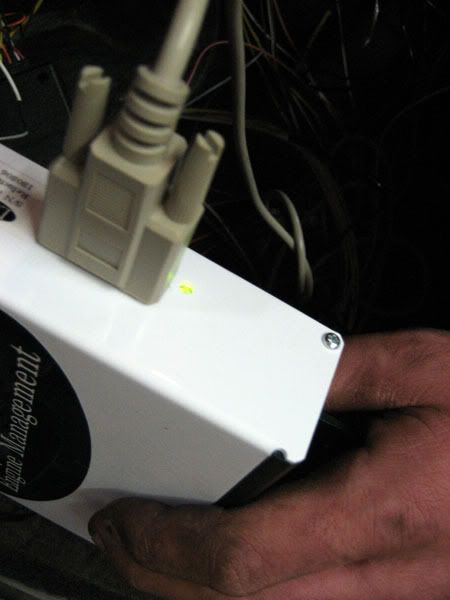

    Hey look. I see a pic of my hand doing some stripping!!!
    anyway, I got a couple of my own pics.
    shortly after the little gas incident:
    And the wiring fun!!
    which actually went quite well!

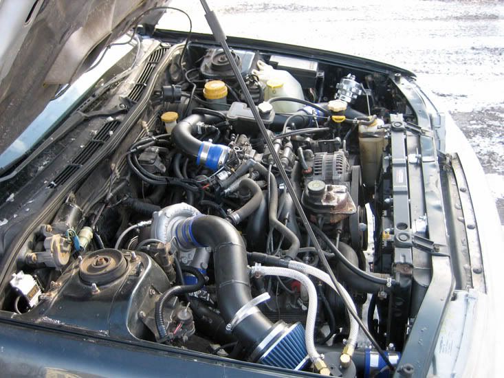

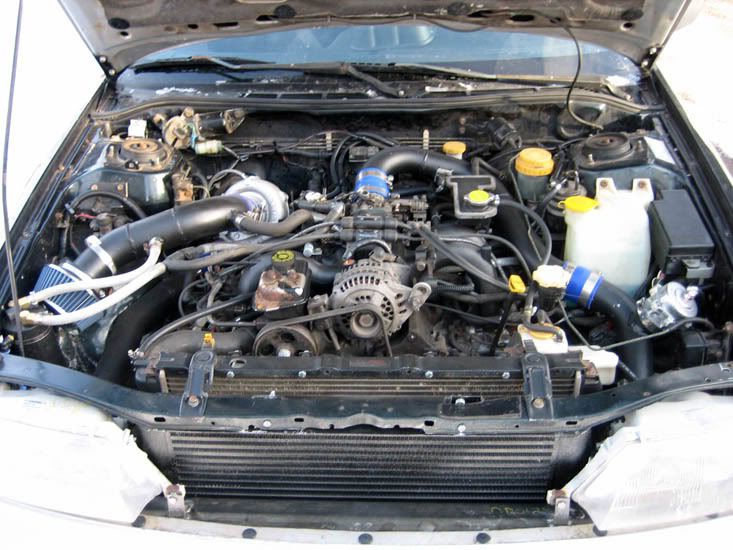

    Well, been chugging along as much as I can. I won't be able to drive it home for christmas, but for shure the ice race. Most of the wiring is figured out, just a few loose ends to figure out. Inlet plumbing is done, aside from a nipple welded on for the pcv. I just couldn't resist painting it :biggrin:
    Other stuff too, but I dodn't feel like typing a whole lot right now, so I'll let the pics do the talking.
    I put the MAP sensor behind the strut tower, and chux masseged a hardline to go right up near the sourceon the throttle body. I put larger bungs in that cheap catch can since the holes inside were only about 1/8". Miller Hill Subaru got me the a slave cyl for a NA car, so more waiting for one :roll:

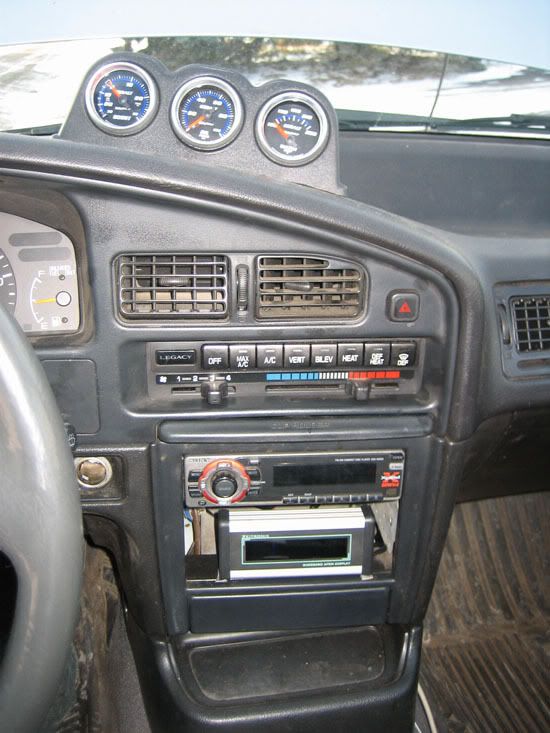

    Well, it runs. It sounds pretty nice, I think. I've got a lash adjuster that likes to go flat once and a while, so I get a tick every so often, then it goes away. Its also rich as hell right now, but I've been playing with it and have gotten most of the off-boost area in or near the 14's. I'm surprised how well the turbo comes on, although its short lived. I'm keeping it under 4-4500rpm for quite a while. I'm running off the wastegate actuator which is supposed to be 9psi, and I'm seeing 7-7.5 in the manifold, so that seems about right. It feels nice though:biggrin:
    There's still alot to do though, besides the body, hehe. I need regular hood pins because the locking ones don't have enough room. I'm gonna go back and redo some hoses and routing of wires. I've got a pile of interior trim to put in yet, and I need make a bezel for the zeitronix display. And the list goes on.

    I might need to redo my up/downpipes and turbo outlet. A couple people have told me I'll end up blowing a rear seal on my turbo if I leave it cocked like that for too long. People with plenty of experience with these garretts. Apparently, quite a few of the perrin kits have blown real seals due to the angle of the turbo. f@ck sh!t gad dammit.
    I could do it in a weekend, or maybe in a long day, with the right equipement availible (fobia);)
    arrrrrrrrrrrrrrrrrrrrrrrg

    Reworked the pipe set yesterday. PITA
  25. StatGSR
    StatGSR Well-Known Member
    1,191
    Duluth/Lutsen
    good stuff, still looks a little tipped back but nothing like before.
