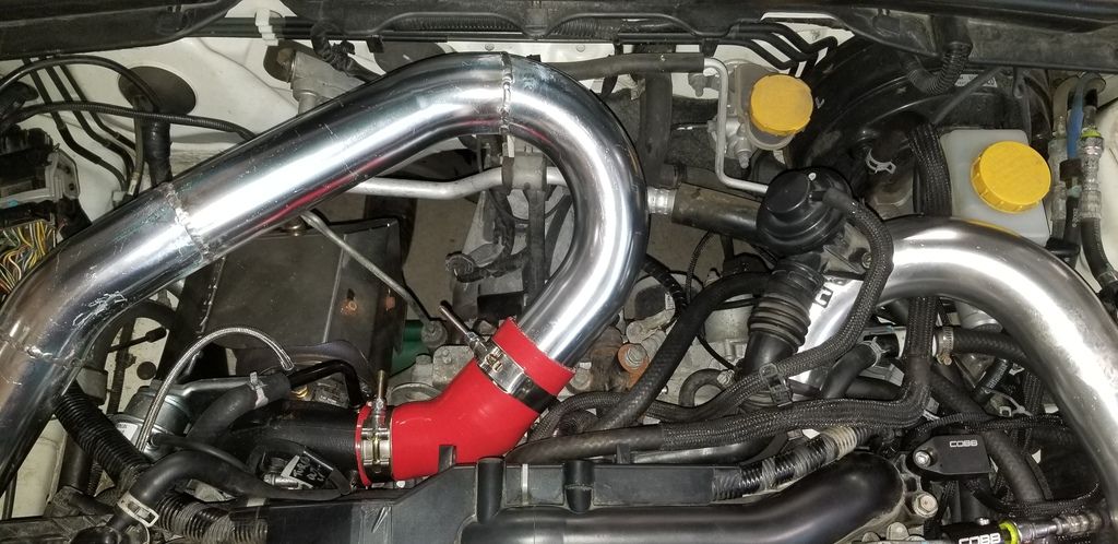

    [​IMG] [​IMG][/URL][/IMG]Well it's all together and running on the "base tune". I did a boost leak test as prescribed in the pre tune checklist and found the throttle body to intercooler pipe oem design sucks. It will slip off under any sort of pressure. Who retro fits a bad connection with a slip on little rubber sock? Subaru I guess! Anyway, I bought a mishimoto boot and works well. Had to change the angle of the intercooler piping out of the turbo. It had an immediate 90 degree turn or slightly more! (Pictured at the top) I changed it to a 45 and more piping had to be heliarced since it is aluminum tubing!(pictured at the bottom) My guy did an awesome job with it and I am ready to go barring any SNAFUs! By the way, I went with Cobb's flex fuel setup, too. Can't wait![​IMG][​IMG][/URL][/IMG]http://i803.photobucket.com/albums/yy311/chriswelckle/20180926_195431.jpg[​IMG]
