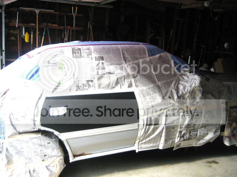

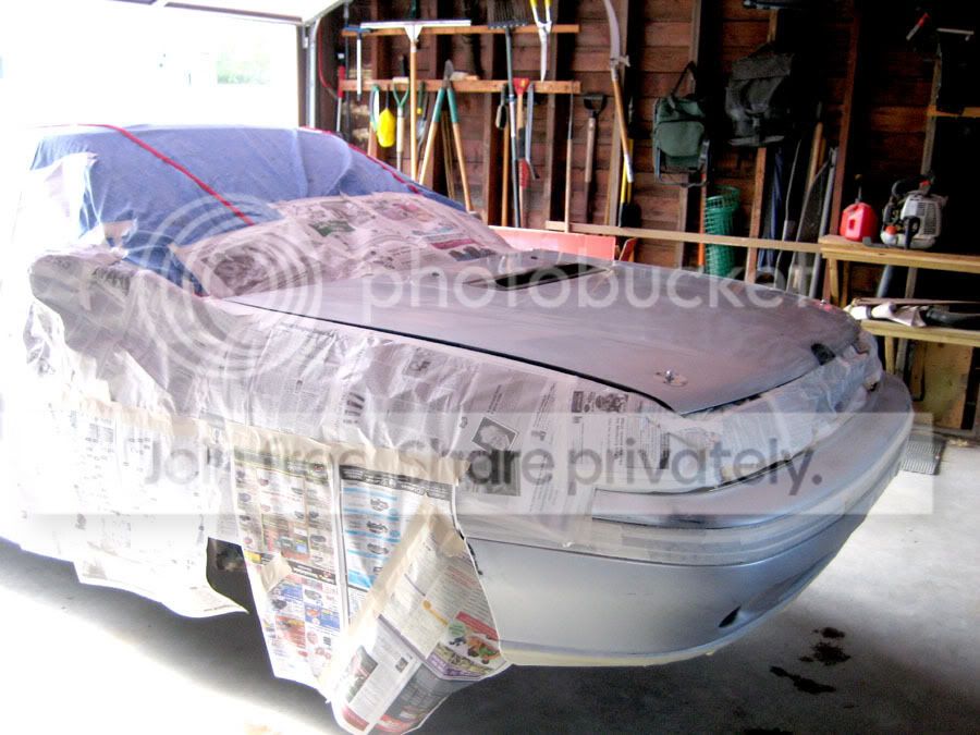

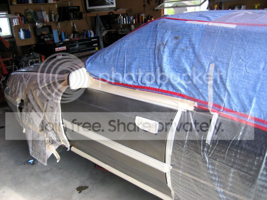

    I just need to do some final cleaning, then spray away. Gloss black Rustoleum which will probably be buffed. Hit the panels with 800 dry and the bumper cover with a gray Scotchbrite. I'll be using a cheap siphon feed gun which I've had laying around for years.

    I'm just spraying the silver parts and the one door I sprayed with semi flat. I'm just trying to get a little less attention.

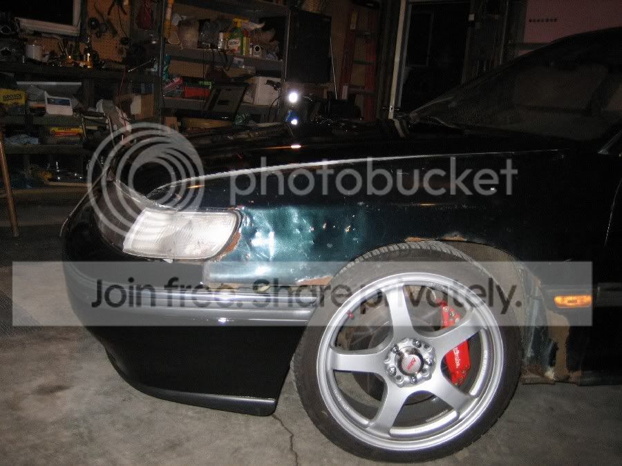

    Tomorrow I might work on getting the new fenders on, which will be quite the adventure in drilling and tapping.:mad:

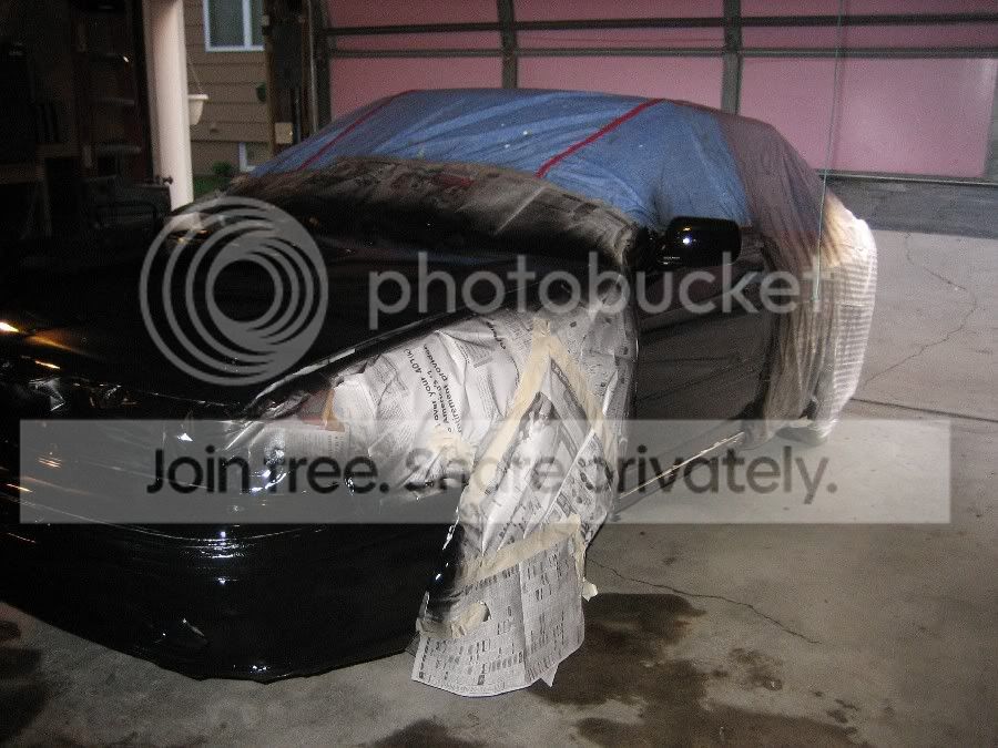

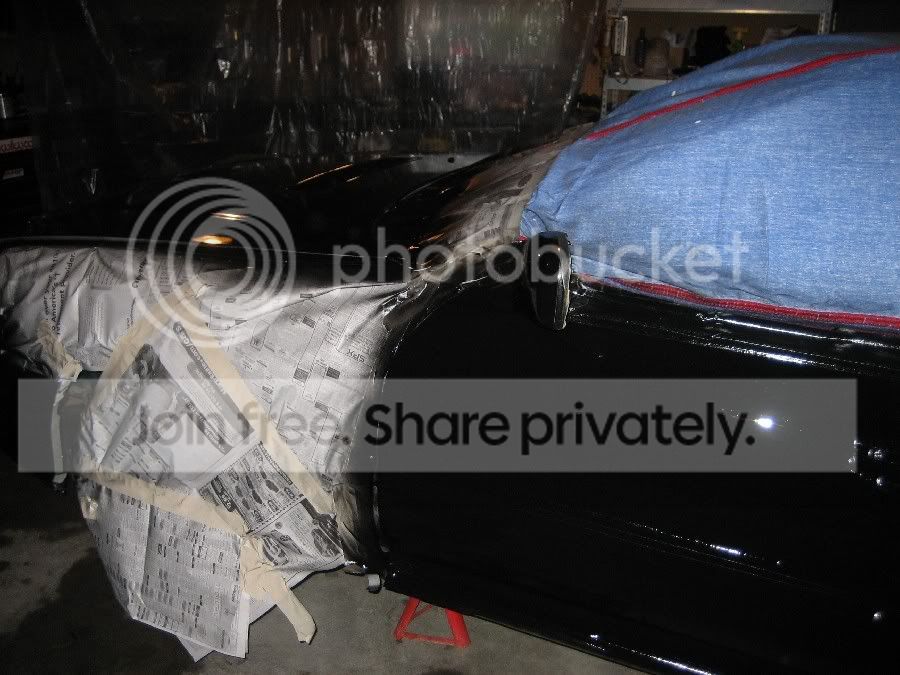

    I just got done spraying it. It came out kinda heavy at first so I had to stop and thin the paint some more. All in all, its not bad for cheap paint and a $40 gun. When it flashes in two hours I'll pull the masking and snap some pics.

    No, putting on the fenders will be a day's project. Maybe starting tomorrow. I have to drill out half of the bolt holes, and re-tap them.
  18. piddster

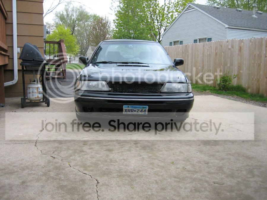

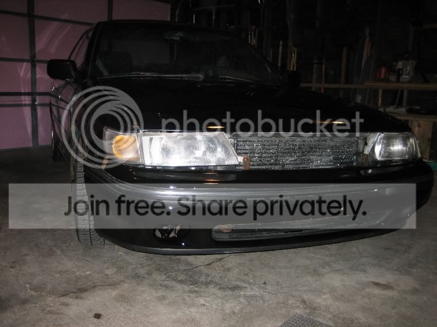

    It turned out ok. This stuff takes forever to flash so it collected some dust. I'll give it a mild buff and call it good.

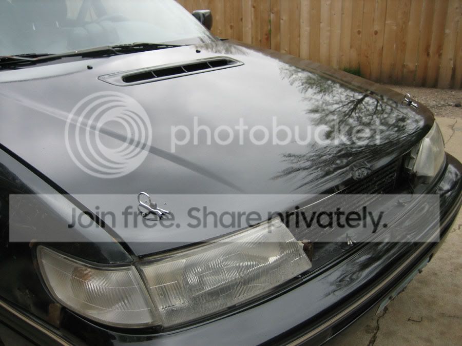

    29
    Looks good Dan! however if you are using the gloss black r/o be careful when you buff it, that sh1t burns off really really easy. ( I started buffing the hood and was like.... oh man. im done.)
    when I paint my leg white I will have to introduce your car to Ronda.
  31. piddster
    Its still pretty soft as it doesn't like to set in this weather. It took over four hours to flash, so a fair amount of dust got into it, but not bad. I'll let it harden up at least a week before I take a buffer to it.

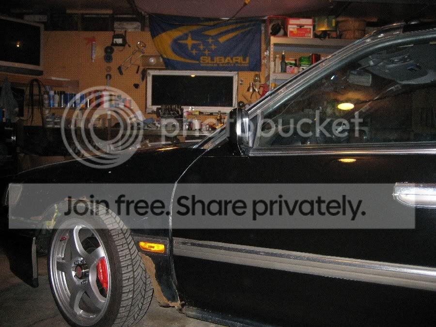

    Now its three colors, not four, and its not so obvious. Before it was Forest Pearl, Platinum Silver Metallic, Sandstone Metallic, and rust. Now its Forest Pearl, Rustoleum Black, and rust.;)
    I'm starting on the fenders right now, and hopefully the new guys will be on by tomorrow night.
