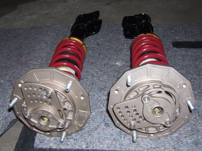

    I guess it's time to whore a pic of my coilovers - GC coilover kit with Koni inserts stuffed into hacked up stock strut bodies. Notice the lack of spring perch...
    Stuart.
  16. qstarin
    qstarin Well-Known Member
    nice. those are some serious looking top plates.

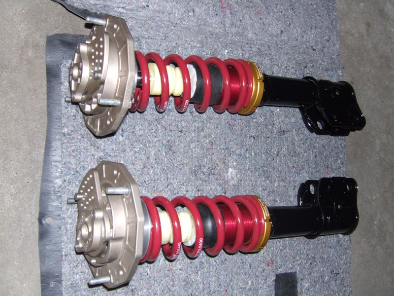

  17. stoooo
    stoooo Well-Known Member
    Thanks. Here's a better view of those...
    PDE v2 Camber Plates (yes they're designed for the '02+, but they fit just fine and because they're twisted slightly, they add caster). I couldn't use the v1 since they didn't come with holes in the top plate for the Koni adjuster.
    Stuart.
