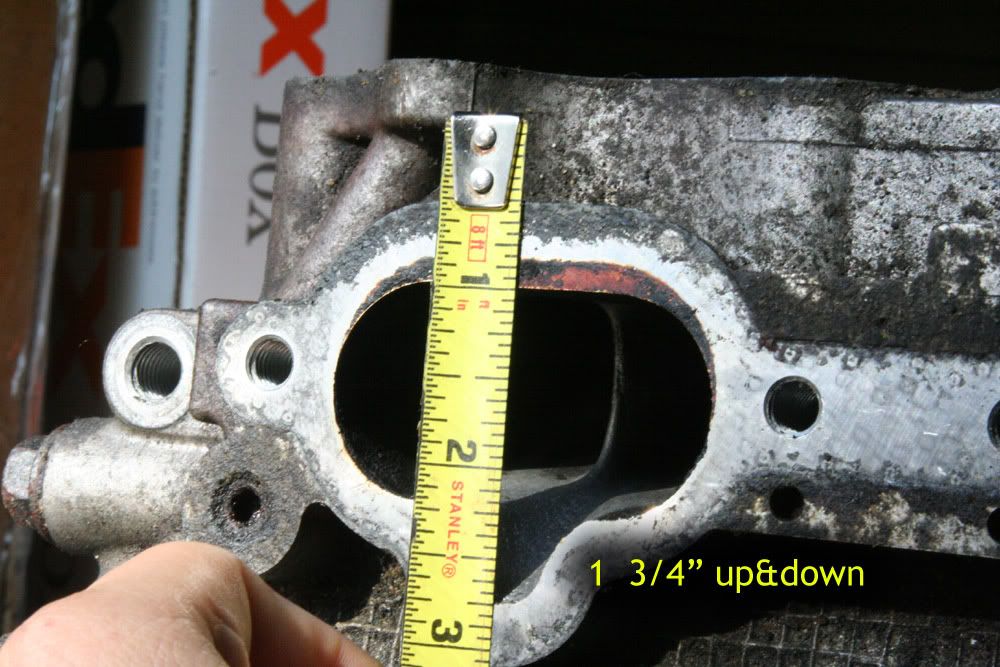

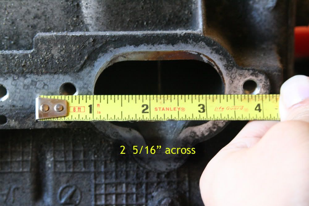

    I need some information. Remember my HEAD PORTS comparison thread, if you would, could you measure the intake port dimensions. injector boss to other side, and across the port. IF you can, also get pics of the port runners.
    This is technical information that I'm gathering.

    oh..no need for micro meter really. just measure like this.
