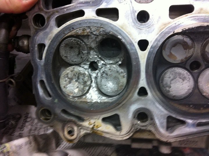

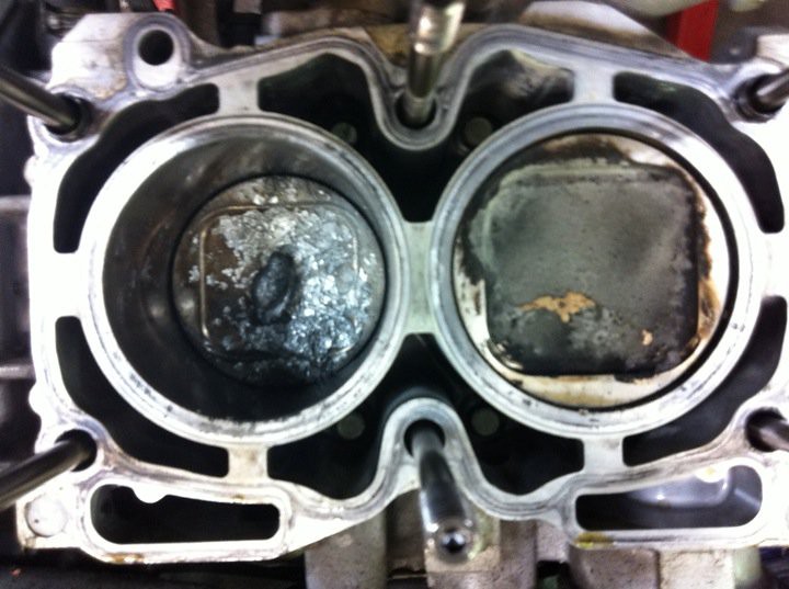

  6. blake
    blake Well-Known Member
  7. sneefy
    Online
    sneefy Well-Known Member
    1,122
    Yikes! Looks like the missing plug pieces bounced around in there a bit, eh?
