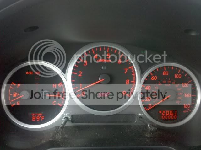

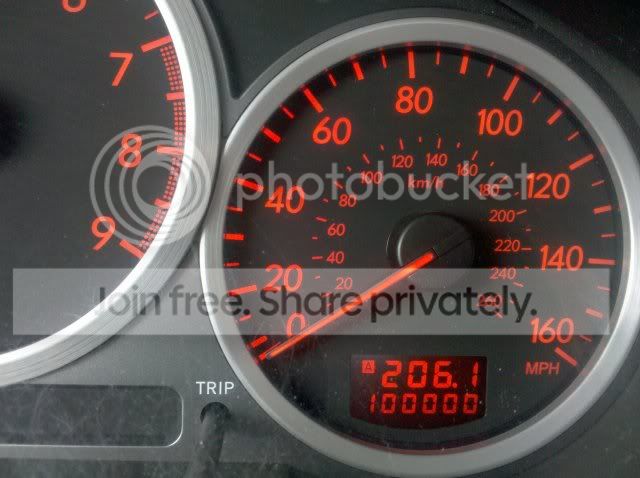

    100k on the sti...many miles are many

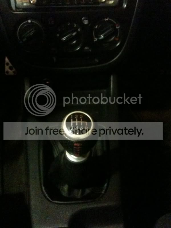

    Got sick of my shift knob so I removed it...... more to come along with pics.

  14. Deride
    Nearly complete on installing my new shift knob in the RS, boy does my back hurt :(

    Drove it for the first time since the shift knob swap, gotta say I love it! Also registered/insured #3 in my Subaru fleet! :)
