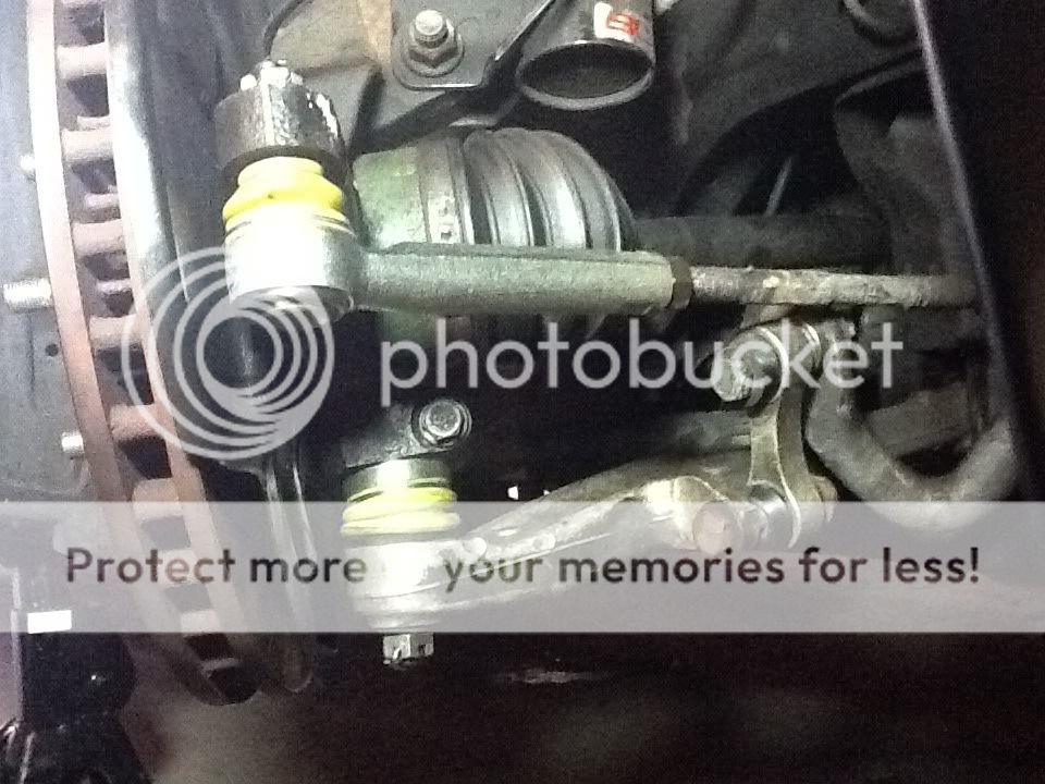

    New ball joints & tie rod ends. The horror stories made it sound like it was going to be much more of a PITA than it actually was.
