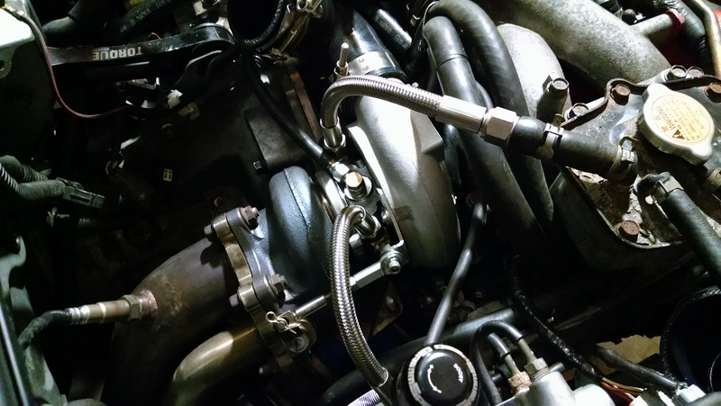

  6. EricS
    EricS Nooberator
    He also did a really nice job installing a Kinugawa braided turbo oil coolant line that I sourced, the stock VF28 hard line came out at a really weird angle (much more towards the front of the car compared to other VF turbos I've seen), and it was just about impossible to get a coolant line up to the fill tank without it getting crimped a few times. The Kinugawa banjo>barbed hose worked pretty well, the only thing that's a bummer is that it's regular steel and not stainless...
    I was also able to do a bit of light fab work modifying my @GrimmSpeed turbo heat shield to clear the WGA arm on the VF28 - that sheet steel is tough on the GS piece! It broke my hand nibbler :confused:.
    The end result doesn't look that impressive, but it took a fair amount of work with the dremel and hand files to make the curves look decent and not make the shield look hacked up:
    Aluminati likes this.

  11. JasonoJordan
    1,726
    I have that same line setup on my Wrx. they work decent after changing out some fittings to get better clearance on the transmission bellhousing
  12. EricS
    EricS Nooberator
    Huh we didn't have to do that, but we only used the braided hose for the feed line and used the stock return hard line (after severing the two halves of the stock conjoined hard lines), maybe that's why... Is your braided line rusting at all?
  13. JasonoJordan
    1,726
    Only place that has some rust was right at the swivel. It could be that the center on the vf37 is diff then the turbo that you are using
  14. xluben
    I am using both of the Kinugawa braided coolant lines on mine. I just put one on each side of the CHRA instead of both on the tranny side like OEM.
    EricS likes this.
