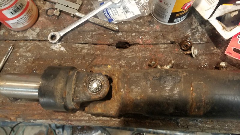

    Greaseable factory U-joints:
    2018-01-30_10-11-44
    by Numbchux, on Flickr
    Rear Ujoint in our Outback failed so badly it wrecked the yoke. Fixable, but at the very least would require balancing.
    I happened across a driveshaft at UPull with good joints. I didn't want to open pandora's box by replacing them, but I wanted to do something to prolong their life. I began experimenting with the joints in the old shaft. Cross is hollow, so a grease fitting in one cap would get grease to all 4 bearings. But the cap was hardened, and took me a few tries to drill through. I ended up getting a carbide tipped bit, and drilled, tapped, and installed a fitting.

    Awesome! Can I ask a you a u joint related question? I've got a 92 GMC truck. Had a clicking in the rear, speed dependent and determined it to be the rear u joint (via movement when pryed on with a pry bar).
    Replaced with a Moog one. Was dead silent right away and now the new one sounds worse than the old one did... Did I do something wrong?
    Seemed like the new one had an optional grease zirc (I had to remove a plug to put the zirc in, so I'm assuming you could run it either way). I didn't add any additional grease as it seemed ready to go.
  16. Chux
    1,516
    Typically, the grease in them is assembly lube, and the plug is only for packaging assembly. You should put the zerk in and push plenty of fresh grease through them after installation.
