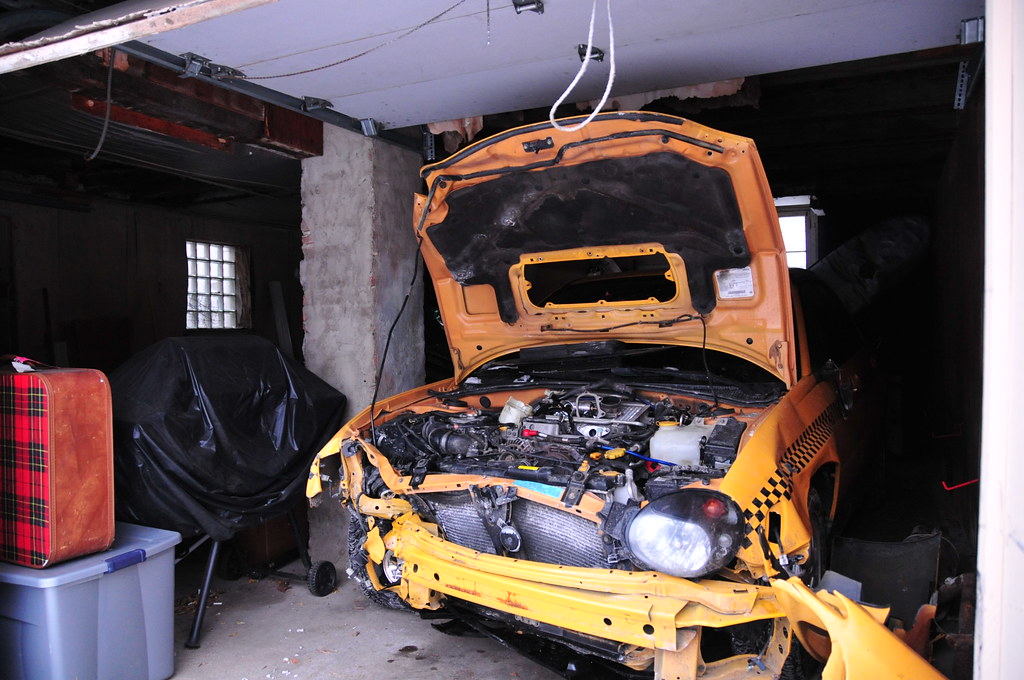

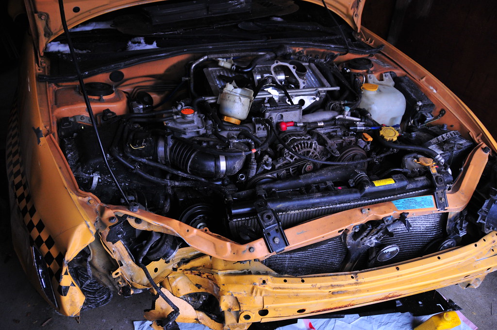

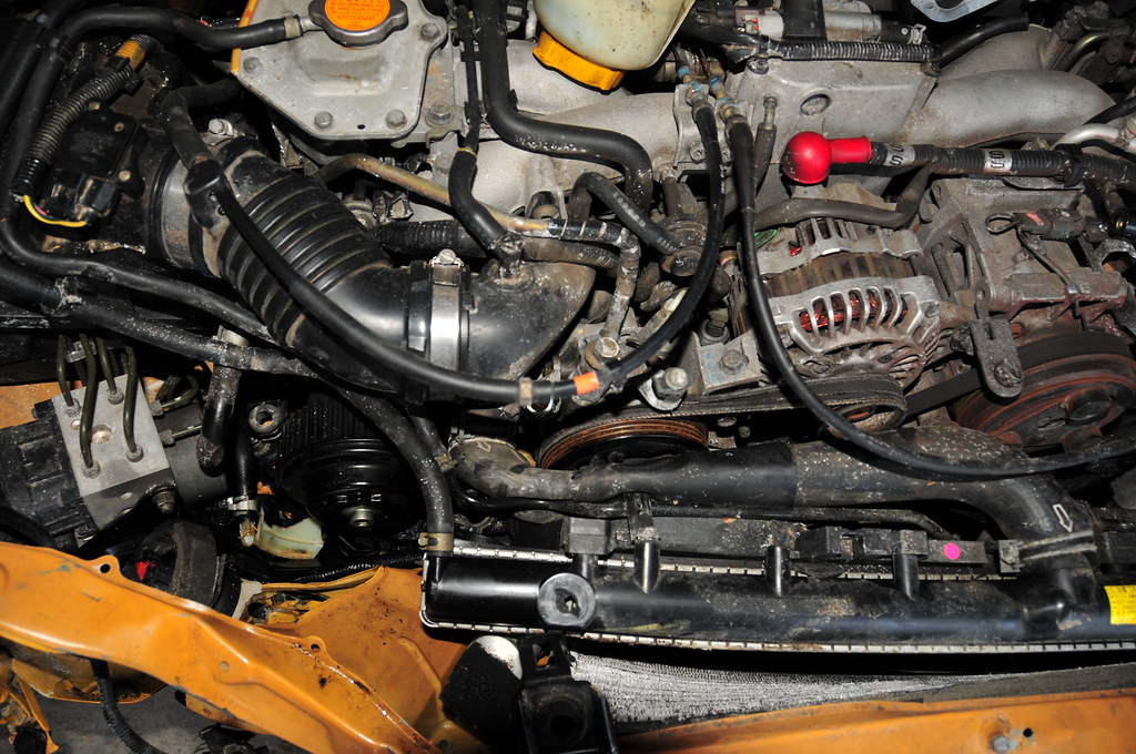

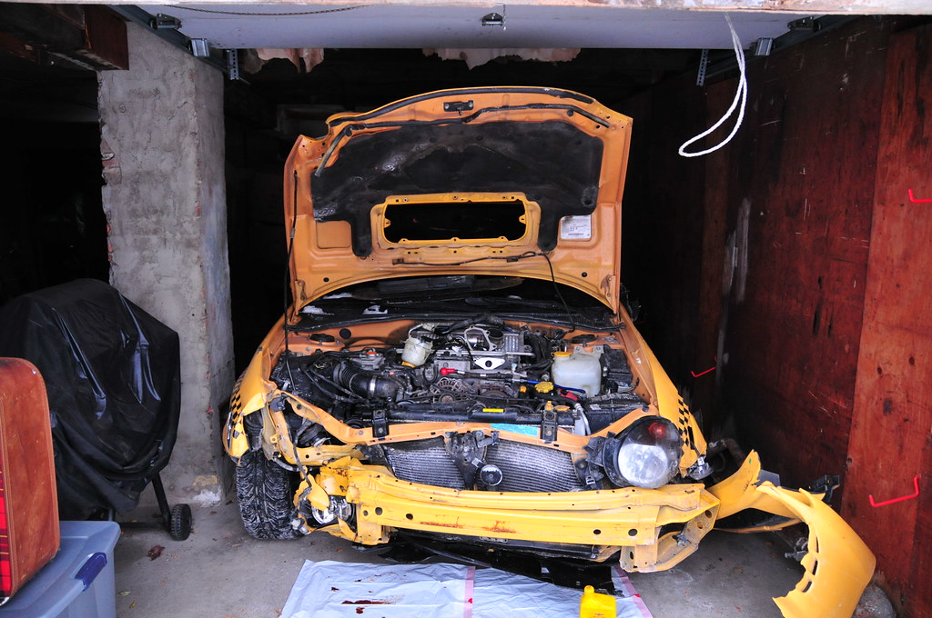

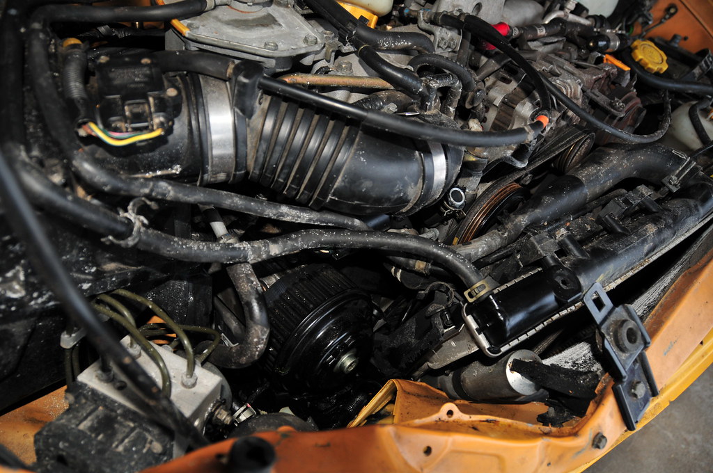

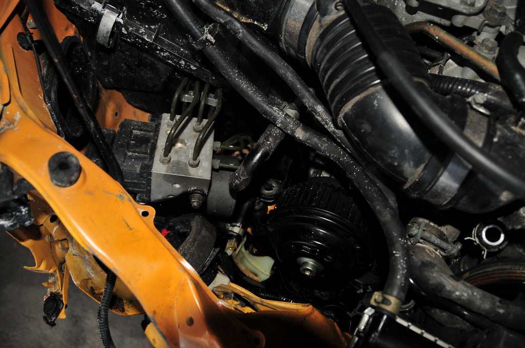

  22. qstarin
    qstarin Well-Known Member
    Donor picture whoring
    Got it back and into my tiny little garage stall - its small and cost me a little bit of $$, but at least its in my back yard.
    20* and up I'll be working on it every chance I get. First task is to get that motor out and assess the heads. Sounds like fixing those is best left to the pros, so I'm sacking away some cash.

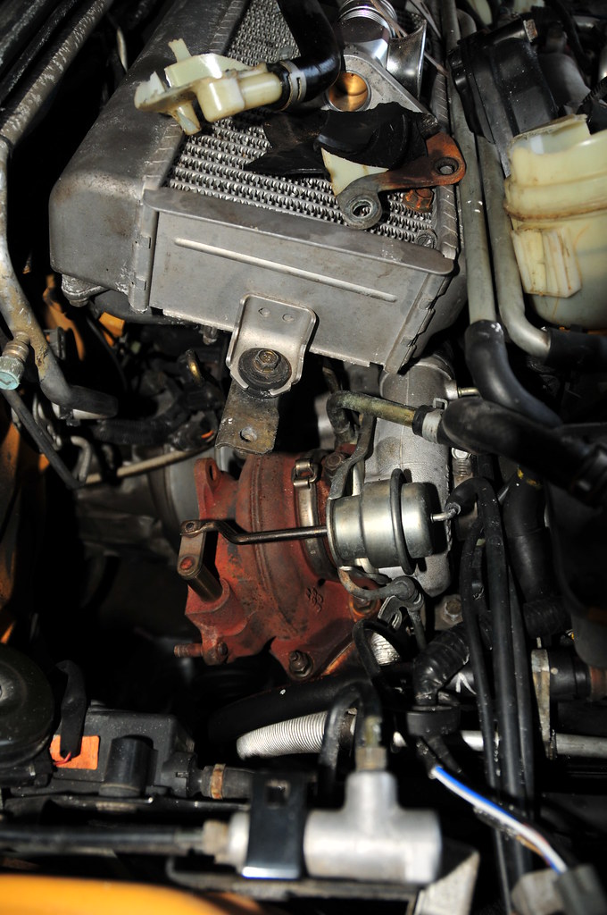

  25. qstarin
