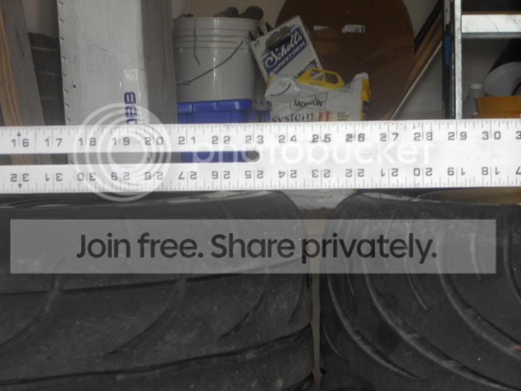

    The Federals run a little wide. The 235 will fit like a 245. I measured the Federals against a Dunlop Star Spec and there is very little difference. These are both mounted on RPF1's, 17x8. The Dunlop is on the left.
  9. xluben
    ^As seen above, the Federal 235 runs similar to a 245. On a 7.5" wheel it will be close to 2 sizes wider than normal.
    The 255 Federals run more like a normal 255, but they're definitely more than needed.
