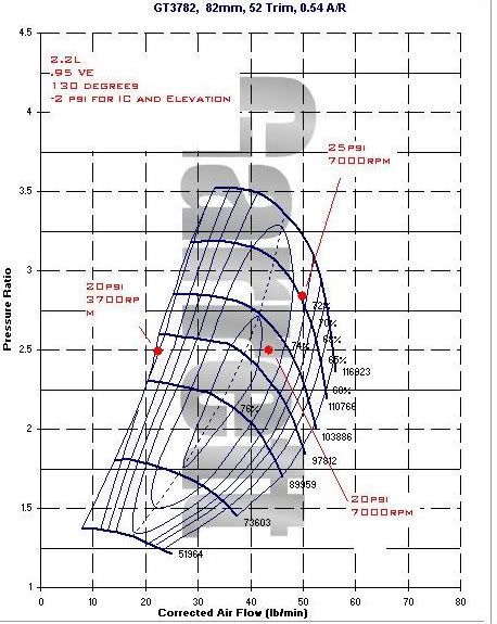

    This is the compressor I want. Its a GT3782, but I want one in a ball bearing water cooled version. I'd have to have Precision put one together for me probably.
    Anyways, these things kick ass. Its capable of 20psi at hair before 3700rpm on a 2.2L and stays in the meat of the efficiency range to redline. I plotted a point at 25psi for ****s and giggles and it still looks good.
    Granted this would be when I put decent heads on with decently aggressive grind on the cams to reach a .95 VE. 130 degree inlet temp may be a hair high for a front mount too.

    Wow, that's impressive^ Really!

    I know, thats why I want one baddd. I just want it to be water cooled as the GT3782 is an oil cooled journal bearing turbo as it comes from Garrett. I'd need a custom unit.
    I plotted another point after the fact with 10 degrees lower temp and reving to 7500 rpm, and you'd have to lower the boost to not cross the choke flow line. That would be fine as you could get more flow out of it to about 55 lb/min, or 550hp or so.
