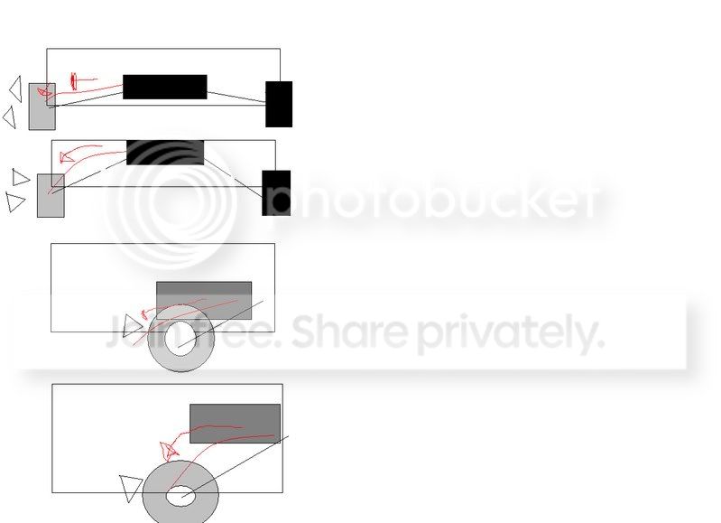

    Devils Advocate: Under the intense brake/gas/brake/gas that happens in the WRC I would imagine that weight transfer within the confines of the car matter more than just about anything and in his arguement he asks for the engin to be moved backward and up. I would say that while the engine being lower would be better in blacktop stituations where "grip" is something that can be calculated/counted on, in loose surface racing having the weight of the car sitting higher and coming down over the top on the outside wheel might in-fact aid in the search for grip..
    And now a crappy MS paint rendition:
    The lines of force (in my head) seem to make sense, and are illustarted by the red lines.
    The higher engine allows a more down to the down-and-outward transfer, while having the engine father back would bring that "down" to bear more effectively over the Hub/axel/wheel assembly.
    Think like porshe. Seems like all sorts of crappy until you apply brakes, then suddenly: GRIP!!
    What I wonder about though, is with all this thought to the braking, how then, would the massive "digging" acceleration be affected. I'd think too much rear equalling a crappy squierrelly rear end.
