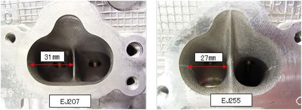

    DOUBLE D's!!!
    BIG PORT vs SMALL PORT
    Ported vs stock; USDM WRX
