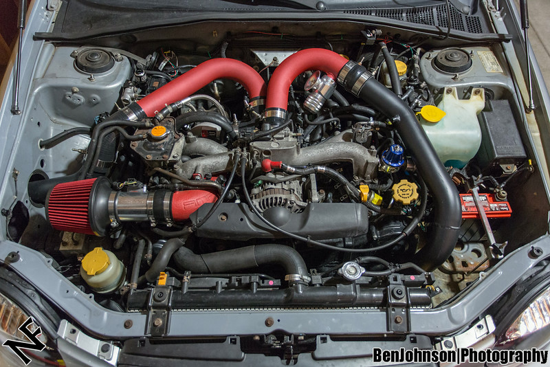

    I did some more work getting the reverse flow FMIC piping to work today. I had tried it previously just by switching the top two pipes that come with the 02-07 TurboXS FMIC kit. The pipes all fit together, but the passenger side sat too high and touched the hood. This caused the pipe to pop out under boost so I had to switch back.
    Luckily I found someone locally that was willing to donate the two spare pipes that come with the FMS/TurboXS FMIC kit for the 08-14. He has a WRX, so I got the STI version pipes (for the STI flange turbo, and STI intake manifold). These pipes are both longer than the 02-07 pipes so I cut them down to fit.
    The driver side works perfectly. I did have to sand off the powdercoating to get the TurboXS BOV to fit, but I am glad that I at least got it on. On the 02-07 kit I sanded a LOT and it still wouldn't fit so I had to use a hose and clamps. The passenger side pipes don't really line up, even after cutting, so I ordered a 45 deg coupler. It should arrive later this week or next week.
    Additionally I had been having intermittent issue with the pipes popping out, even with the pipes in the standard configuration. This happened at least half a dozen times at the track and multiple other times on the street. To try to resolve this issue I bought a set of hump couplers.
    The driver side mounted up fine. The hump coupler allows for a bit more movement and it also a hair longer. I managed to use a hump coupler and get the passenger side on as well. It's a bit kinked, but it does hold full boost. I will still be putting the 45 deg coupler on when I get it. I will also be putting hump couplers on at least the intercooler core endtanks. Maybe on the other two joints as well.
    Here are some photos.
    In progress:
    Before:
    After:
    More details:

  28. xluben
    Too much work. Maybe later.
    The main point in reversing flow is that it keeps the cold air from going directly over the turbo before entering the motor.
    I don't have AC so I can just move the alternator over.
    EricS likes this.
