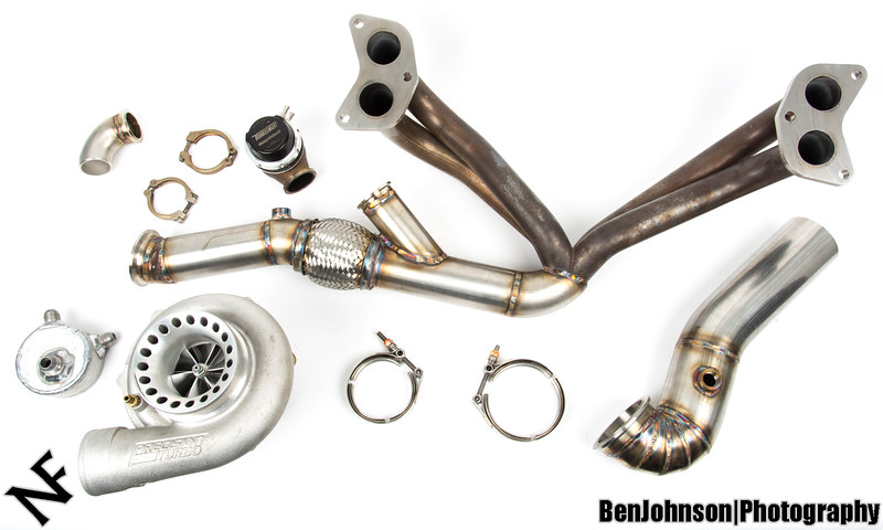

    Yeah it will be pretty stealthy.

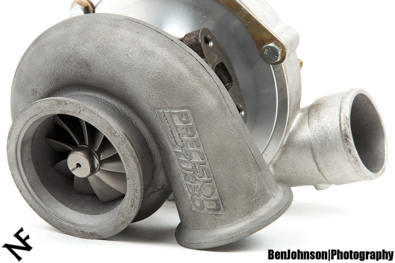

    I had a 6266 on my 2011. It was a pretty good midsize turbo. About as fast as the 60-1 on my 2002. The 6266 made quite a bit more power but the car was heavier. Spool is not like a VF39. LOL.

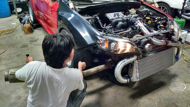

    LOL. Subaru should use it as stock turbo then.
    Nhibbs likes this.
  4. russellmn
    russellmn Well-Known Member
    Was past 24psi at 3k... No way would anyone want that car to come off the dealer lot that way... Absolutely nuts fast. Would hate to see how many kids wrecked them. Lol

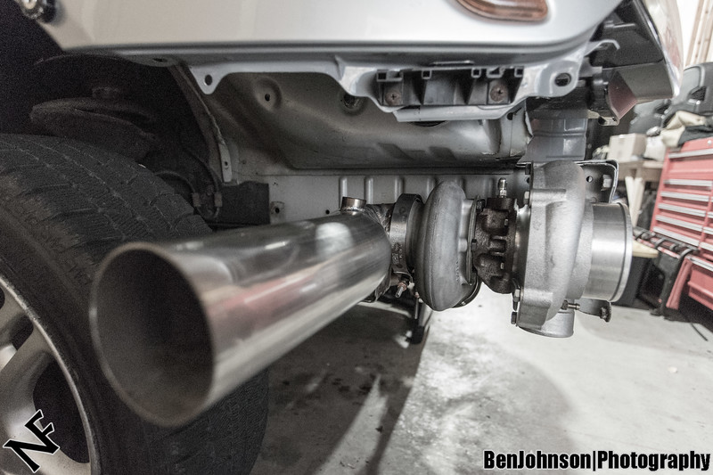

    I can't tell if you're serious or not.

  8. xluben

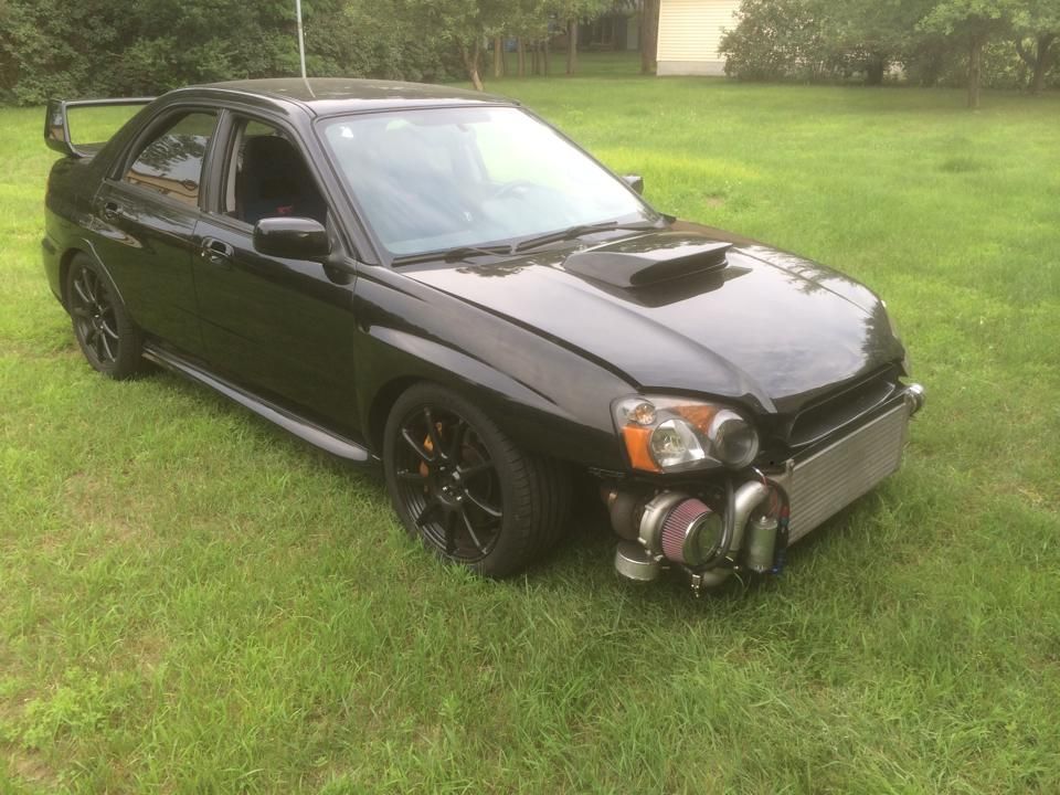

  9. russellmn

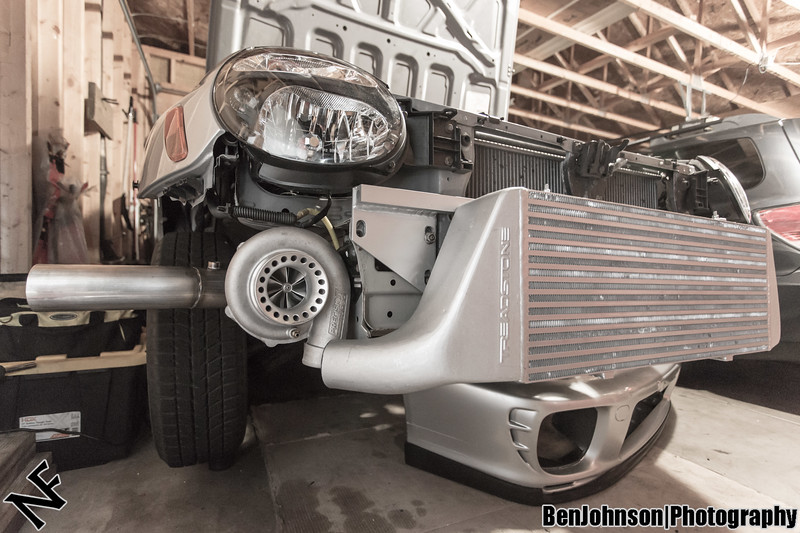

    Don't know what dyno that WRX was on. Only time Jared had the car on the dragstrip he ran mid-tens at 130ish and got booted. (I wasn't there, don't know exact numbers) It's basically a road course track day toy, no cage yet. I might be putting one in for him next year, we'll see.
    As for why Subaru runs the system they do, I wouldnt have the foggiest idea. I would hazard a guess that cost, availability, reliability, durability, and performance all play a part in that decision. Why did they run the ultra soft pistons in the 08-14 STi engines??? Better parts are available...

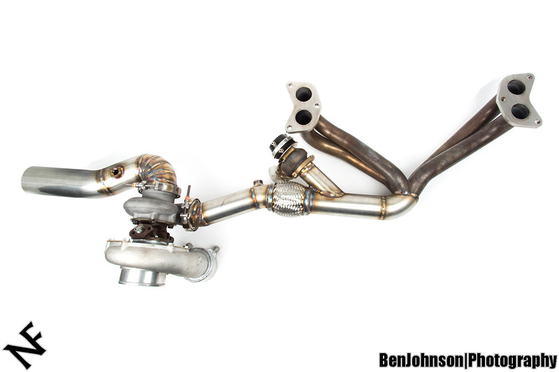

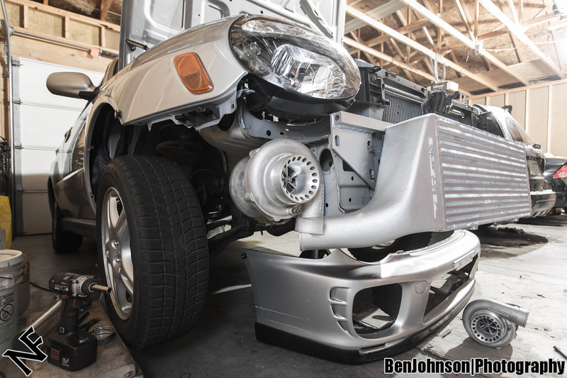

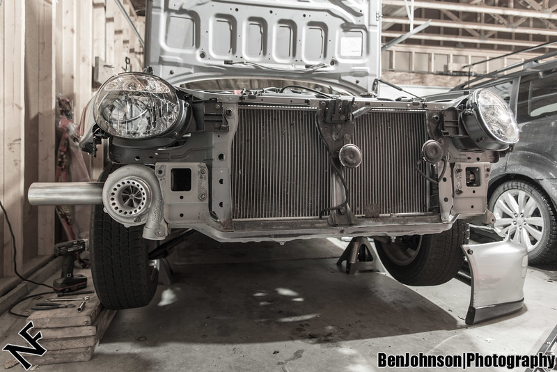

  10. xluben

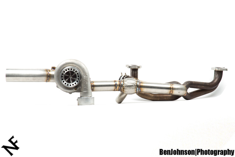

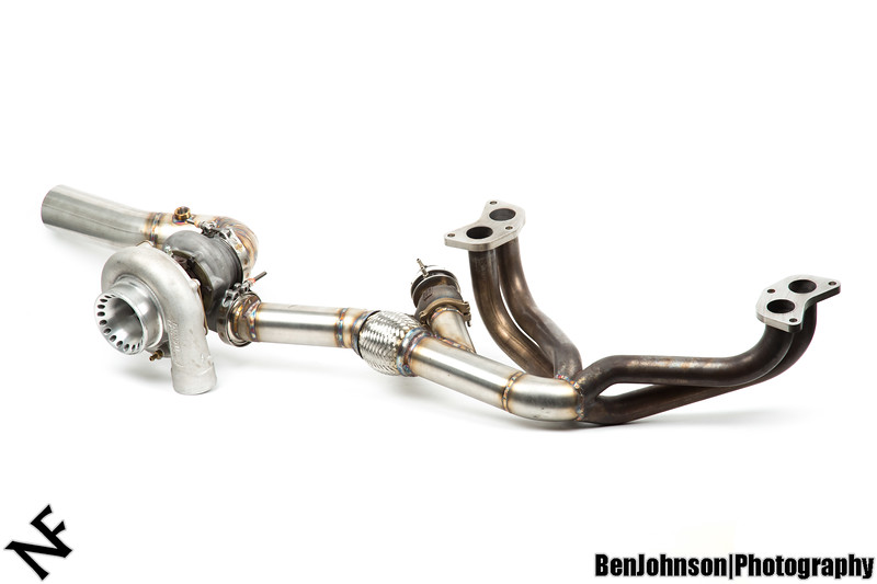

    Mock up test fit of the new kit.
    tangledupinblu, joebush44 and Nhibbs like this.
  11. Ryan FailRad
    I am certainly no expert nor will I claim to be, but shouldn't the charged side of the intake be rotated roughly 90 degrees counter clockwise so that the piping won't have to make an extreme turn immediately out of the turbo?
    Set up looks pretty awesome though!
    kongzilla likes this.
  12. xluben

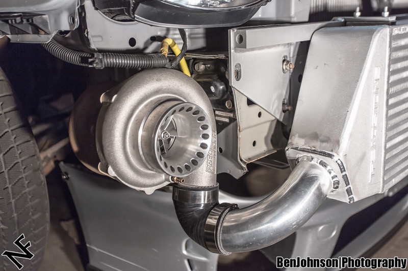

    Hard to tell from that angle, but if the turbo was clocked like you suggest, it would have the output going directly into the frame rail.
    Pointing it down, and then having a 90° bend into the FMIC is the best I can do. I'm planning to run a Treadstone FMIC and hopefully I can get the piping to work out with out too much effort.
  13. EricS

    Any chance to run the FMIC with side inlets on top, and clock the turbo so the outlet sneaks between the rail and the headlight?
  14. xluben

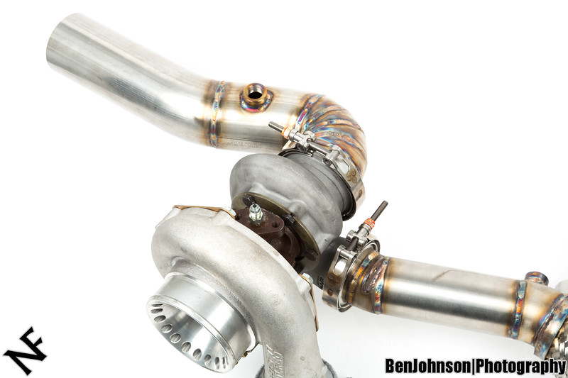

  19. xluben
    Fingers crossed on the FMIC fitment. I'll find out once it arrives.

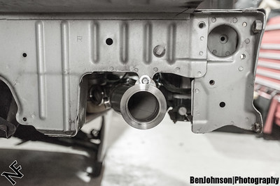

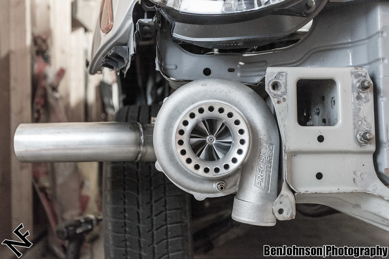

    Exhaust dump out the fender is pretty loud, especially inside. Here's Fuji's solution during cam break in. Haha.
    It may end up being a bit much for street use. I'll decide once I get some time on it.

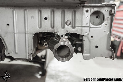

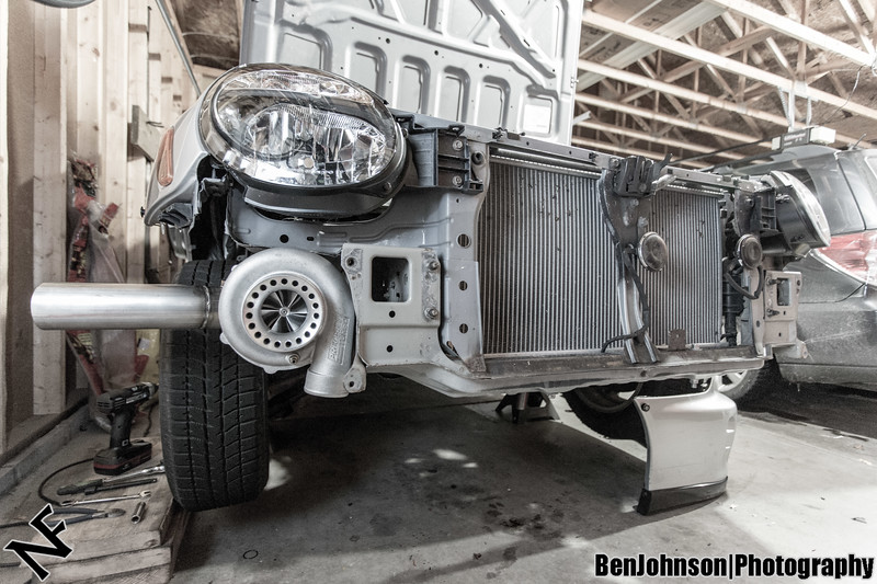

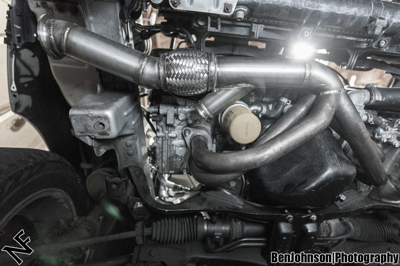

    Most of the oiling components should be arriving today. Still need FMIC as well. Took a few more mock up pics.
    Likely have to cut ~6" off the exhaust dump to get it to sit flush with the side of the bumper.
    Will have to extend this mounting tab a little to reduce stress on the flex before final install.
    [​IMG] [​IMG]
    Good clearance around the oil pan and filter. Wastegate should be easy to access.

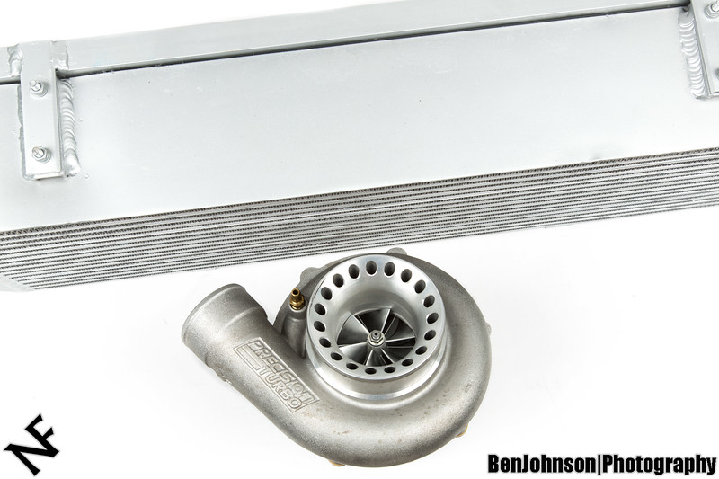

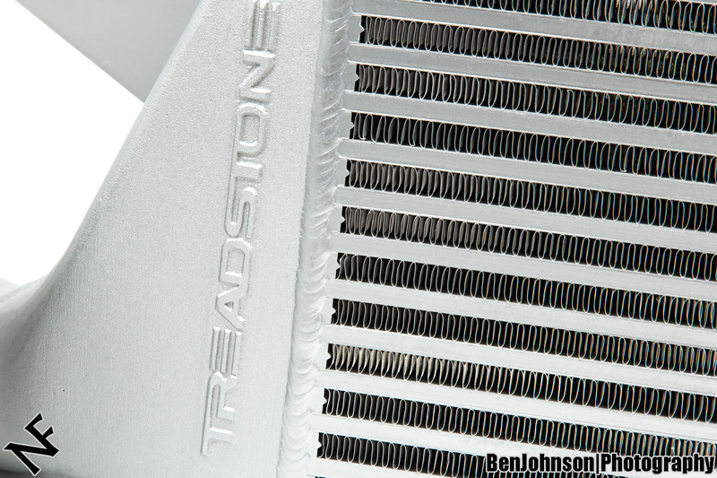

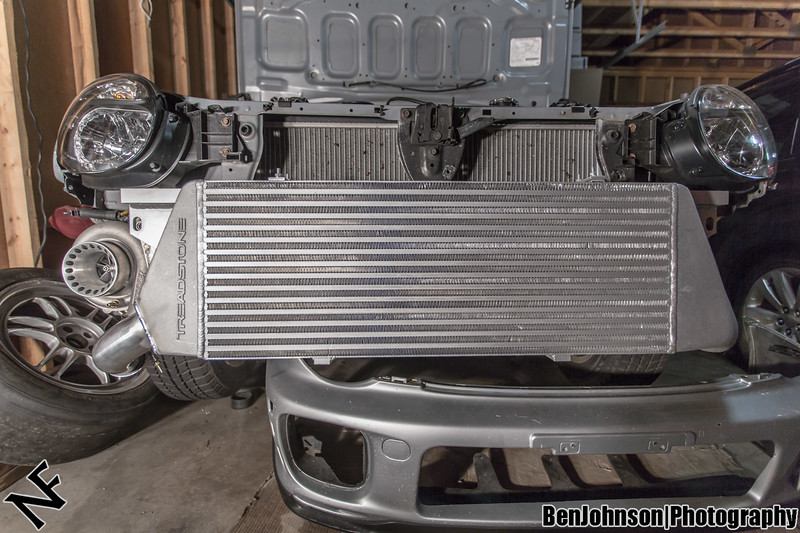

  29. xluben

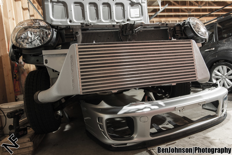

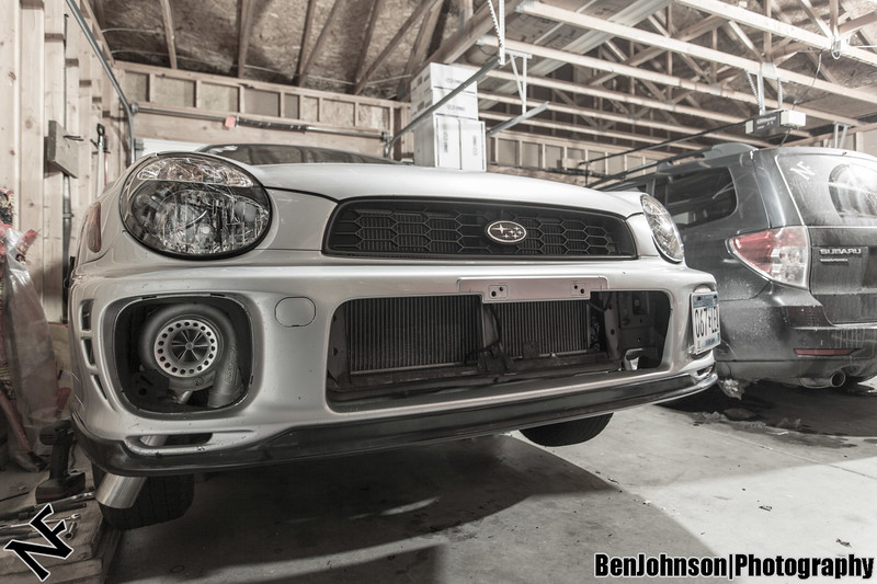

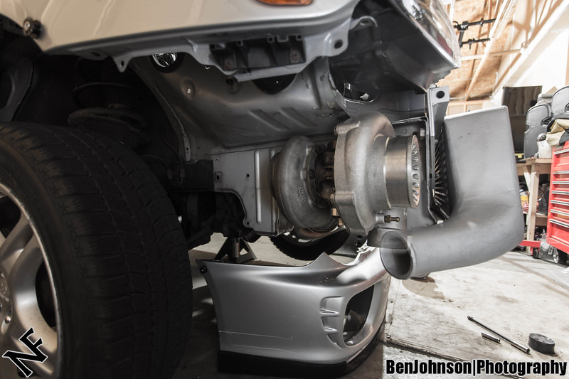

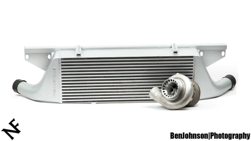

    Treadstone FMIC came in. It's huge! It's going to be a bit of work to make it fit with the turbo.
    I did a mock up install of the FMIC. Had to trim a couple tabs off just to get it mounted. I'll likely have to do a bit more trimming before the final install.
    Unfortunately the turbo to FMIC didn't line up as perfectly as I'd hoped. I can't install both at the same time due to interference but I did some Photoshop overlays.
    I will probably need to get a photo from directly underneath to confirm, but this is what I'm thinking so far. Chop off the end of the compressor outlet, and weld an elbow on.
    Also will have to cut down the FMIC end tank inlet an inch or two. Then hopefully it will just be a straight or possibly 45° coupler to the intercooler. Any other thoughts?
  30. Nhibbs
    Nhibbs Well-Known Member
    2,222
    I cant really tell but is there any way to mount the turbo a little farther back?
    In the pictures it looks like you might be able to but you would have to get the "uppipe" rewelded to come straight over and probably the "downpipe" would have to be reworked so it doesn't hit your wheel...might be too much hassle, I don't know.
    At least then you wouldn't have to cut up the nice cast end tank and would give you some more room to make the bend less severe for the charged air. I could see how that might push the turbo too far back toward the suspension/wheel though.

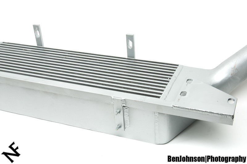

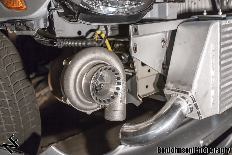

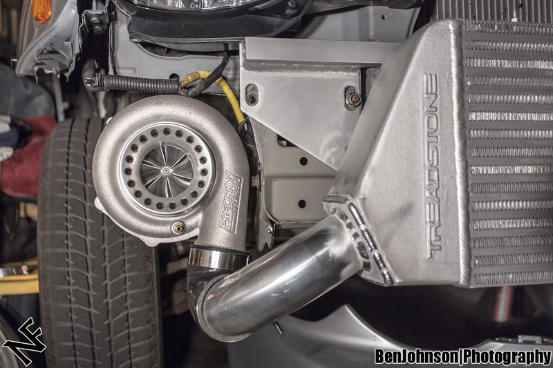

  32. xluben
    Chopped a couple inches off the end tank and was able to mount both the turbo and core at the same time.
    Decided it would be best NOT to do any permanent mods to the compressor housing (in case I ever want to switch turbos) so Matt will be chopping off more of the end tank and fabbing up some new piping.

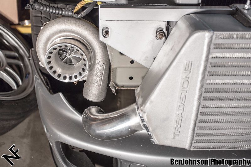

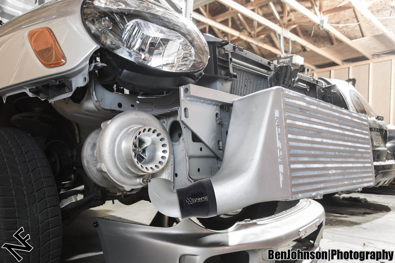

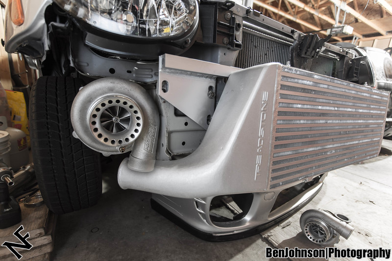

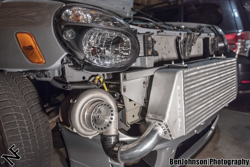

  40. xluben
    After a few revisions the FMIC end tank is redone. Chopped off the end completely and then Fobia welded on a flat plate. Off of that it is a 2.5" OD, 90° bend. Then it's just a 90° coupler onto the turbo.
    It's a tight fit, and kind of a trick to get on, but I think it will work. There's not a lot of material for the coupler to grab onto, but I hope it is enough. It ended up looking pretty clean and simple, IMO.
    Coupler installed:
    Big enough intercooler?
    joebush44, Nhibbs and 2barsti like this.

    Looking nice. Have you thought about maybe adding an elbow to the turbo and connecting the turbo to the ic pipe with a vanjen clamp?
  42. xluben
    Yes, but I decided against that to keep the turbo universal. Right now I can swap in a 58, 62, 64, or 67mm PTE turbo within a few minutes. I like having that option even if I am not swapping frequently.
  43. Nhibbs
    2,222
    Looks good! Is that a 6466 on there now?

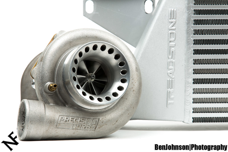

  44. xluben
    Nope. Still the Gen 1 6266. You can tell by how the blades look from the front:
    Gen 1 CEA is on the left and Gen 2 CEA is on the right.
    Gen 1 CEA: 58mm, 62mm, 67mm, 71mm, 72mm, etc.
    Gen 2 CEA: 62mm (Gen2), 64mm, 68mm, 72mm (Gen2), etc
