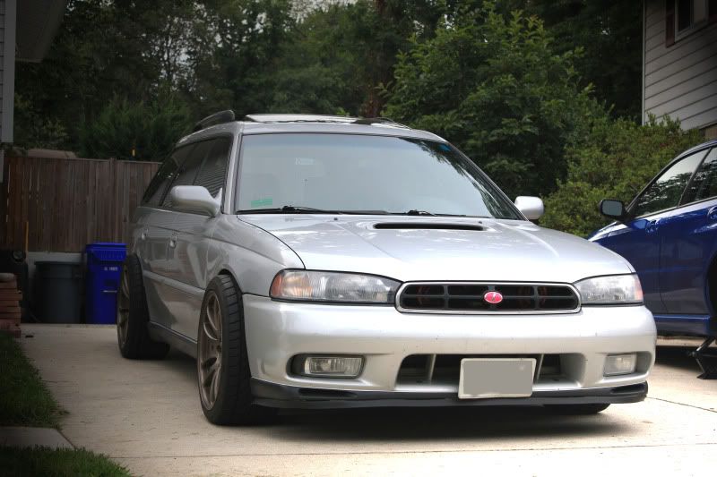

  27. DirtyLeg01
    DirtyLeg01 Well-Known Member
    It'll look something like this
  28. ShortytheFirefighter
    Some dumbass thought that looked like a good idea?
    We're doomed.

  36. DirtyLeg01
    The wagon I posted was actually a joke. the guy put the wheels from his sti on it and took a picture.
    edit- you can see the sti on jacks next to it
