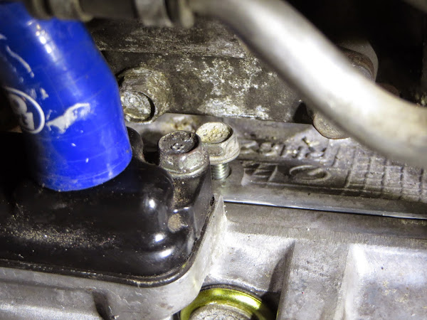

    Anybody know what this random 10mm head bolt is for (the one that's half in)? It was on there loose when we put the heads back on. Generally when I take something apart I'll put the bolts back in so as to not lose them or where they go. I took tons of pictures during disassembly and can't see anything attached to it. Also, the car's back together and there isn't anything major missing, that I know of. Just weird to have a mystery bolt. I left it there as to not bring bad juju upon myself...

    +1 for NF tunes, and RS is good too.
    Don't know about your mystery bolt.
