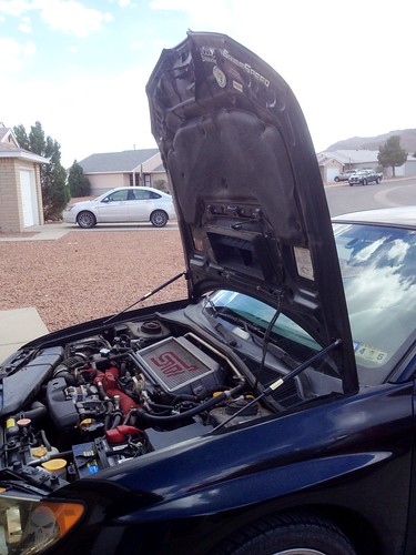

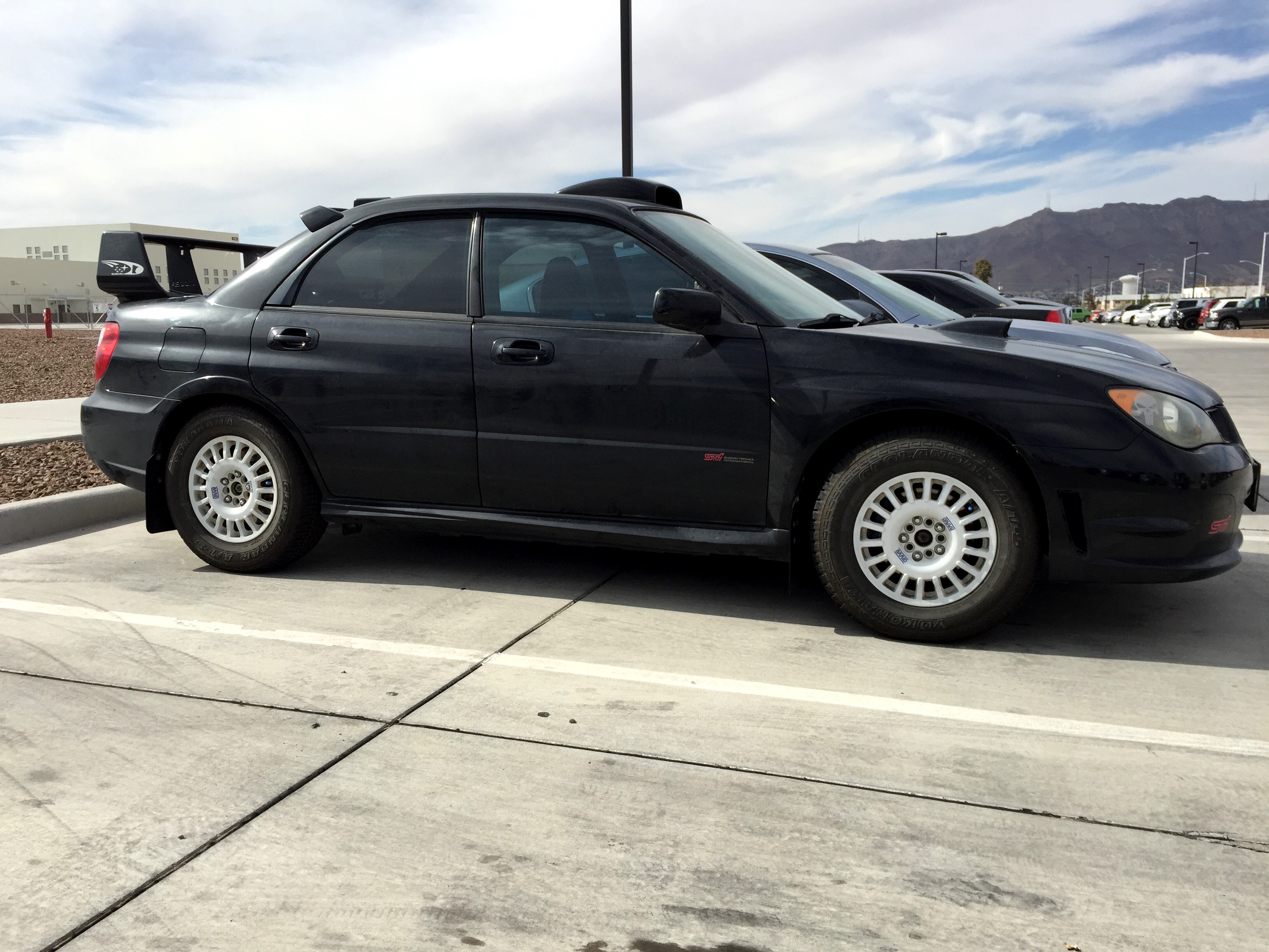

    And now let the build commence. Started out slow with mods as I was just back (did these on Thursday and Friday while my wife was doing schoolwork); installed my JDM Hazard switch, the armrest extension and swapped out shift knobs for one that I won while I was away.
    Swapped out my hood lift struts for the GrimmSpeed Hi-lift setup (very high, can barely reach the hood from the front) and swapped in the billet Aluminum oil cap.

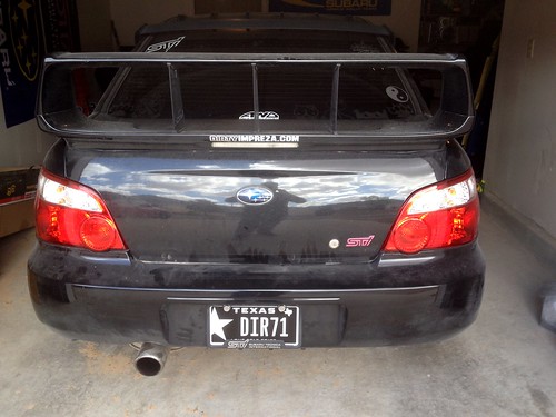

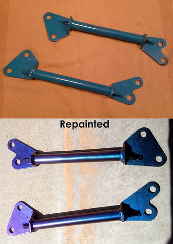

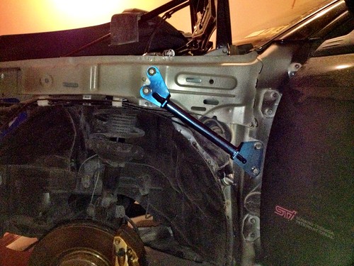

    Installed the ‘04/05 taillights and my new license plates on Saturday and the repainted fender braces on Sunday:

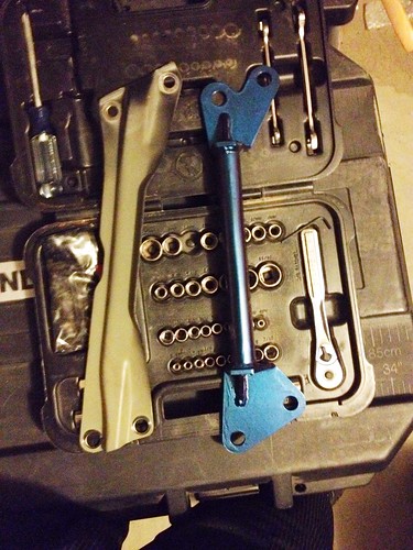

    A comparison between stock and the Offensive Power fender braces:
    And installed (passenger side was already finished, pictures sucked worse than this one):

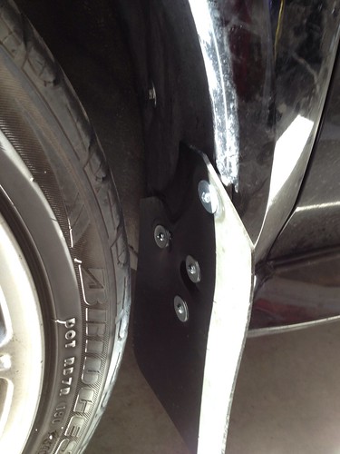

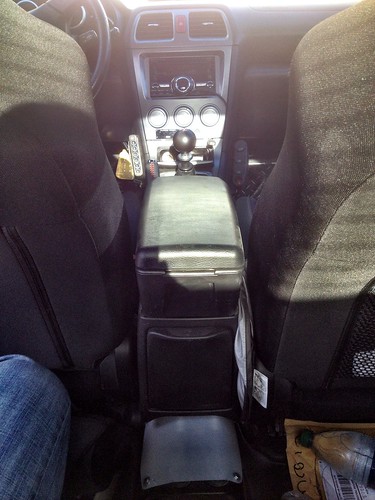

    Not too much progress this weekend, since I was feeling a little under-the-weather and lazy. So all I did today was install my mudflaps and do a little project I’d been thinking of for a while. Here’s the first project and the mudflaps, I replaced all the push pins in the front fender liners with rivnuts and some machine screws; this is also the same method I used to install the mudflaps:

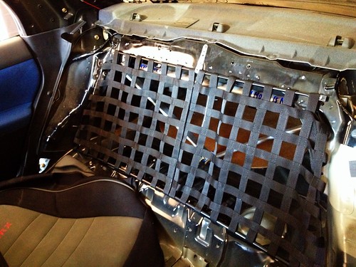

    The second project was to install some window nets (the type used to keep you in the car when racing) and replaced the panel that was behind the car seats. While I was at it I removed the seat belts and some of the other un-needed hardware back there; probably 10-15 net pounds dropped off.

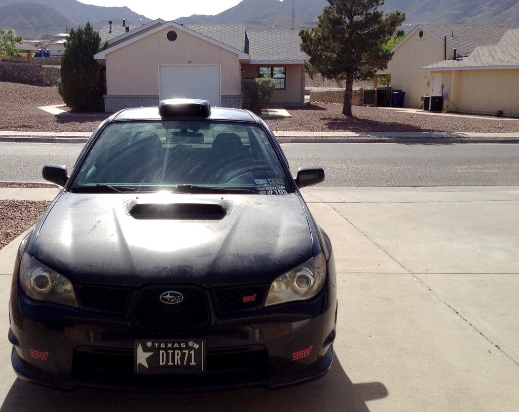

    Maybe during this week (supposed to be half-days at work) I’ll cut the roof and install the roof-vent and scoop and maybe finally decide whether I’m installing the last 2 Stiffis or just removing the center one and leaving it with 2; spacing looks off no matter which way I go.

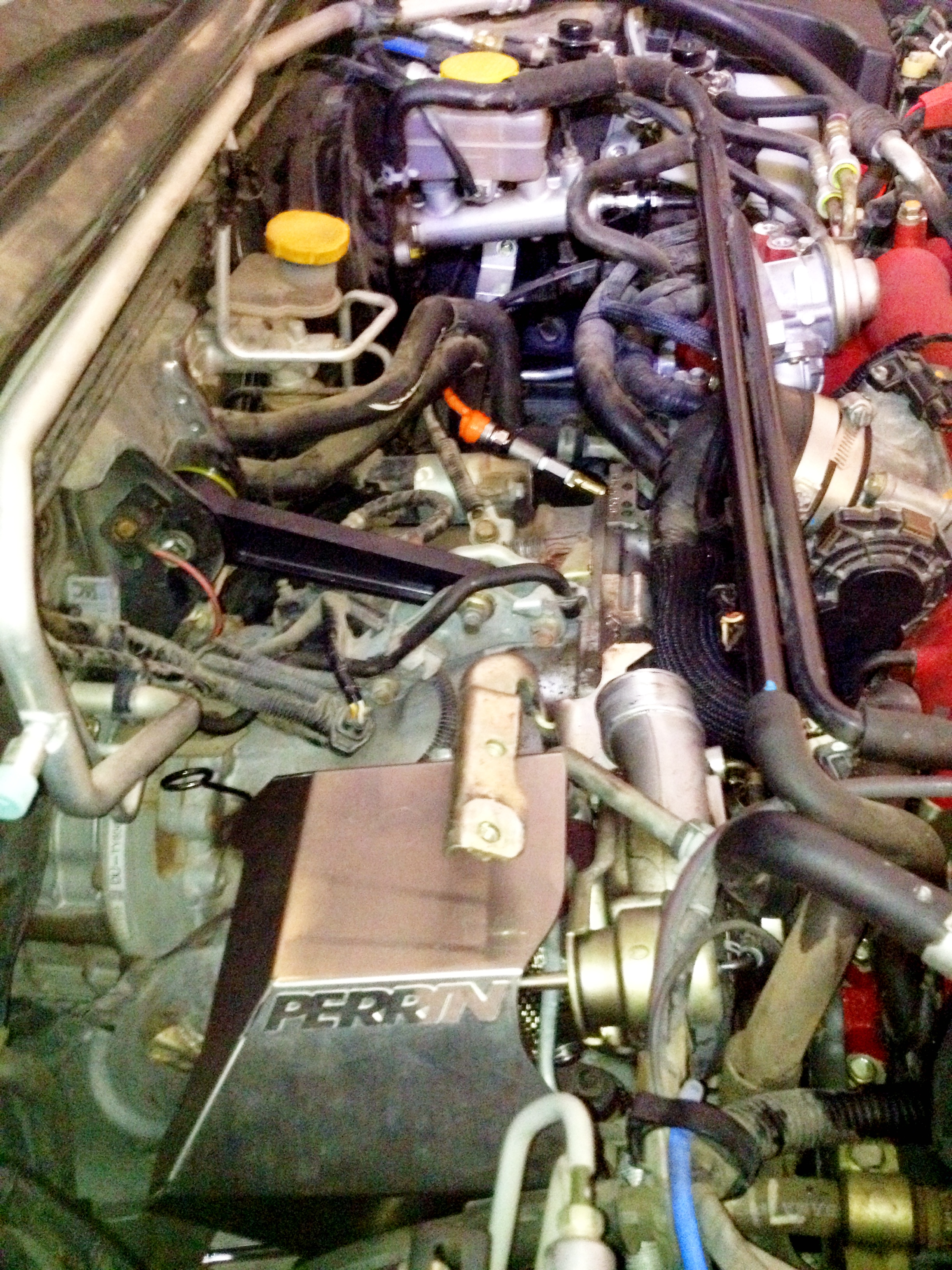

    Alright, some more progress. Tuesday (22nd) I started doing some things that I’d been waiting to do since they all involved pulling out the TMIC, and as anyone with a stock location IC on an STi knows, that thing is kind of a bitch to get back in quickly. (I’ll have to pull it back off to install the T-bolt clamps and the rest of the Samco hoses for the IC.)

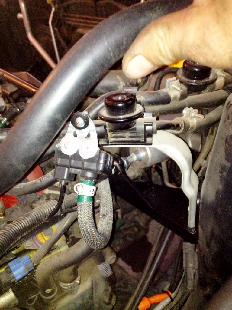

    So I started Tuesday by finally fixing my Defi gauge setup; the gauges weren’t lighting up unless the headlights were actually on (not just DRLs); turns out I just had the daisy chain of gauges in the spot for the plain, old Link-Meter gauges (spot 1) when they needed to be plugged into the jack for Link-Meter BF gauges (spot 2). As soon as I switched the connection and turned on the “Accessory” position with the key, they lit up. I followed this up by installing the white BF oil pressure gauge I found on Amazon (last one!!!) but had to wait for UPS to show up to install the sender as they were delivering the galley plug I needed to finish it up (made an extension for the sender using a grease gun hose, a couple 1/8 NPT female-1/8 BSPT fittings, one 1/8 BSPT female-female coupler, and the galley plug). Well I waited I took out the TMIC and started working my way to the galley plug location; all I can say is **** whoever decided installing those spring clips upside down was a good idea, took me a good hour to remove the other end of the hose connected to the BPV (big hose, not little) and the other end of the coolant hose connected to the throttle body. Got a bit of a coolant shower as I worked around here, mainly because I used canned air to try and push the coolant out of that TB coolant hose and it pushed back out with extra pressure when I stopped pushing air in. Got to a stopping point in this job (galley plug hadn’t arrived yet) so I switched lanes.
    Next job I switched to was installing the KartBoy Pitch Stop Mount, easy install, however I didn’t realize the nut on the firewall side was welded in place so I ended up breaking it loose. No biggy, just need a 17 and a 14mm (IIRC) to do it if I ever have to disconnect it. Next task was installing the Turn-In-Concepts Master Cylinder Brace, relatively easy install on a car without an air-pump (stock that way) and with the TMIC out of the way. Took me all of about 20 minutes to do taking my time, could feel the difference in the pedal feel (not sure if I felt the pitch stop mount however, I was paying attention to the last thing installed more) when I finally drove her. Time for another part since I was still waiting, think I’ll finally install the turbo blanket (PTP Lava) and my Perrin Turbo Heat Shield. Somewhat of a pain getting the old heatshield off, mainly the bottom portion as it is designed to be removed only if the downpipe isn’t in the way. A little bit of bending later and some pushing and it is out of the way. Turbo blanket goes in with some headache (imagine it is easier if the car is even more disassembled) and the heat shield goes over it with little hassle (snapped the head off one of the 2 bolts on the driver’s side, no biggy).
    Finally the galley plug has arrived!! Time to install the oil pressure sender. Relatively easy install (once you get the old plug out after dealing with those damned spring clips and coolant showers), hook it up to the cable, run it in to the car and connect to the control unit. Good to go. It’s getting late so I do one last thing and finish the install on my boost gauge (had sender set up, just never got it hooked into the BPV hose). And with this last part done it is bedtime. Here are pics of the progress, you can see the blanket, heat shield, oil pressure sender and the MCB (partially) in the first pic; second shows the MCB a bit better.

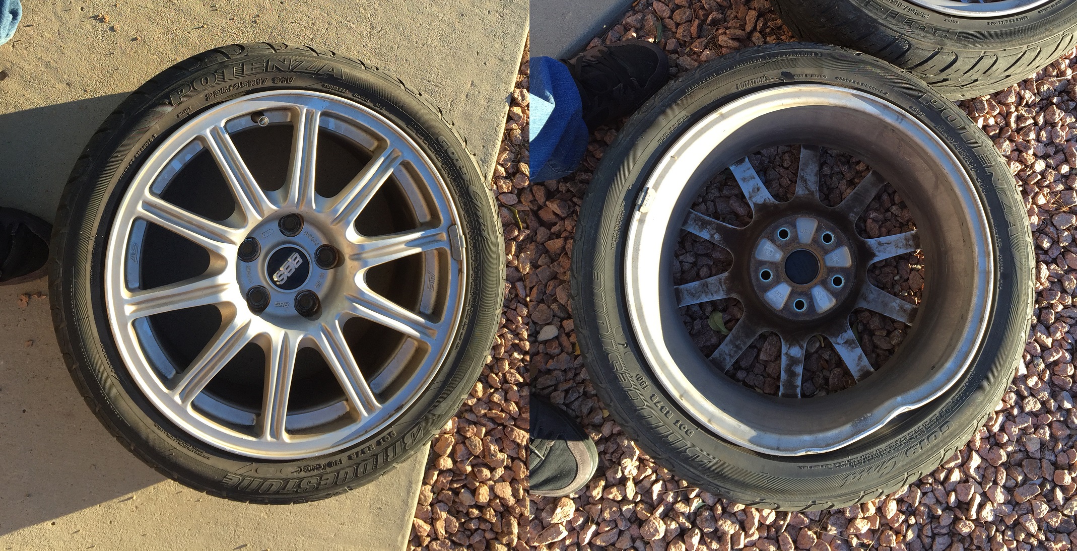

    1-9NOV2014: Alright, went to a cruise today, had some really bad luck though. Nailed a chunk of rebar and concrete that was hanging out on an exit. Destroyed both wheels on the driver’s side, and the front tire received a hole almost large enough to fist. I didn’t have the worst luck however, Bianca’s “twin” (another OBP ’06 STi but with gold BBS’ instead of silver like mine) blew their engine. Couple of the guys on the cruise convinced the owner to let me borrow 2 of his wheels (read as a temporary swap) to get me home. So now I more or less have forced my own hand at starting the 4/2 pot swap so I can run the old rally rims (and A/T tires) I had on Roxxy. So I started the swap on Tuesday night (4NOV, had to work on Sunday and Monday and it interrupted my planned starts), and as all installs seem to go, there are other irritating hiccups in the job.
    These pics are both sides of the front wheel, notice the bend in the inside end is visible from the outer-side pic (about 60* clockwise): [​IMG]DS Wheel Front by RooT1985, on Flickr
    And this is the rear wheel, outside section looked fine, inside not so much:
    [​IMG]DS Wheel Rear by RooT1985, on Flickr

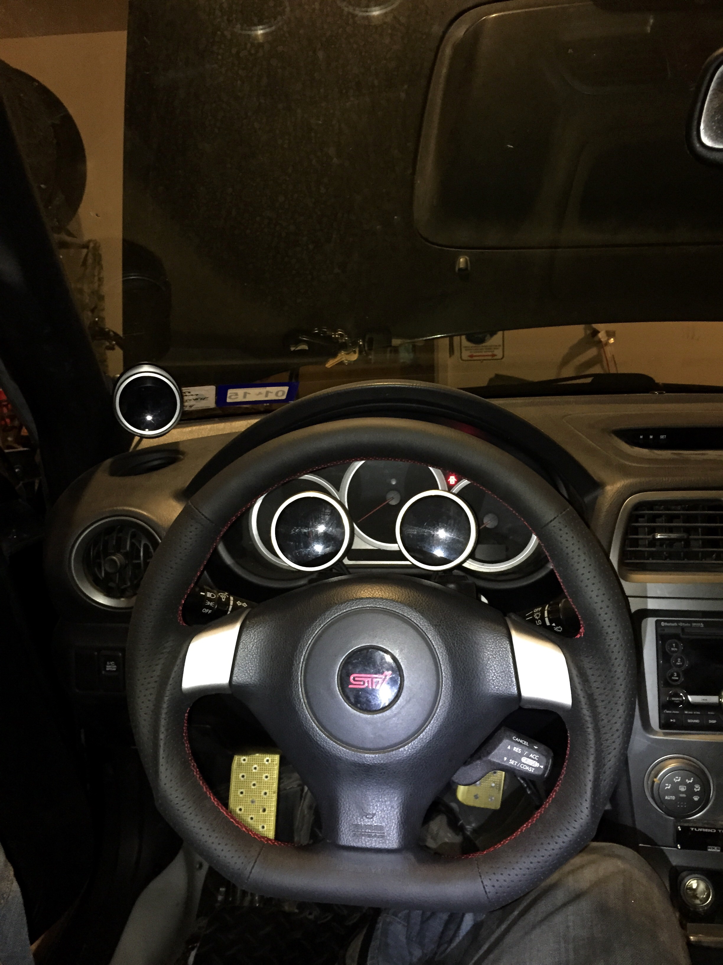

    11NOV2014: Install is complete, rebled the brakes again and did some adjustments on the brakes (like putting an extra washer on the mounting bolts for the front calipers to stop the touching between the bolt and the rotor’s face). After getting this all done I was able to finally take the car for a spin, fill the tires back up (two were sitting at ~20 PSI, one at ~10 PSI (went in the trunk as a full size spare) and the other two were sitting right below 30 PSI), and bed the brakes a bit. Unfortunately I have the symptoms of a CV joint that is on it’s way out on the front passenger side (grinding/scraping noise only on a left turn and only on one side with no evidence of rubbing anywhere). After going for a little drive I came home (inspected the front passenger side wheel at this time, again) and installed the DAMD steering wheel I had hanging out. It all looks pretty good now, love the feel of the wheel a lot.
    Here are some pics of the car at the end of all of this and the steering wheel (and surrounding area).
