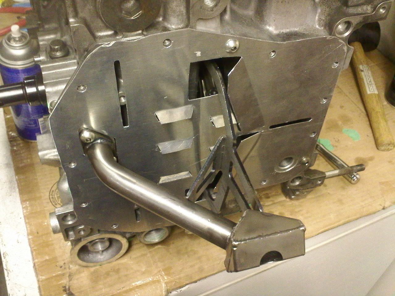

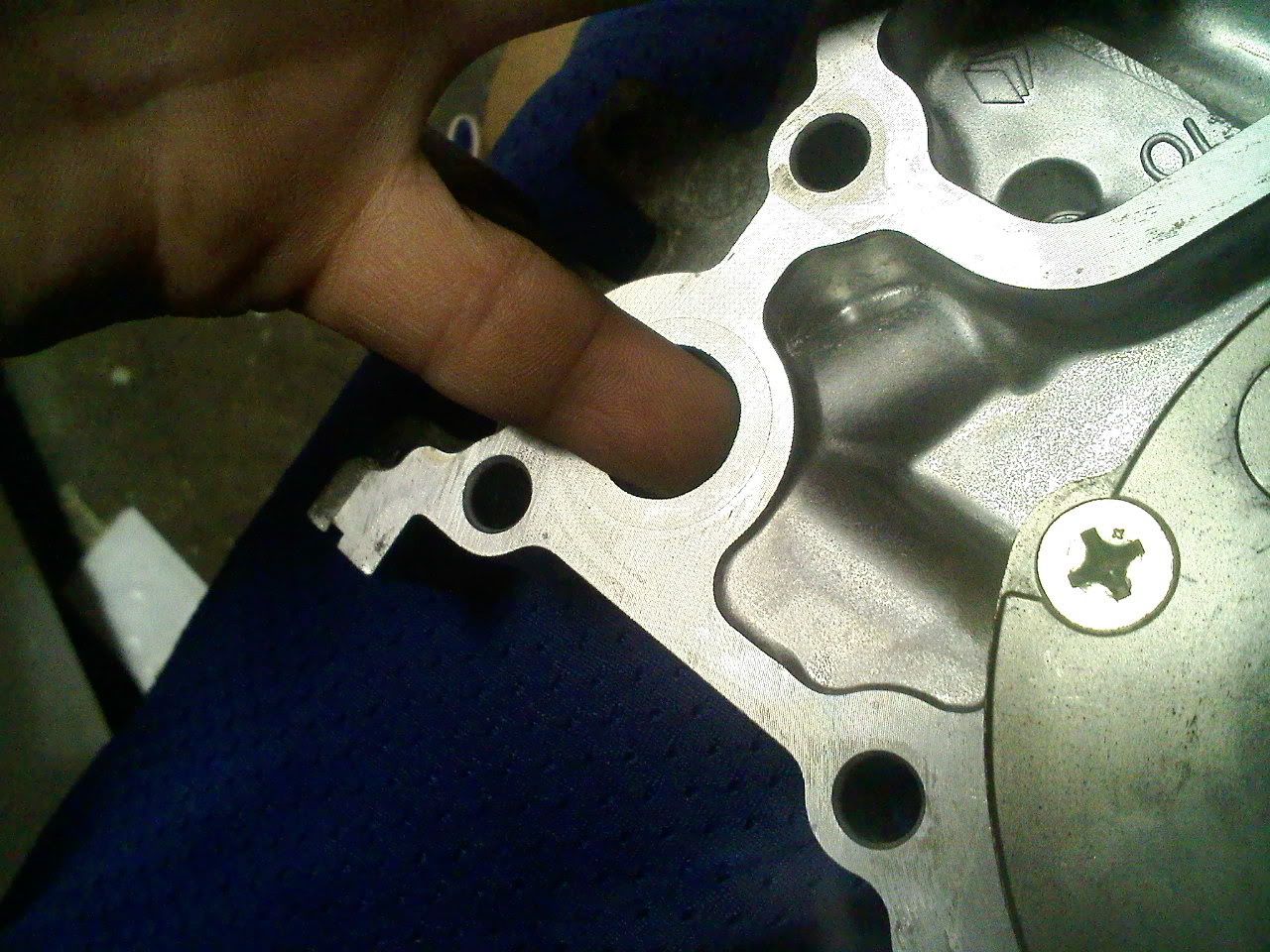

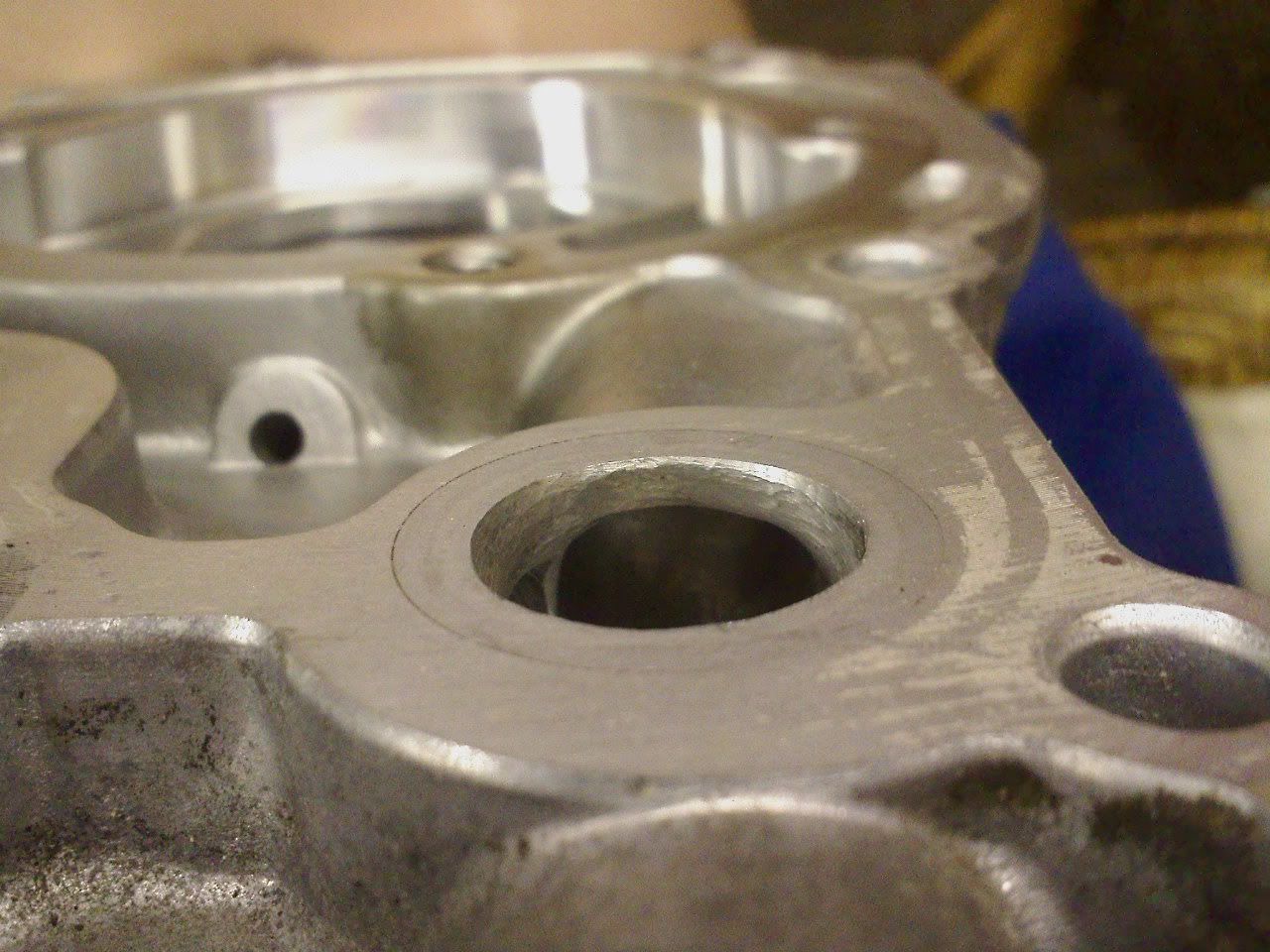

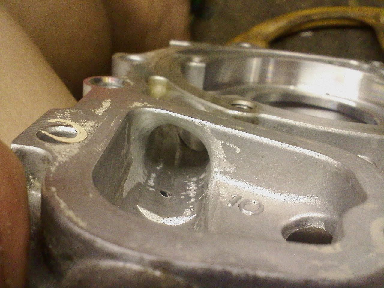

    only my finger can fit. lol Port matched, shimmed and smooth out.
    [​IMG][​IMG][​IMG]
    Much better oil control

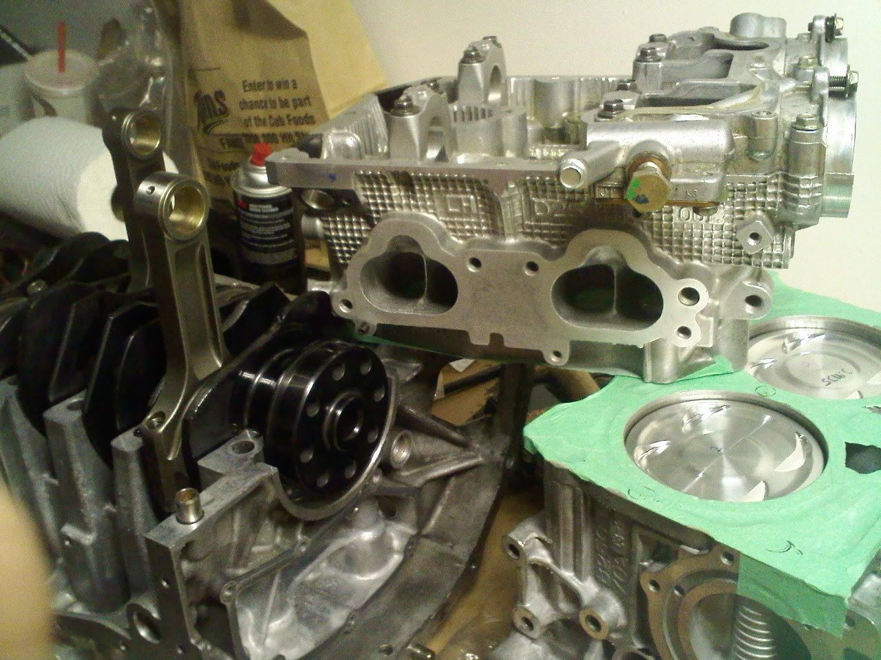

    Clouds
    Why is your crank shaft all black? Make go Faster!
    Nice Oil Control fence plate. When do we field test?

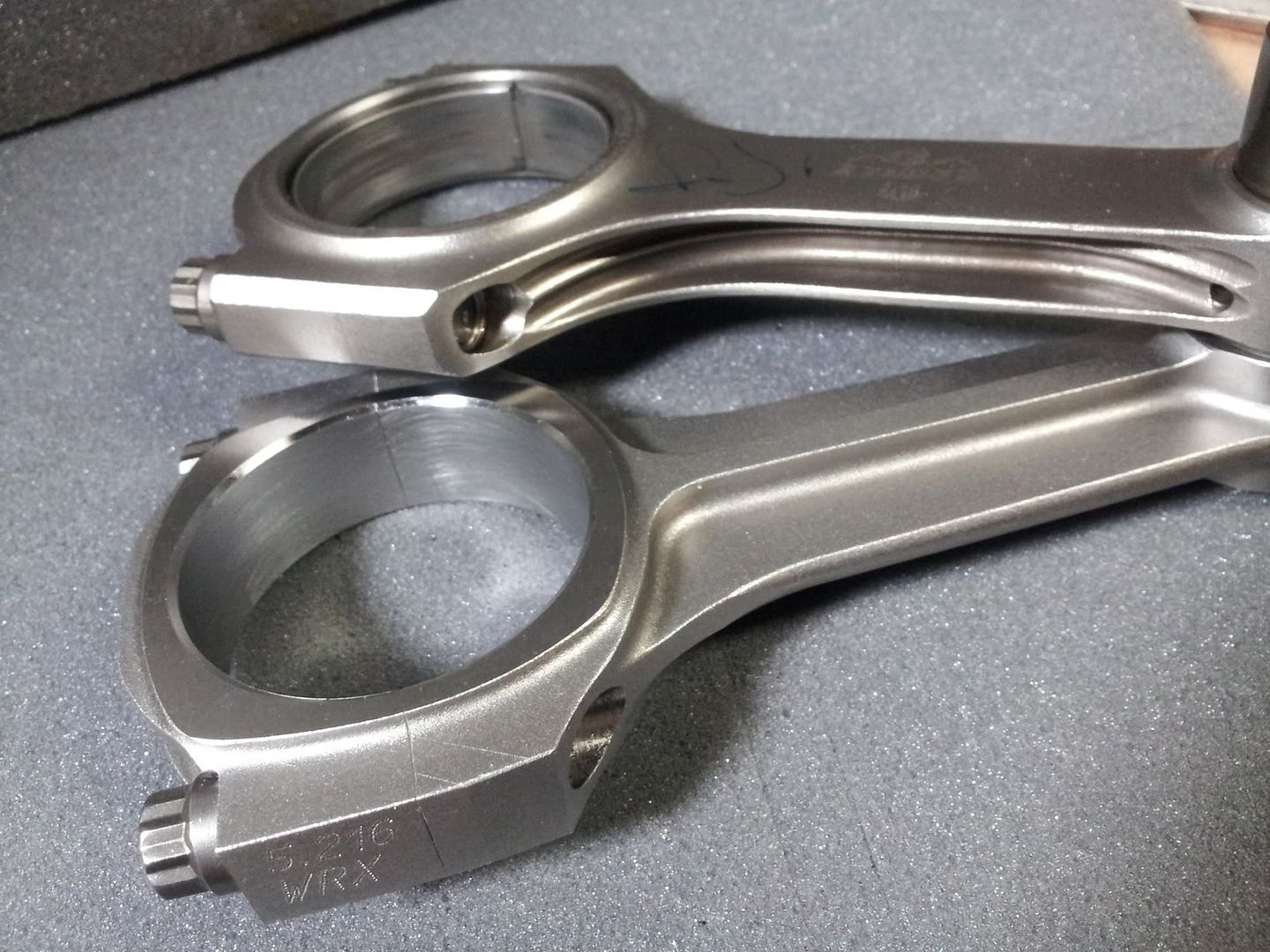

    I know it's a long-shot, but do you still have those rods?

    Yes i still have the rods. I will find done use for them if no one buys them.

    Eagle rods, lightest Subaru rods you can buy, good option if you want to keep mass to a minimum.
