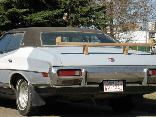

    Well, when I built my spoiler with treated 2x4's...
