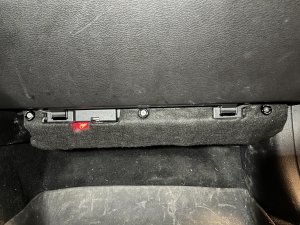

  21. obsolete
    obsolete Well-Known Member
    55
    Yeah, what's up with that? It even looks like there's supposed to be one:
    Superglue likes this.

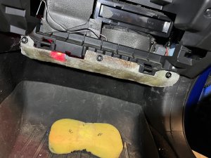

  25. Superglue
    Superglue Well-Known Member
    48
    @predavore I have my old one lying around you can have it. from an 11' sti but they should all be the same. I'll bring it to ya and help you install it.
    @Krazylegz1485 Yeah agreed on all the online ordering bs. just buy the cheapest, or sometimes the middle ground one, just because they're all the same.
    @obsolete I hadn't noticed those little notches before....
    Once I get bored. i.e. tomorrow I'll try to go to the drawing board to fabricate something up and see what it looks like.

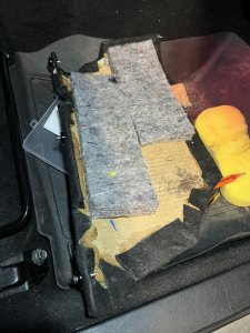

  26. obsolete
    55
    Yeah, looks like the 3 holes there were intended for plastic push pins. A curved/creased sheet of something cut to the right shape, with holes that line up, would be the minimum viable product. Maybe some 3D-printed brackets to take care of the angle, then the filler piece wouldn't even have to bend/curve much. Definitely doable.

  29. Superglue
    48
    that’s a great point lol!
    I have some fiberglass and I’m probably going to tackle it this week, with another project. Going to try to find some hooks at the hardware store and mount it all up

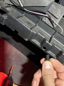

  34. Superglue
    48
    Was working on some fiberglass and figured I'd tackle this! Finally! opted to use the holes instead of the clip spots and I had these little expansion plugs laying around. bored out the hole a little so it'd fit an M4/M5 instead of a little M3. fiberglass looks like heck, but it works. had some felt mat laying around that I glued to it, so it actually looks pretty nice! Though I'll get sick of the light not matching up right and I wish the angle was a little steeper so that it'd drop lower and give more space for the sound absorbing material. used some quick insulation type material for the time being.
