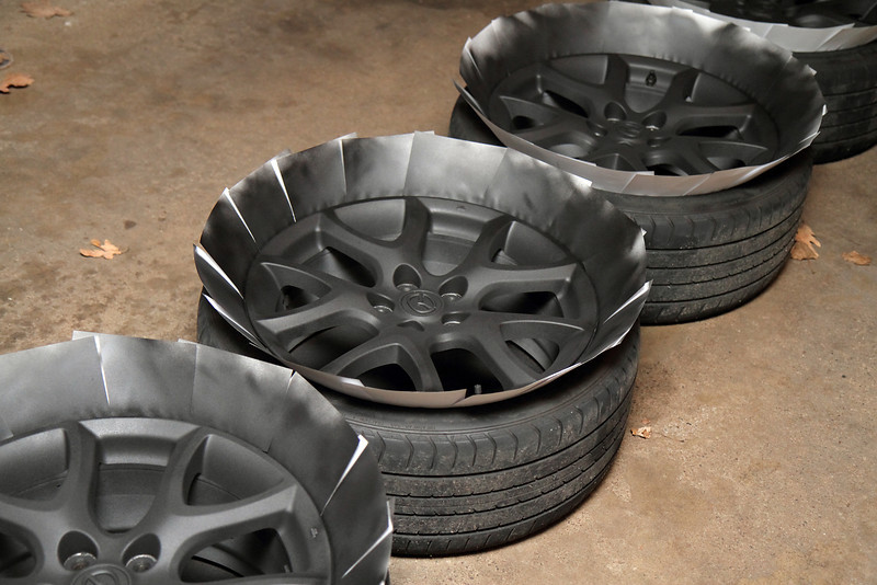

    dipped my wheels 2 or 3 weeks ago. if your doing it outside do not do it when its below 45 degrees. it gets air bubbles and doesnt spray well or lay on the rim very good either. i did 2 rims in my garage which was heated and you can tell what 2 were done in cold and the 2 that were done inside the garage in the heat. plus the tip stayed alot cleaner and sprayed better when warm.
    also for everyone else. make sure to get 4 cans. 1 can for 2 wheels will not do very good for you. and if your doing it with nice tires on your car use note cards in the edge of the rim. tape takes twice as long and note cards do the job better IMO. plus its cheaper than tape!

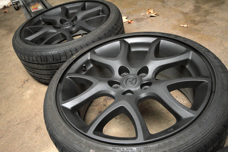

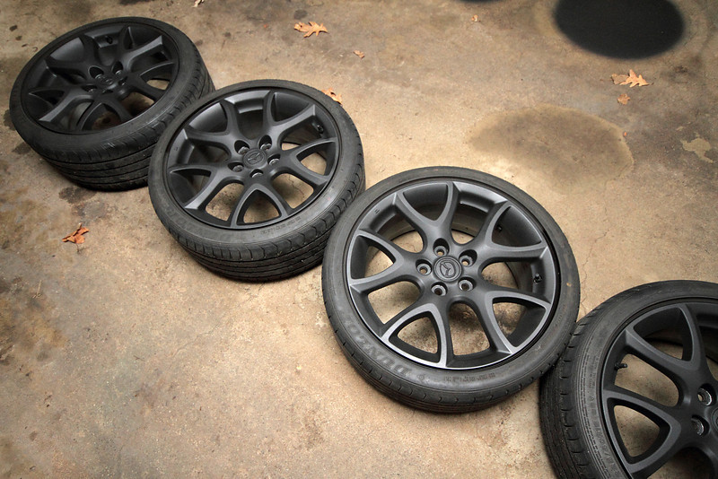

  9. xluben
    I did my brother's MS3 wheels exactly the same way. Probably close to 10 light coats and it was only 2 cans.

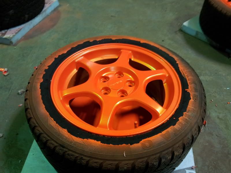

  15. Grayguy
    Grayguy Well-Known Member
    I didn't mask mine and it was TERRIBLE! My hakkas have so much patterened texture on the side walls that I ended up scrubbing the over spray off with a wire brush and paint thinner.

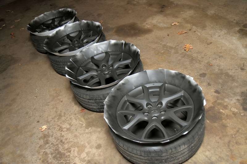

  17. xluben
    Using index cards like my photos above is likely less time than removing the Plasti Dip overspray (even if it does come off easily). The index card method is really next to zero effort and works great.

  18. Ctracey218
    Yeah, in hindsight, I would have much rather kept them taped off, but... Well, chubbywrx (Nate) said "we should be fine, giver hell" and well, the rest is painful history..
  19. Grayguy
    Dam you nate!
    As the pic shows, the over spray just was terrible to peel off the textury part
  20. xluben
    Fail. Use the index cards.
