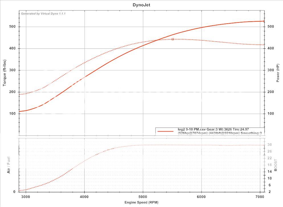

    Damn! that is a nice flat boost curve up top!

    You not suppose to post up anything!!! jk...
    Can't wait to see what I can push out with rods & cams

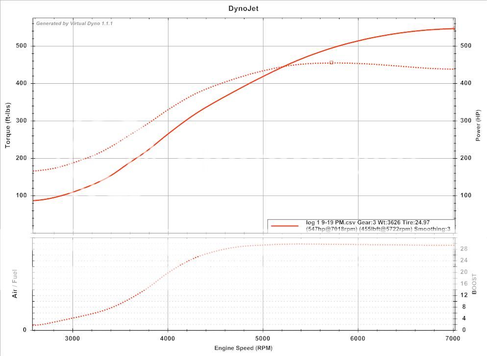

    I officially messed with it, I don't think I'll be doing 25 minjute sessions on this one :eek:[​IMG]

    There's reason Nuke is smart with our cars. I think I almost gave him a heart attack with this one! He just doesn't want to see it sitting on the side of the road. There's risk with my eagle rods being H-beams which have have snapped for other guys in EJ's, and one tune obviously doesn't fit every application...this should be fine for the 1/4 mile and messing around on the street. It even sounds like we could squeeze another half of a degree out of redline if we wanted. However, as soon as I head for BIR, whenever that is, I'm going to reflash to the less aggressive map.
    Honestly it's my curiousity and desire to learn which is our biggest risk with this car. But it's just like wrenching on your own car, it makes everything so much more rewarding! (Until it breaks, but that's all part of the learning process ;))

    Doesn't torque bend rods? Or is it torque at high RPM that does them in?
    I don't know if breaking things is quite as much fun as you make it sound...
  23. Juks
    Juks Well-Known Member
    257
    87
    Prior Lake
    Sounds like cylinder pressure is a big concern, which too much timing contributes to. Not sure if we need to worry about torque or horse, but if you're that close I think we're splitting hairs. I'll be going to I-beams over the winter hopefully so it'll be a concern of the past.
    Breaking things, or just straight up failures usually sucks at the time...but with a certain amount of time, the learning experience is usually worth it. Lesson learned for me is if your toy is the only way you can get to work, you better have a plan B in your back pocket!

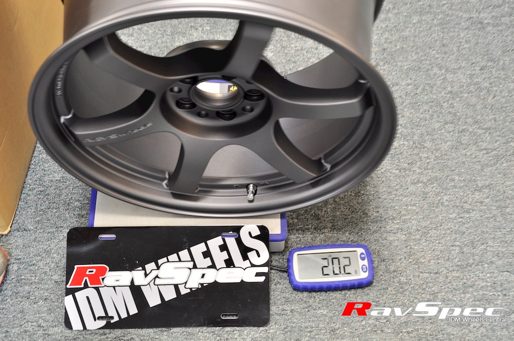

    I really like the look of the Gram Light 57DR. Do you have an 04 STI? If so, they seem to have group buy's for them once in a while. They're pretty cheap compared to other options.
    http://forums.nasioc.com/forums/showthread.php?t=2292565
    They look pretty awesome. I was very close to getting them for my car.
    Only downside is they're not super light. Around 20lbs for the 17x9" size. Considerably heavier than your BBS.

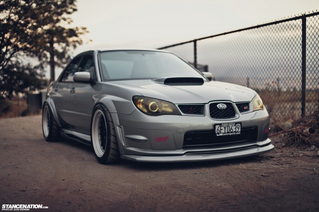

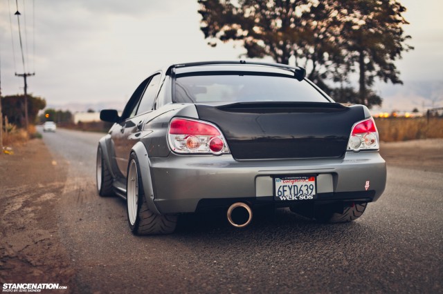

    You don't need power to break anything, it's poor technique or some would call it "bad driving."
    I know which road you're headed, you should just consider buying 17x+10. And should start wearing tires at least 265 minimum and 285 for track duty. I know your style Capt. Wax on, then hammer down lol

    Hmm...that would be fun on the track, that's for sure! What kind of offset would you use for a 10" wide rim? Any idea what would have to be done to make those things fit?
  43. Nuke
    6,155
    Saint Paul
    pull the hell outta those fenders or widebody kit
    i say...widebody y0
