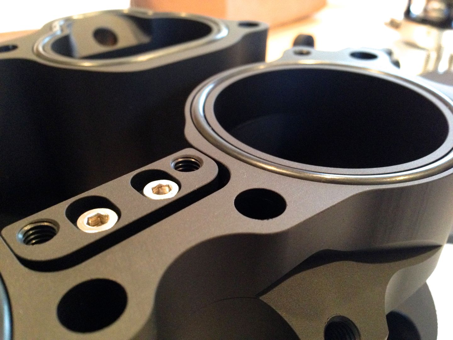

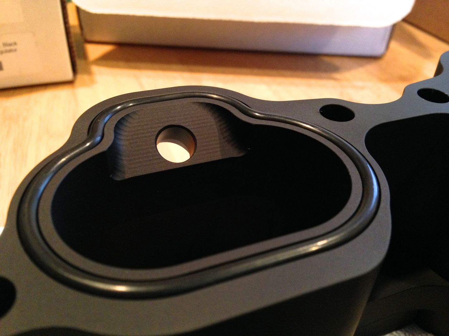

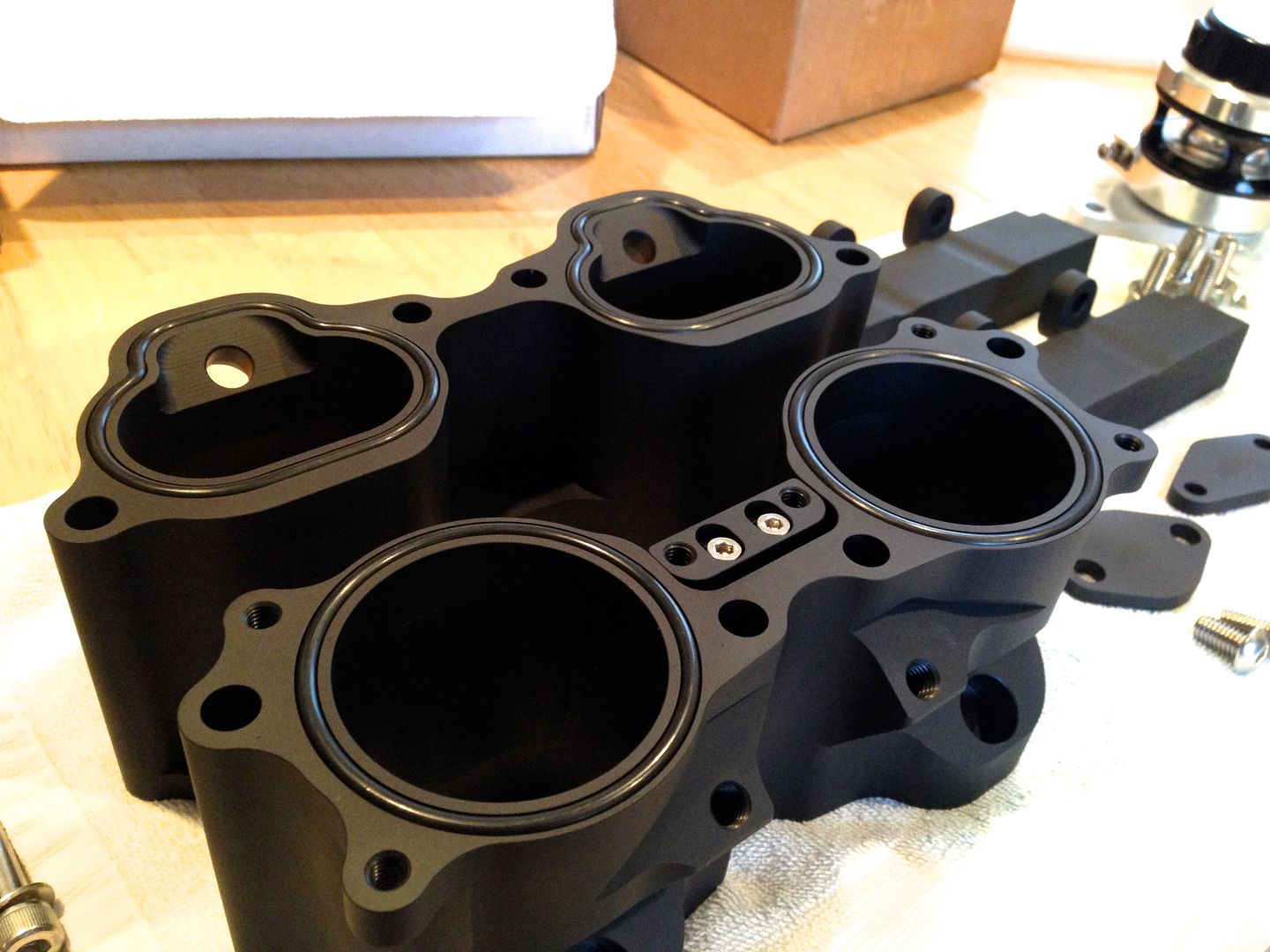

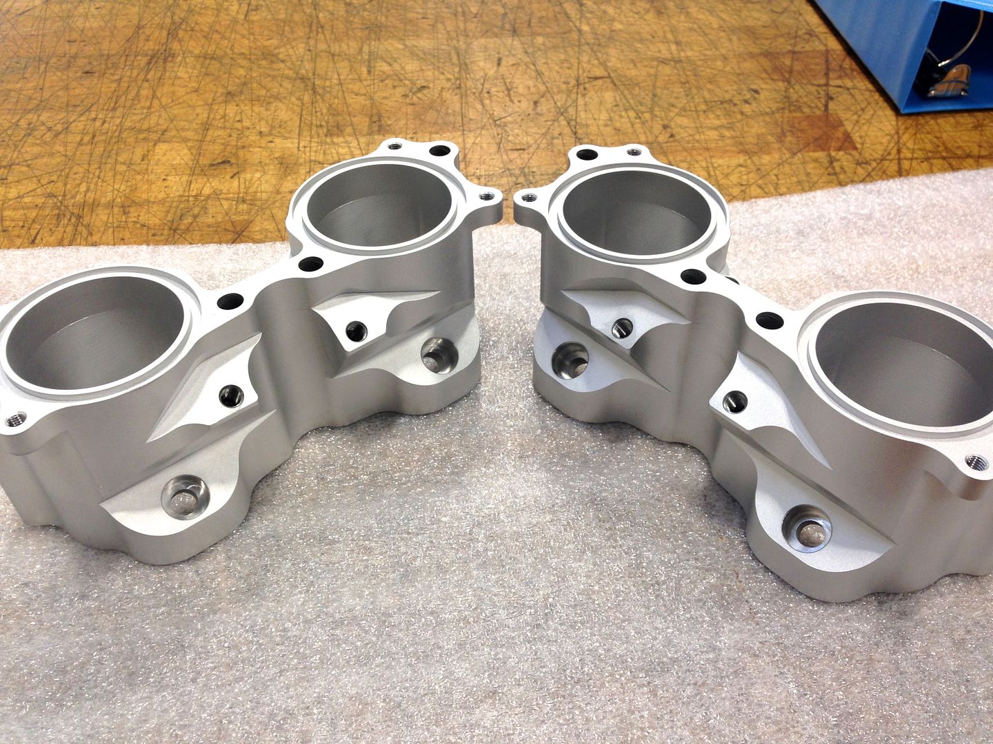

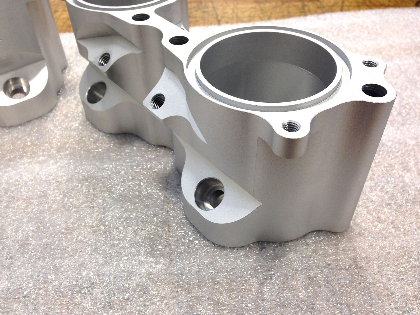

    I have started to dream up an intake manifold. A billet manifold with no welds will be a challenge but just like the tumblers they turned out great.
    IAG made "one" for the BRZ/FRS using a roots supercharger.

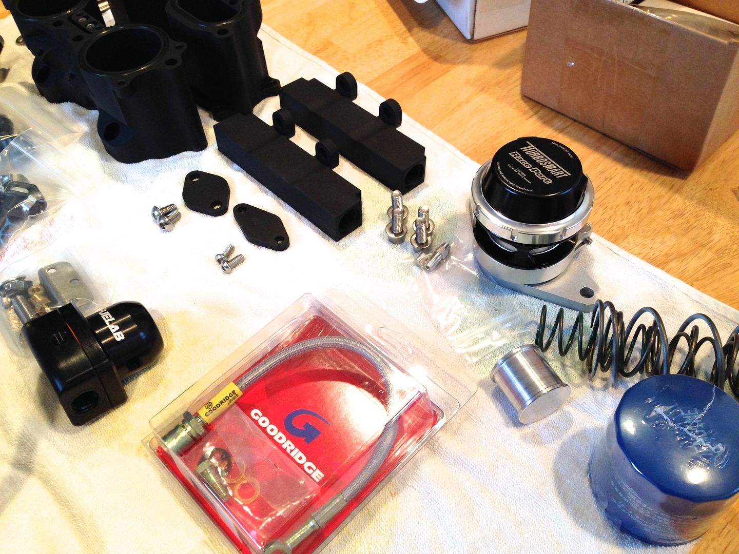

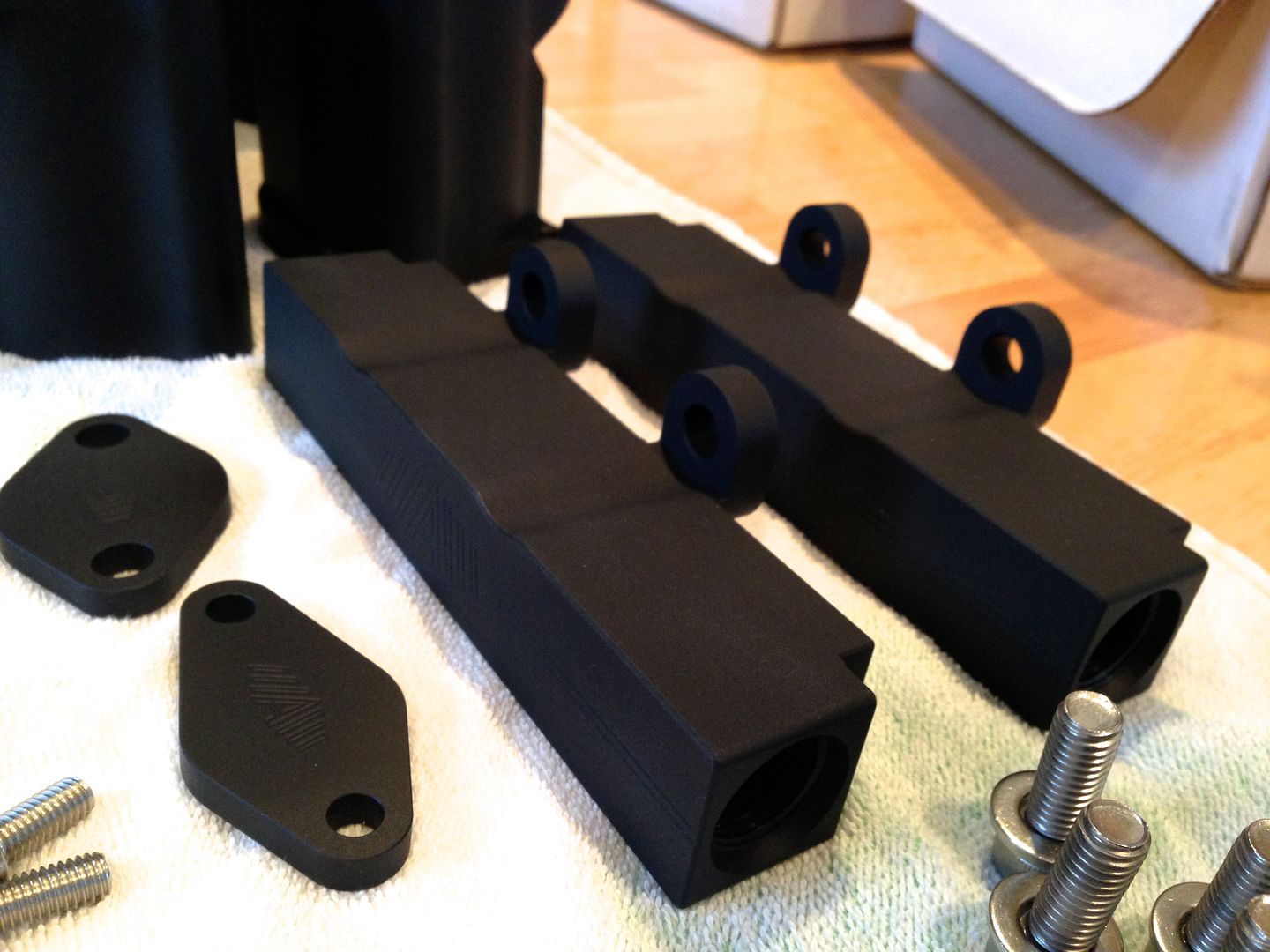

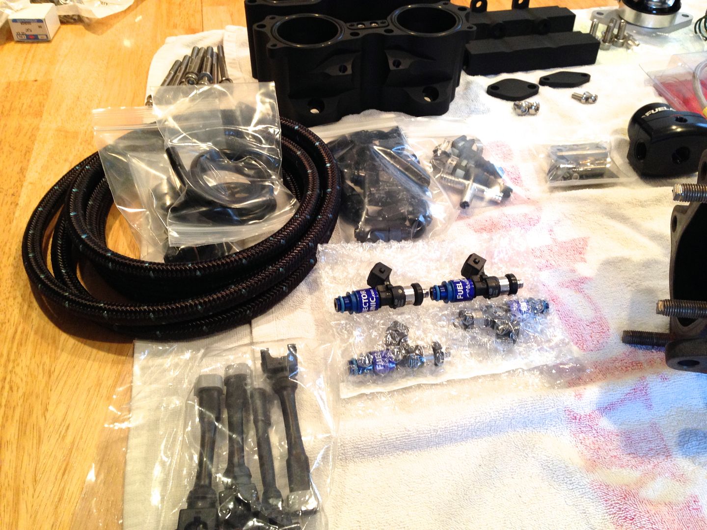

    I got my parts back from anodizing today. My car will be dropped off Thursday for the rebuild.

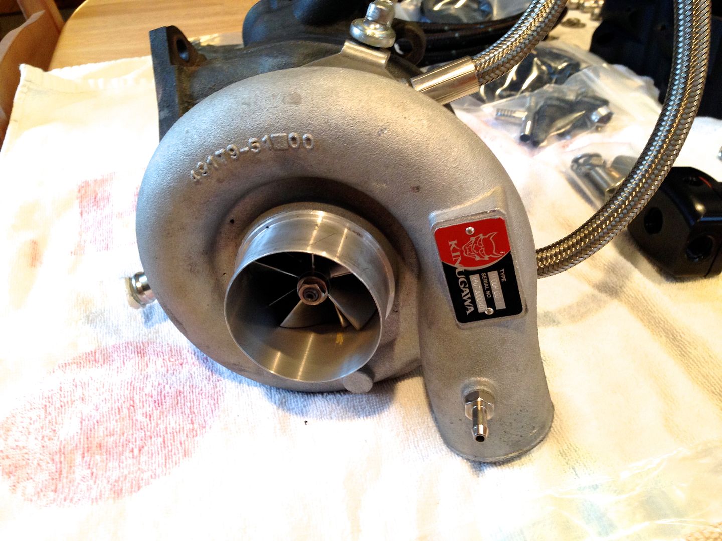

    Built motor (bore/hone 99.75mm, balancing, JE pistons, upgraded wrist pins, Turbo Tuff I Beam rods, upgraded rod and main bearings, new OEM crankshaft, ARP headstuds)
    GSC Beehive valve springs (rev out to 8k, otherwise heads are stock)
    Fx500 clutch ( I think thats what i ordered lol)
    Kinugawa 60-1 turbo (60mm)

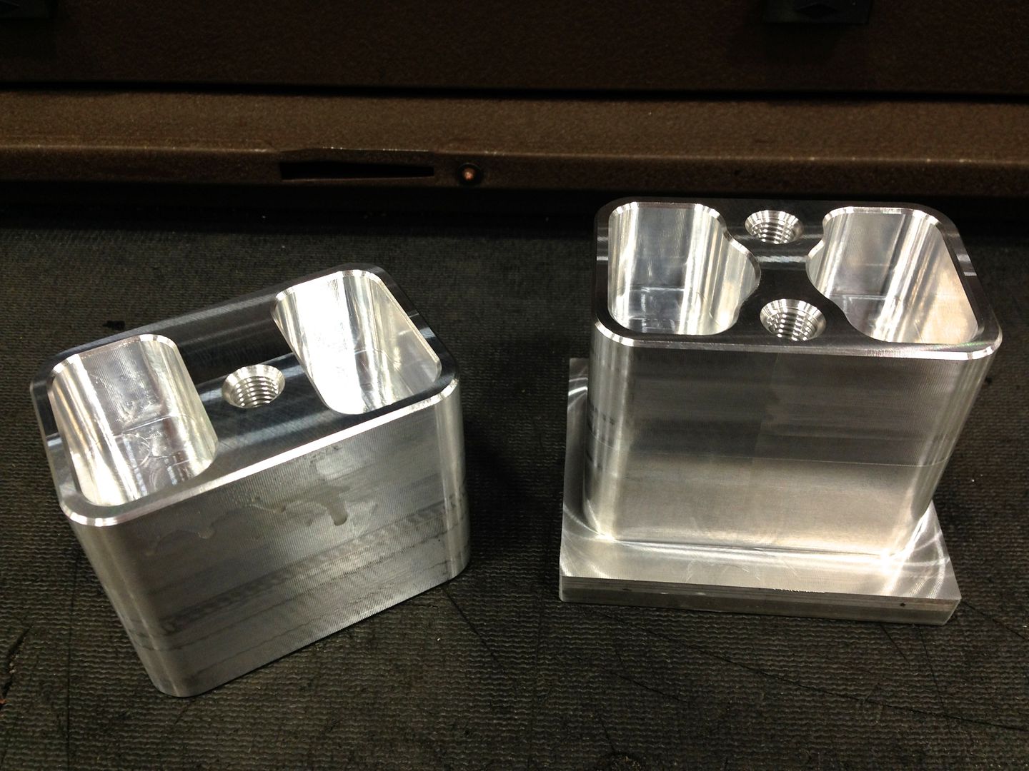

    Aluminati tumblers (tgv deleted)
    Aluminati fuel rails
    Aluminati block off plates (air pump delete)
    IAG fuel rail line/fitting kit
    Fuel Lab FPR
    Turbosmart RacePort BOV
    FIC 1650cc injectors
    Killer B oil pickup
    Thermal Zero turbo blanket
    Goodridge SS clutch line
    Torque Solutions inlet plug
    One step colder spark plugs

    I do not for see any issues with the tumblers but want to install them on my car first, then make more :) What's your timeline for these?

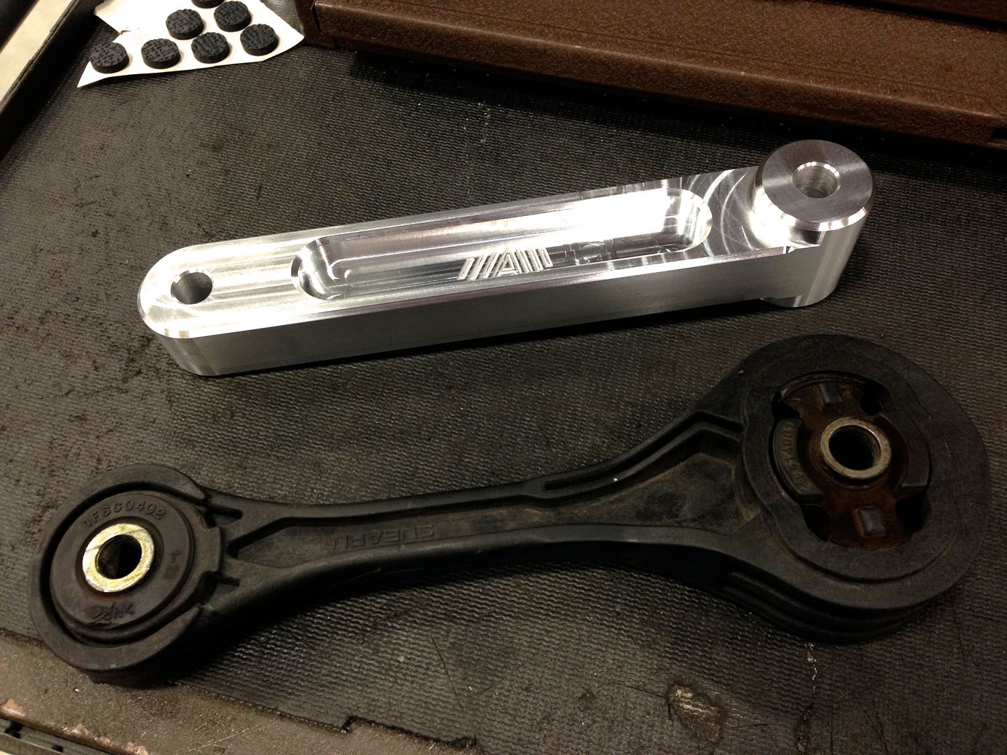

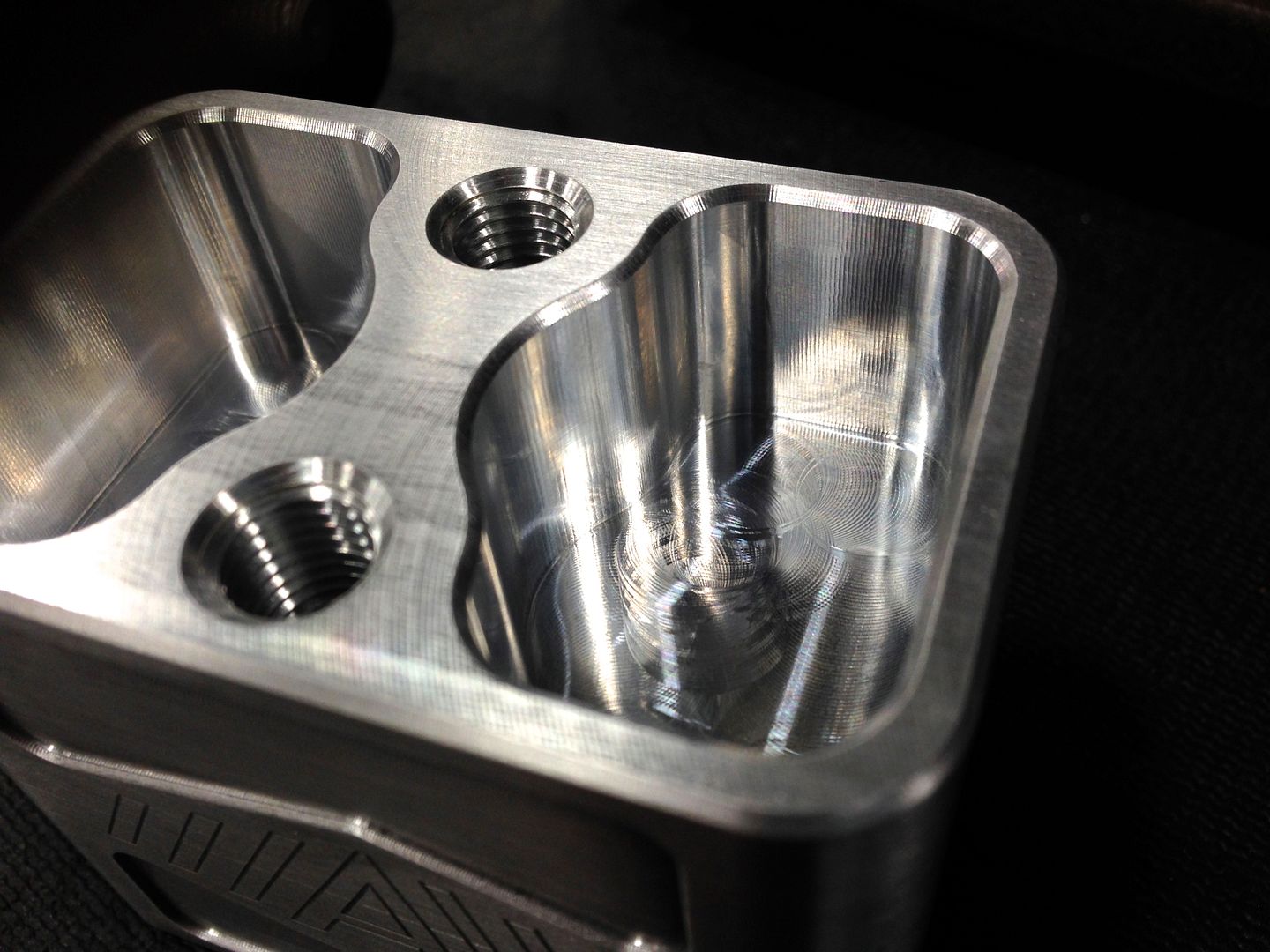

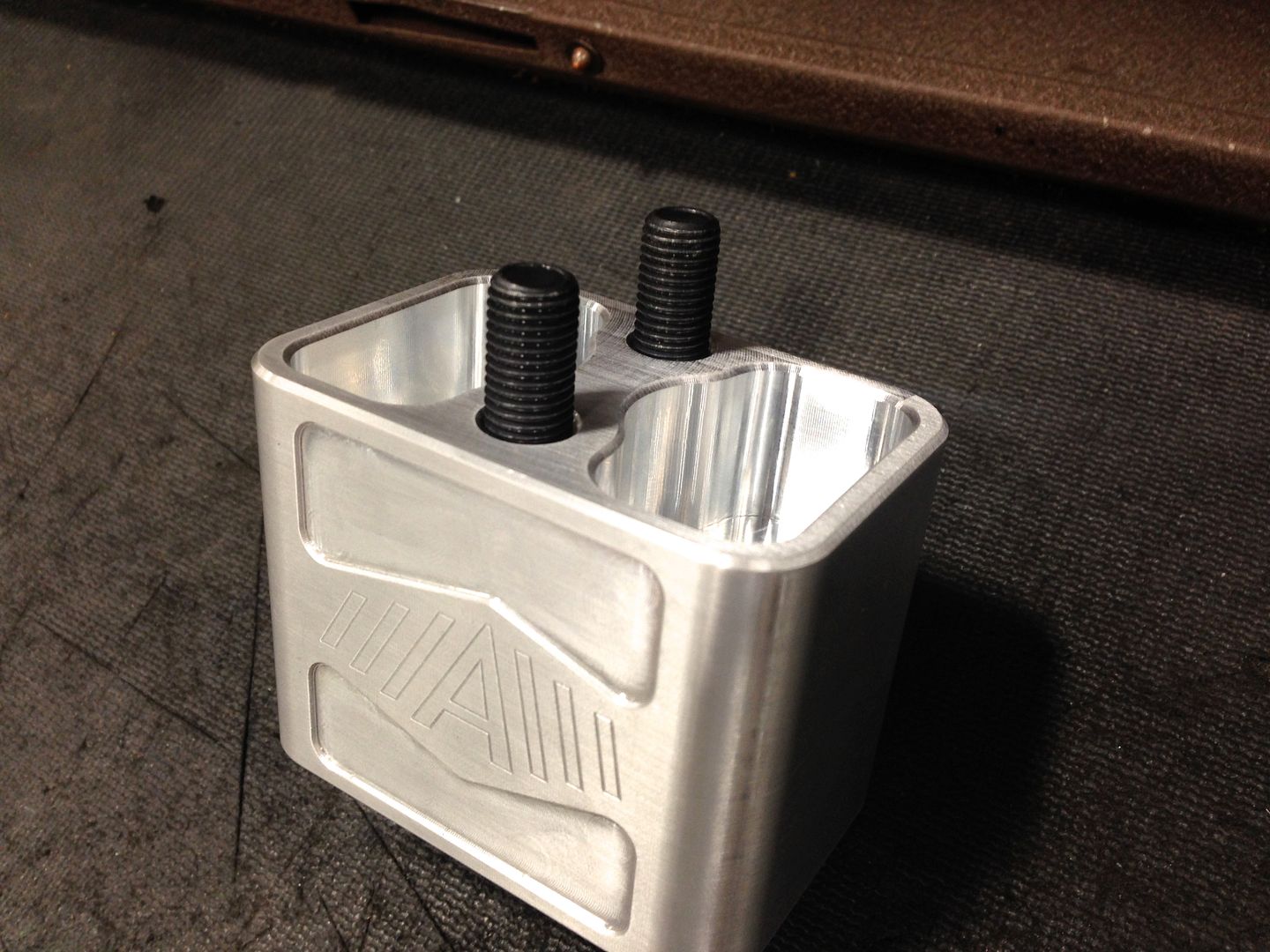

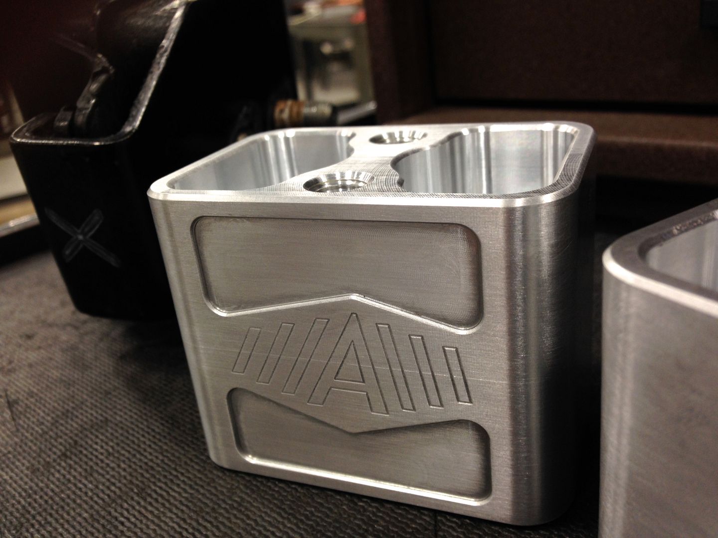

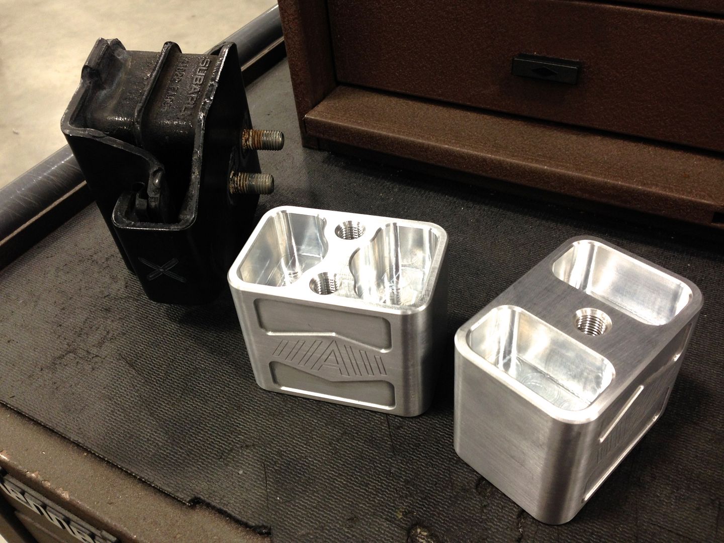

    I have been making some solid mounts for someone and thought i would share. So far i have made the pitch stop and motor mounts, soon i'll make a transmission mount. The motor mounts will have threaded studs installed after anodizing.

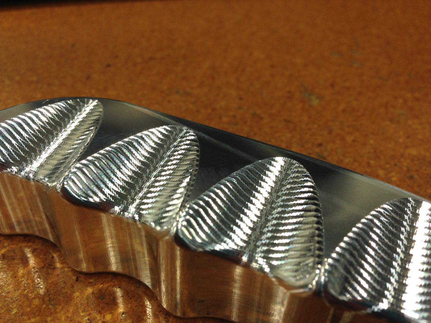

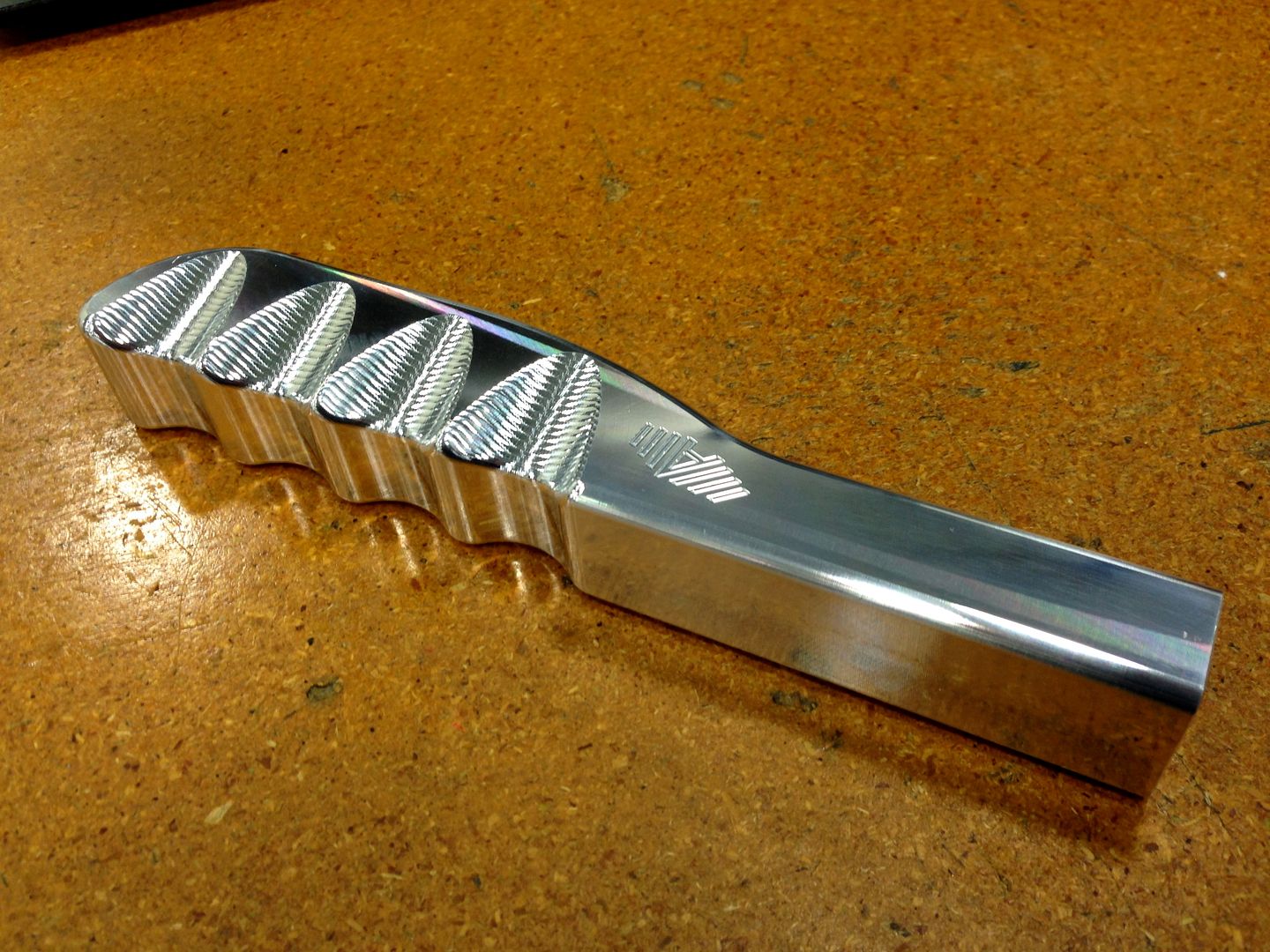

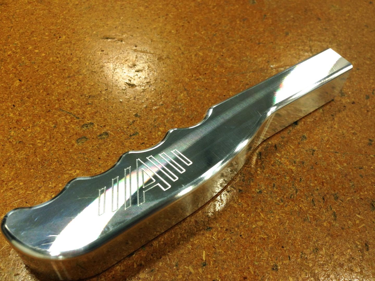

    Installed studs into the motor mounts to make sure there was enough thread when seated, these will be re installed after anodizing and locked in with thread lock.

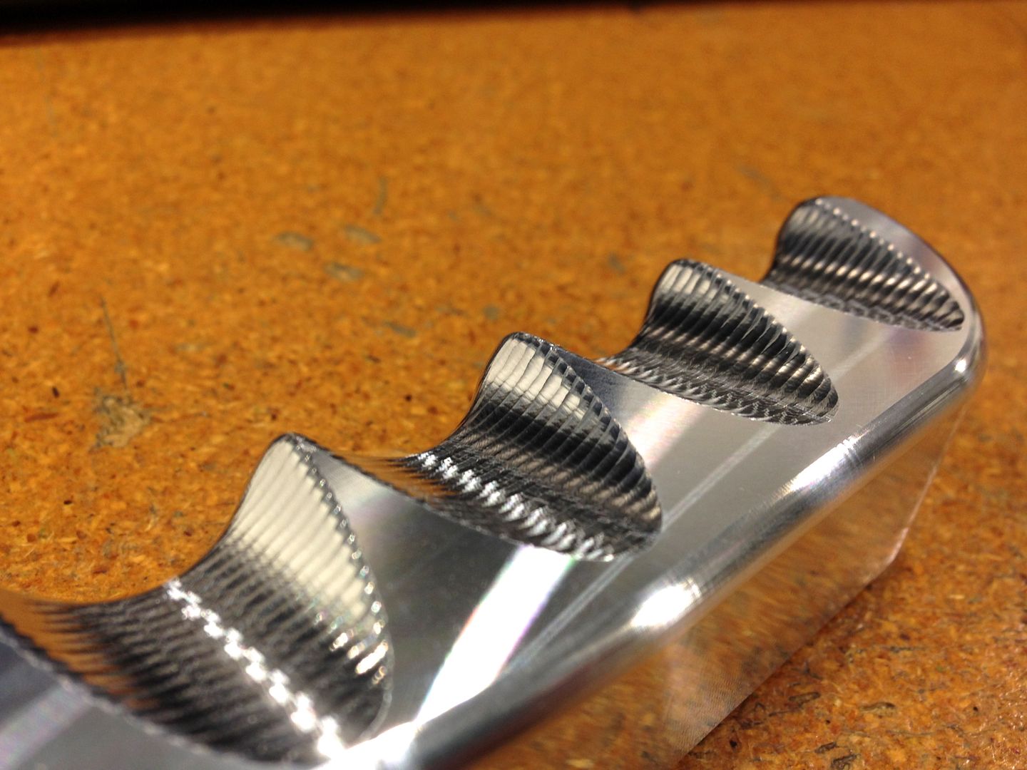

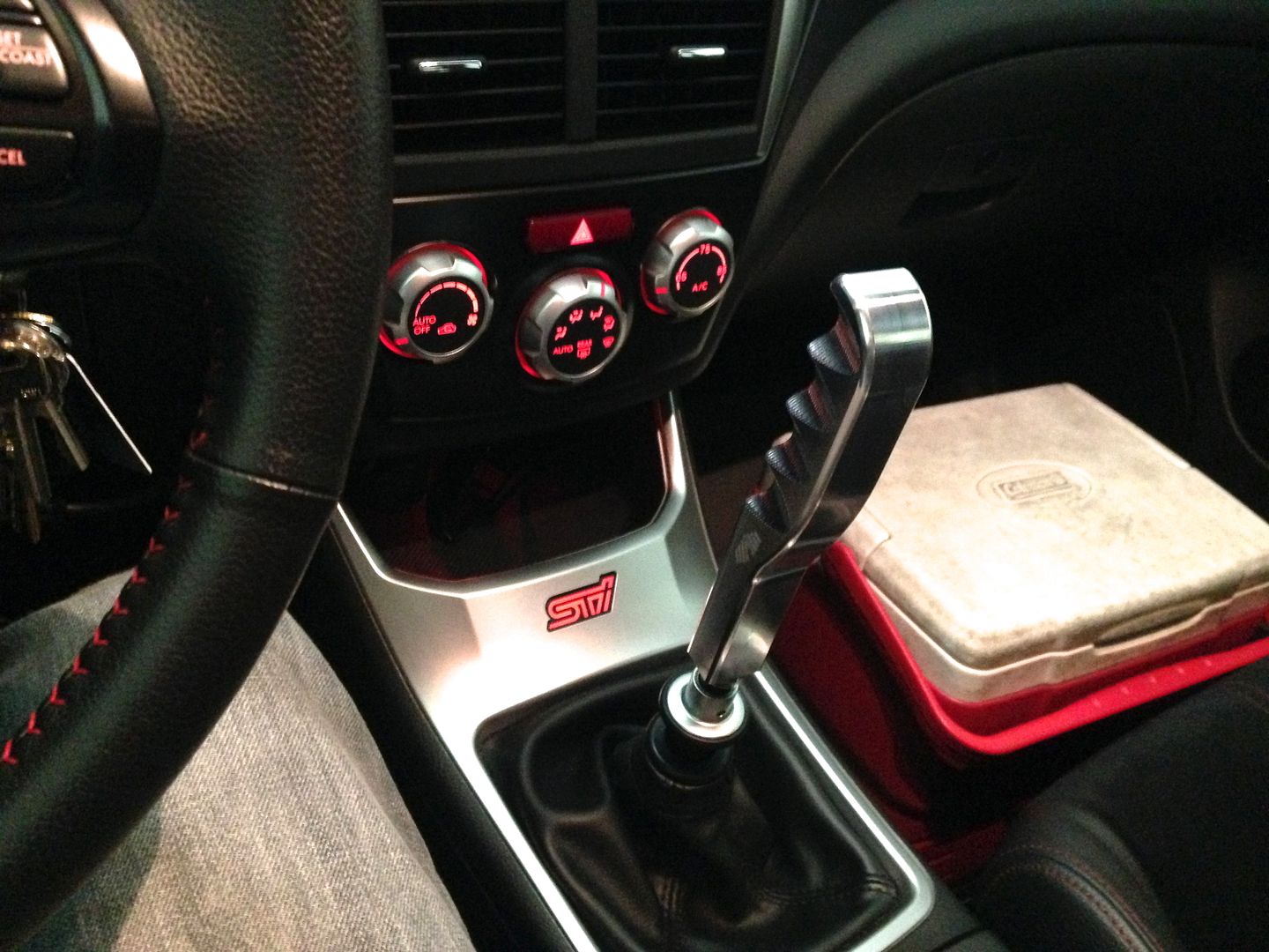

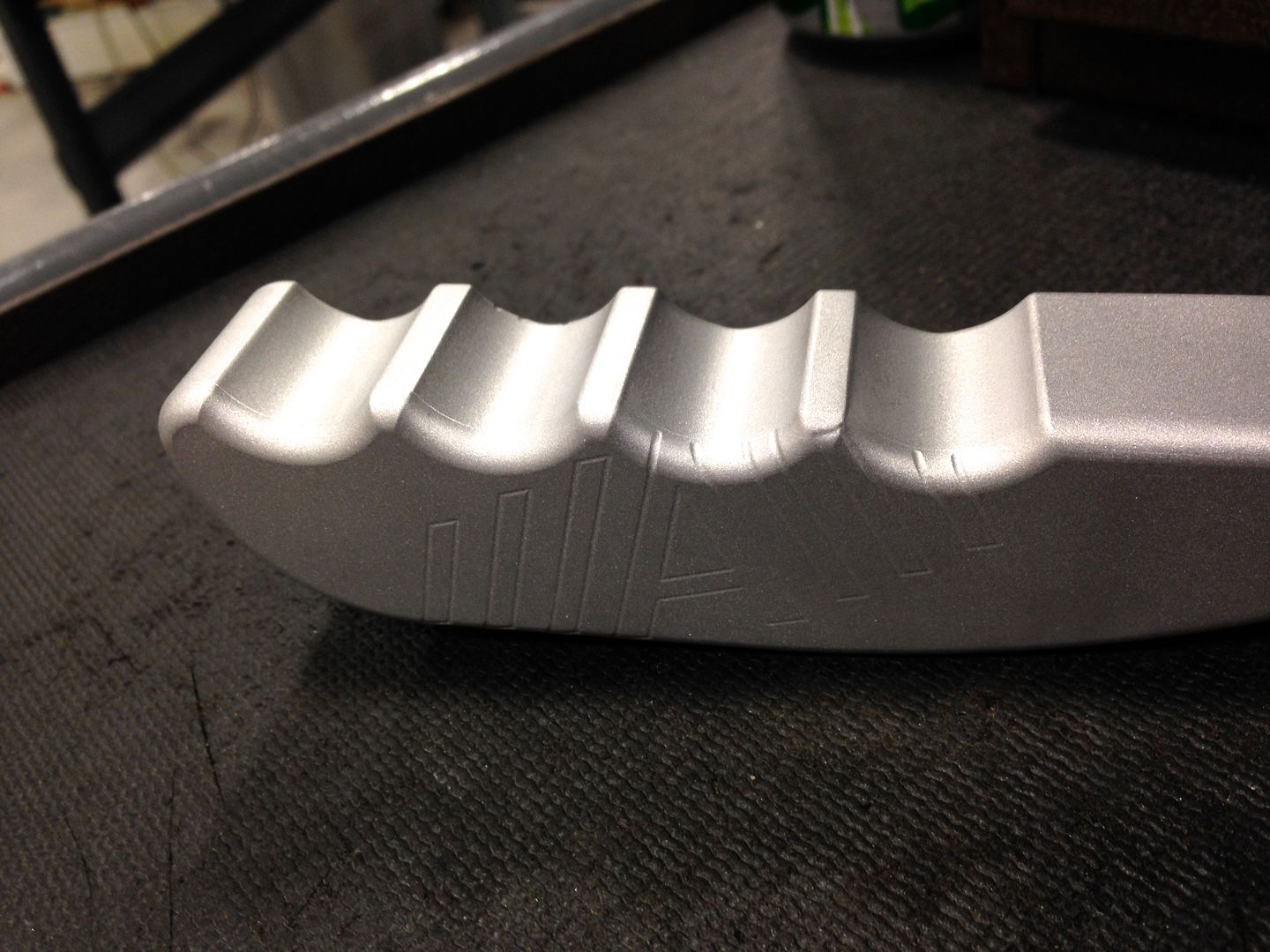

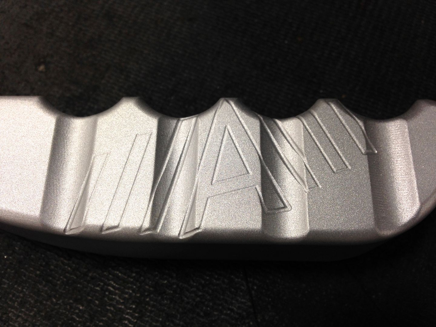

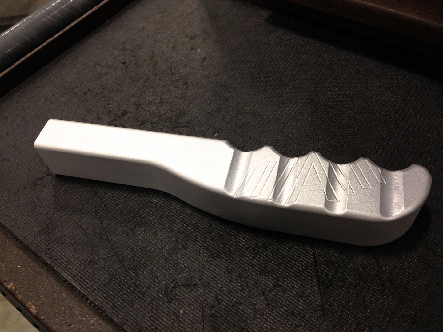

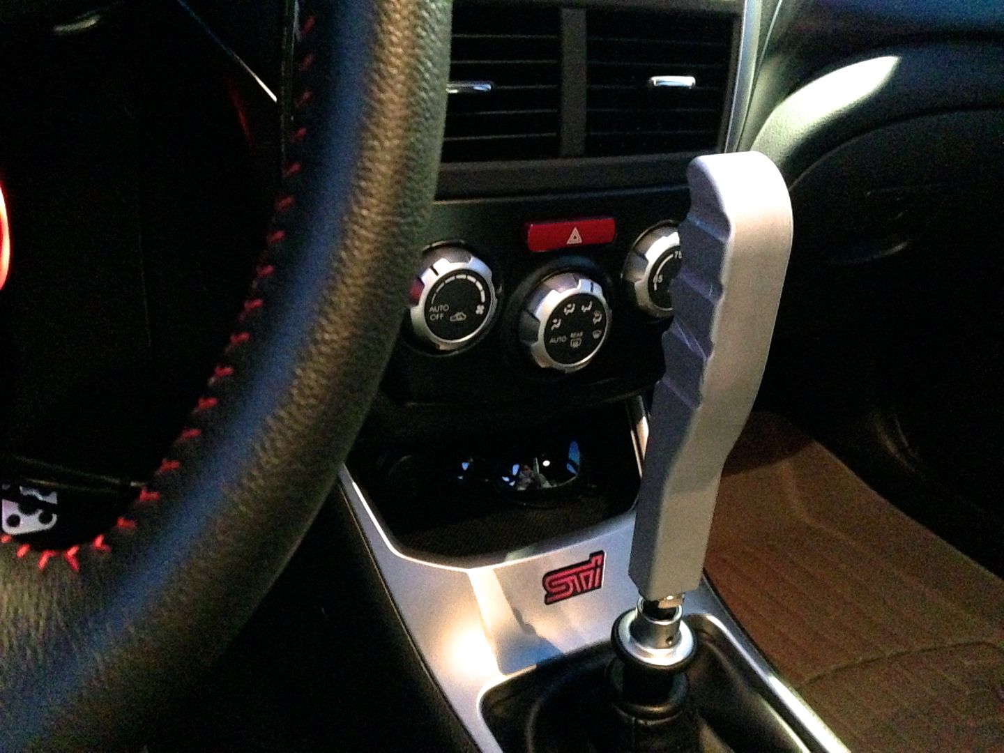

    Also made a new shift handle :) I love how it feels, just amazing! Thought the engraving was a nice touch.

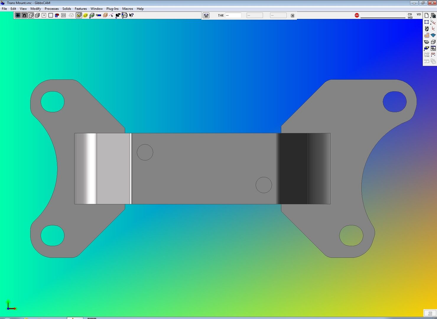

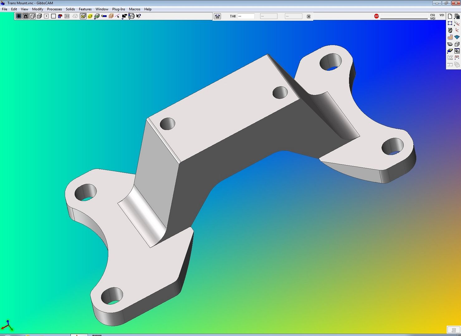

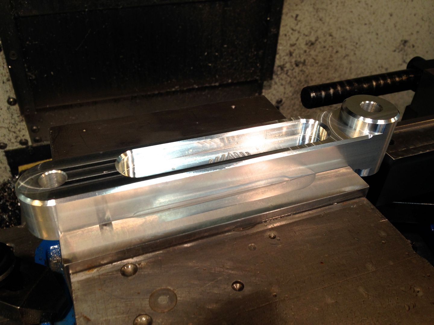

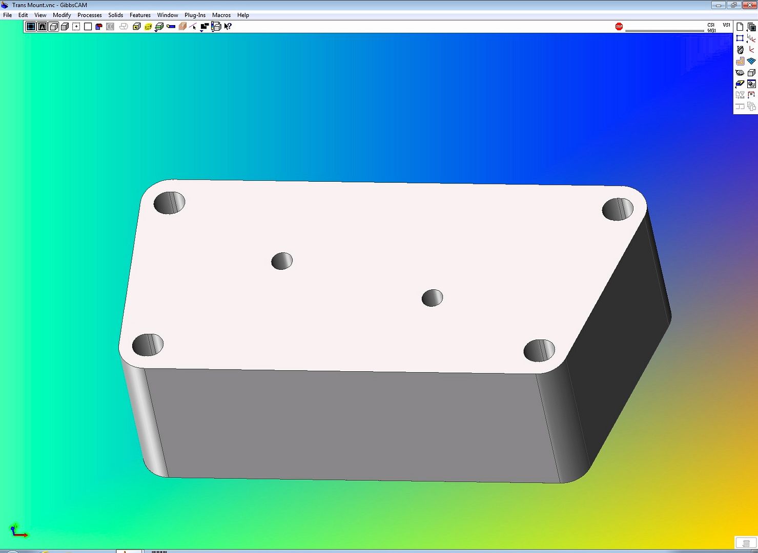

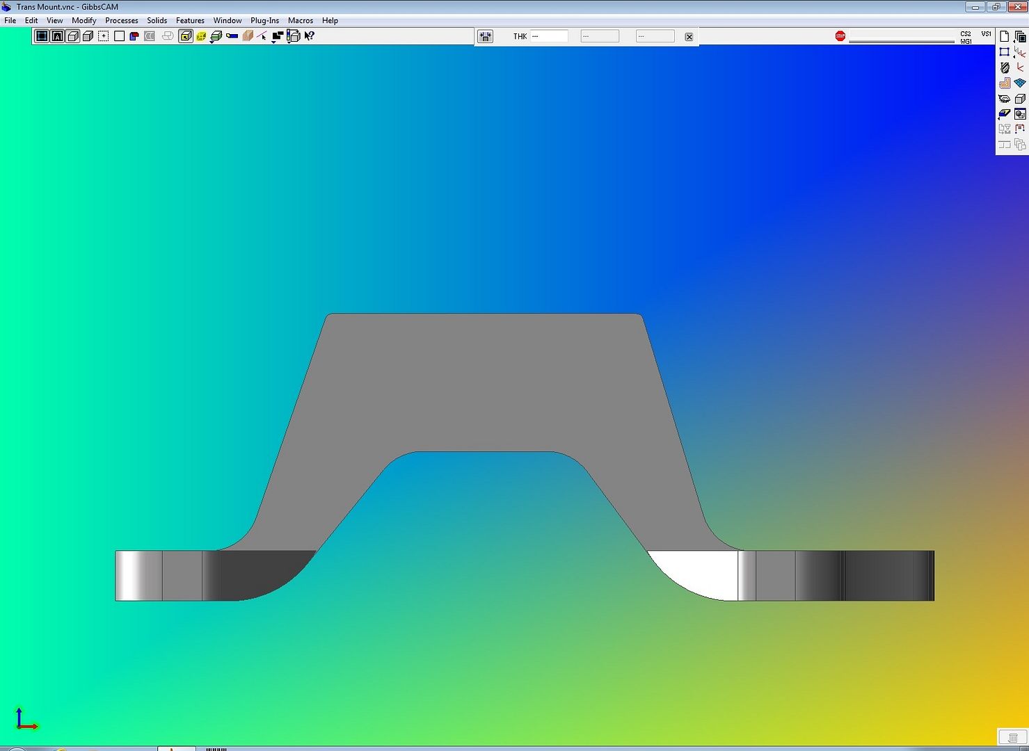

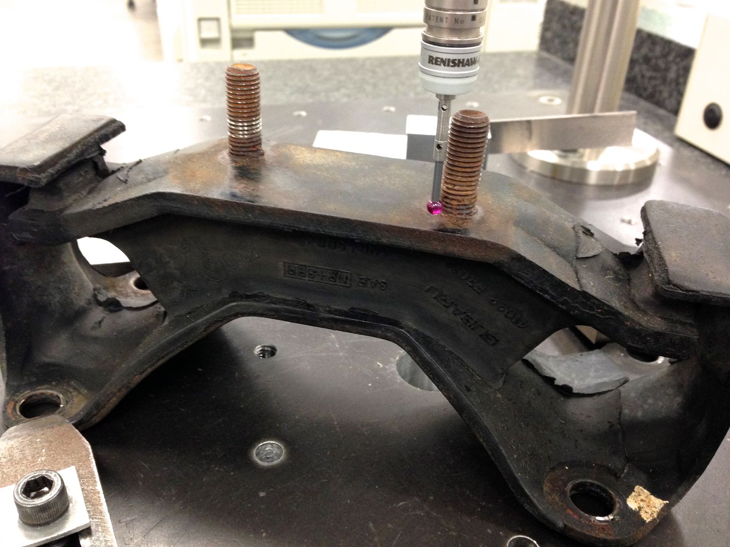

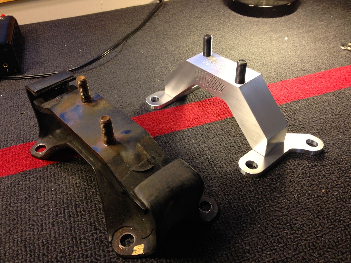

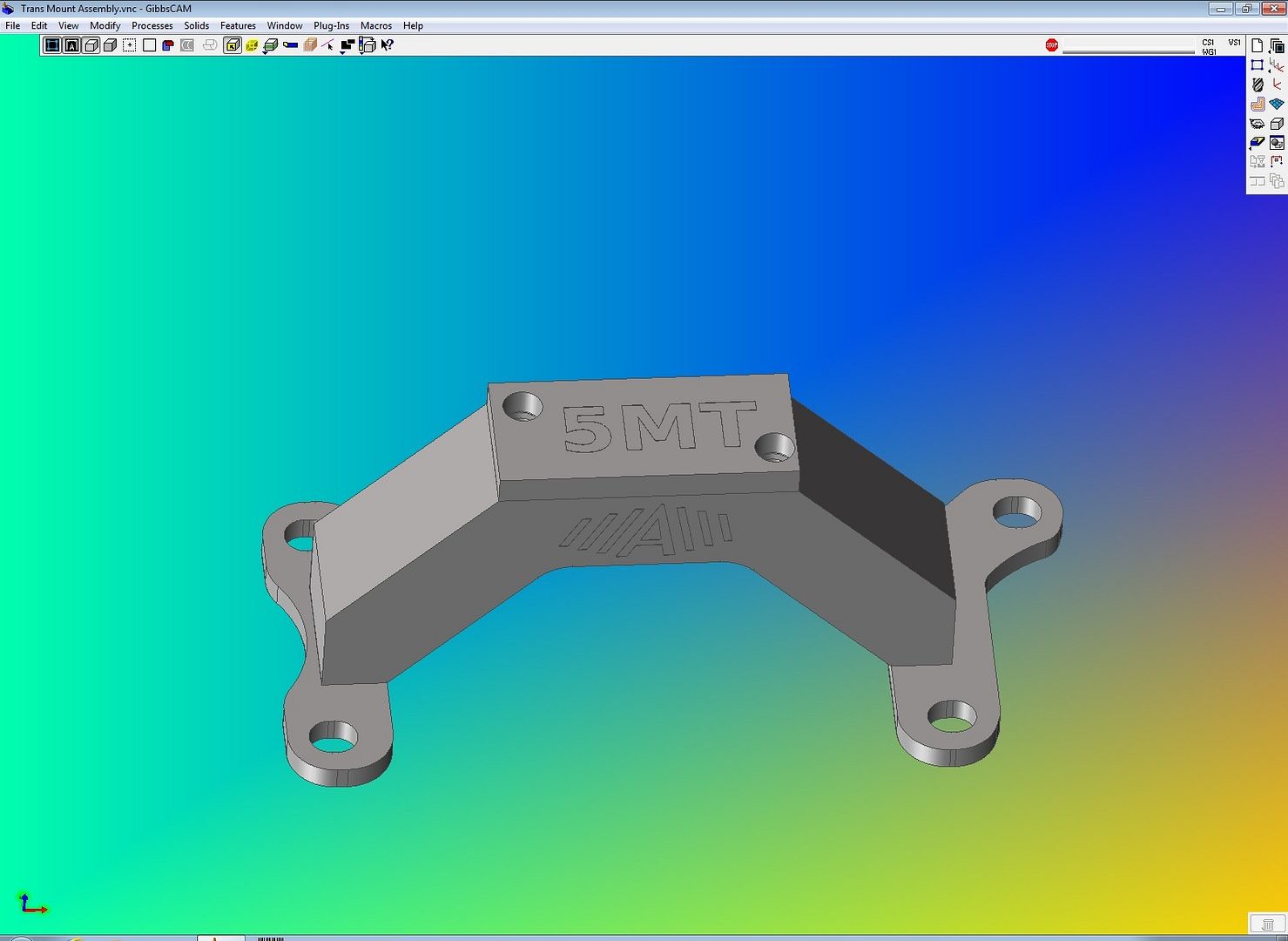

    Time to get this trans mount done. The easiest way possible for me to get hole locations is on the CMM (coordinate measurement machine).
    I drew a simple model but had to head home, more to come this week. It will be way more carved out!
    The standard STI mount is pretty soft, the Group N mount is much stiffer and solid mounts with urethane bushings, is pretty much solid but this mount will take the cake and some teeth lol jk :) Also the STI (6mt) mount is 2.87" tall and the 5mt is 3.17" tall, everything else is identical.

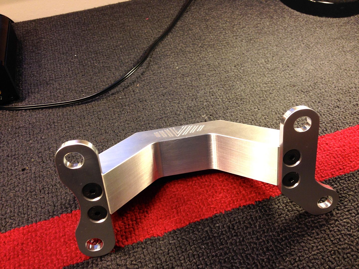

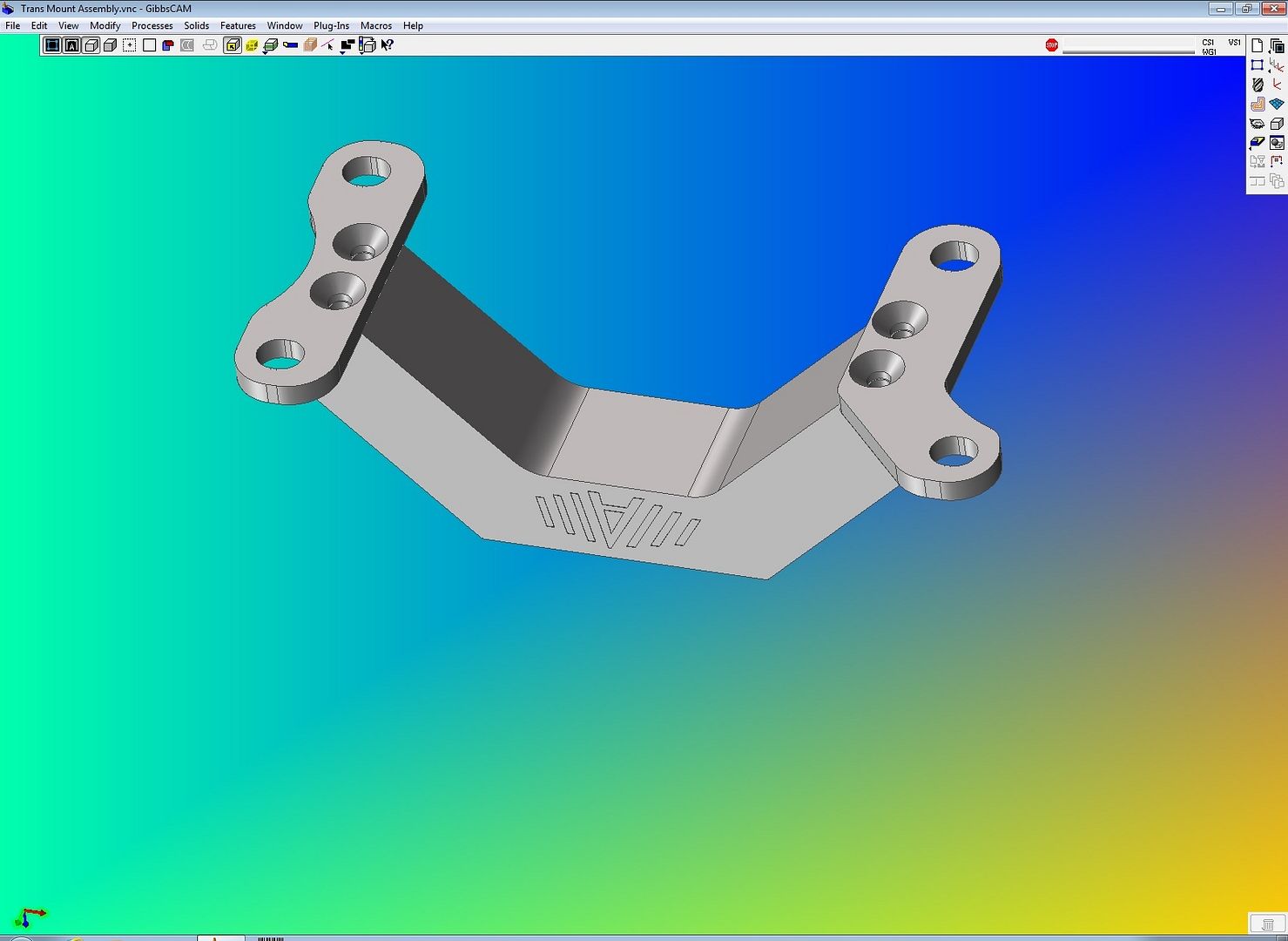

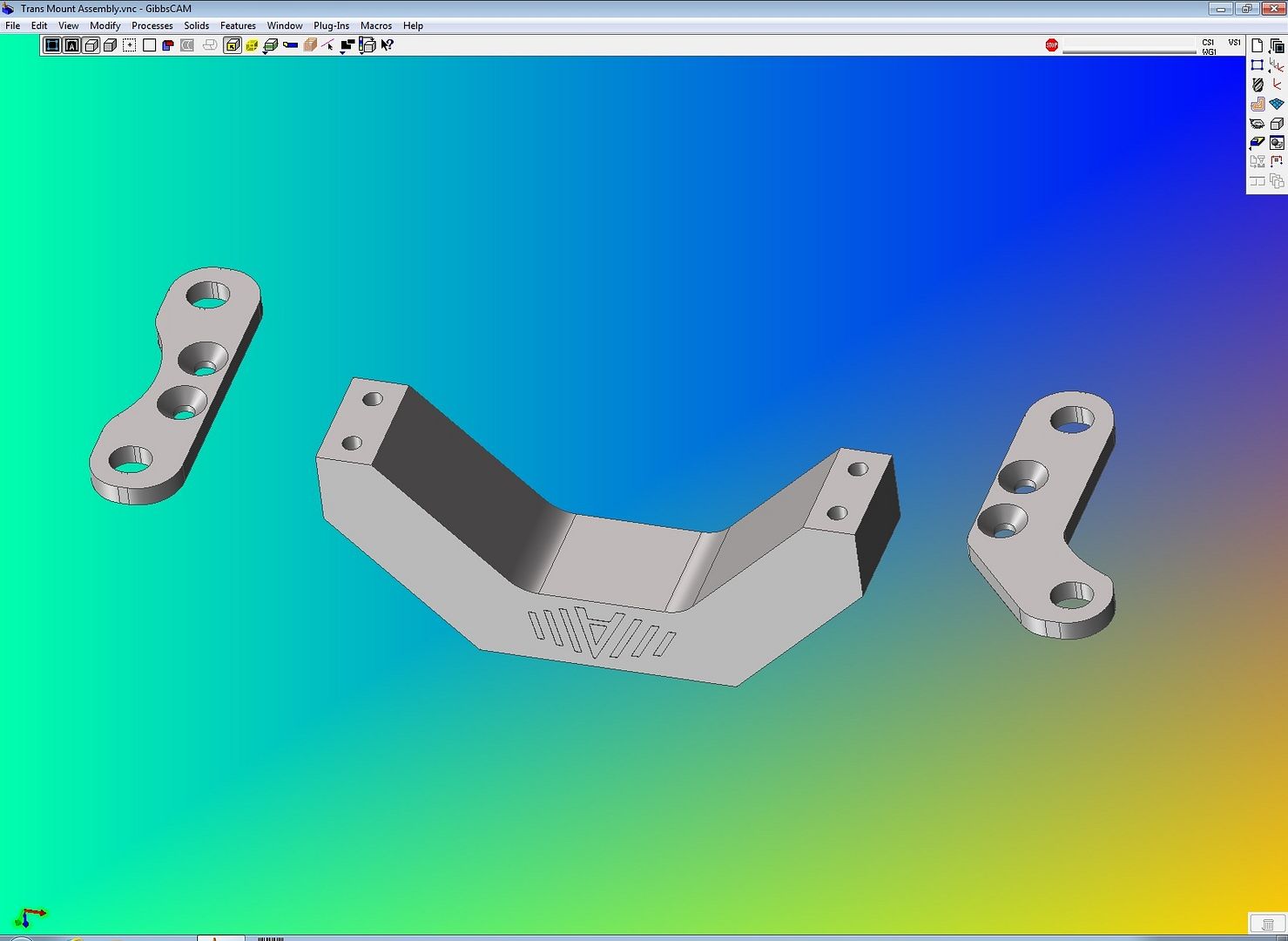

    I modeled up a one piece design but am thinking about a three piece design to simplify the manufacturing process and keep costs down. It's greatly reduced compared to the OEM unit. The four mounting points are slotted for more adjustment if needed.

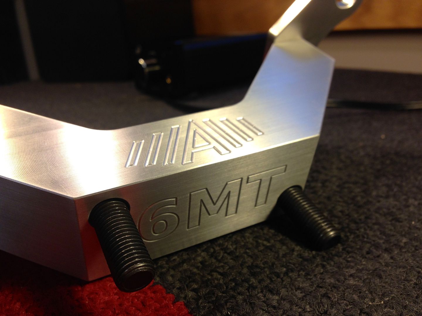

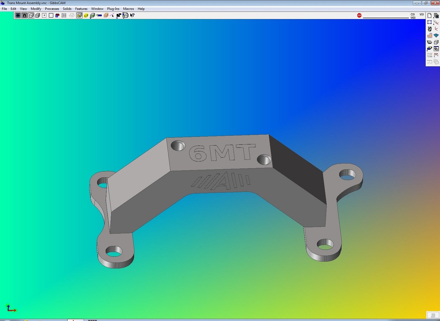

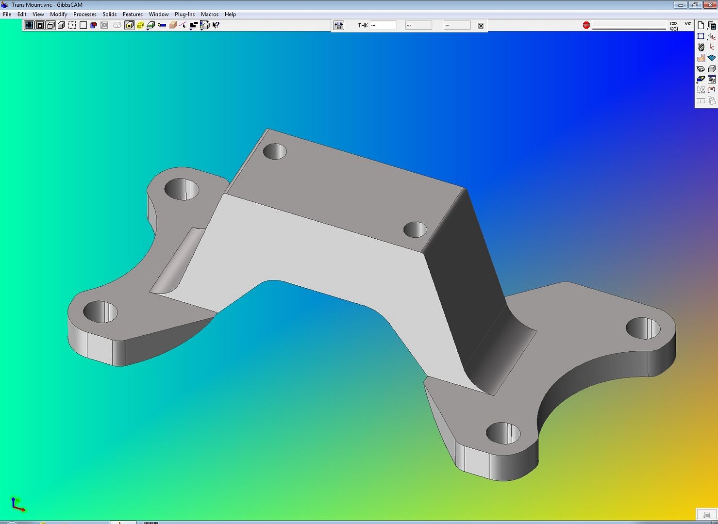

    Modified the model to reflect a 3 piece design, it will also incorporate a shim for use with both 6mt and 5mt transmissions. It should be very light and strong!

    Made a new shift handle and a shorter knob version but didn't have time to snap anymore pictures before i had to leave the shop. Just lovely how it fits in your hand, can't wait to test it at the track in a few weeks!

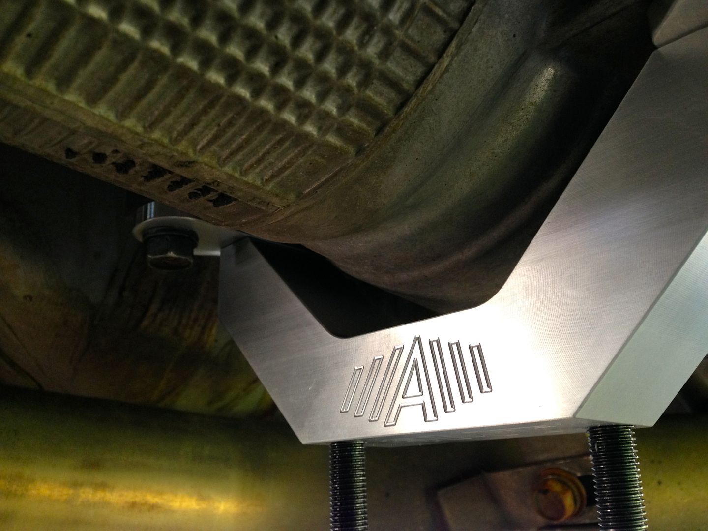

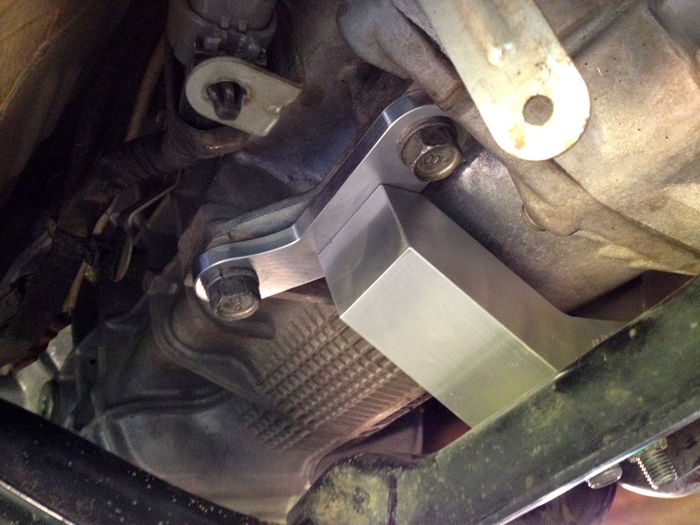

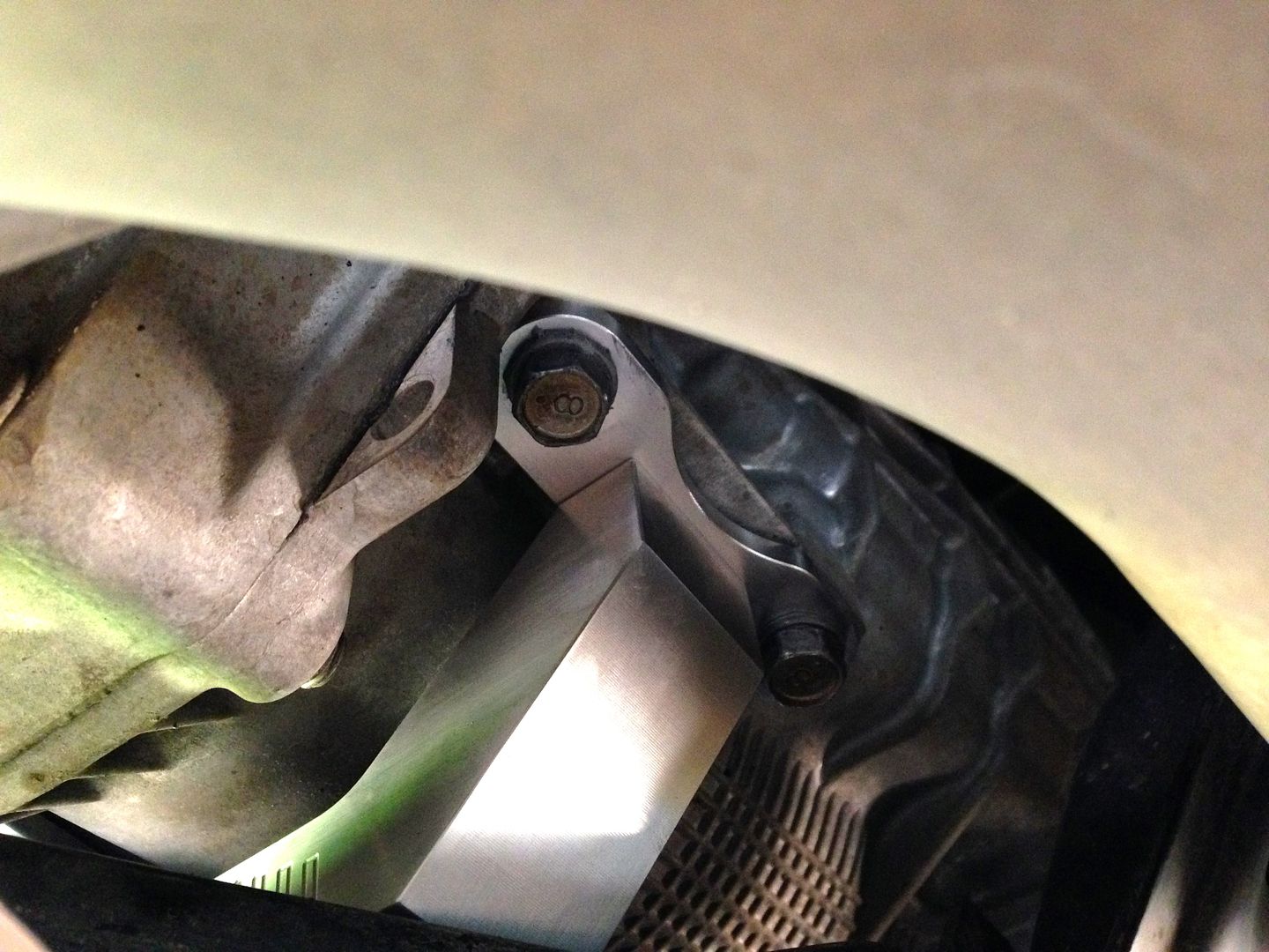

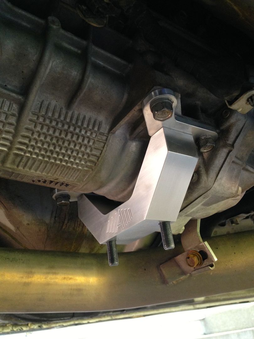

    I will be installing the newly made trans mount tomorrow, along with StopTech Street Pads :)
    After looking at it, the "A" engraving was flipped, since it is mounted that way. Didn't think about that when i drew it.

    What kind of CMM are you running? zeiss, brown & sharpe?
  44. Aluminati
    Aluminati Vendor
    636
    178
    We have a Zeiss. Works great!

    Put the trans mount on today and took it for a test drive. First thing i noticed was very quick engagement and instant throttle response. Not much increase in NVH but this is coming from the Group N style mount. The quicker engagement seems to help daily driving with my FX500 clutch (easier to get going in first).
    Overall i am very pleased with the design and will monitor it for a few weeks to see signs of stress but believe it will hold up to anything. This Friday i'll be at the track and it will definitely be put through it's paces.
    Once testing is done we will run batches of motor, pitch stop and trans mounts. This will official lunch our product line of car parts (Under Aluminati Sound LLC).
