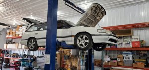

    Finally got the lift up in the garage. So the projects will start to get done a little faster.
    The Postal wagon im waiting on a title issue for sadly. But I will get it figured out. Then that project will get spicy. But for now she sits. 138102280_5820915397922189_4323114534485876357_o.jpg
    For some reason decided to get the RS going again, This time with a ej20k longblock, jdm wrx 4.11 trans and ej20g td05 turbo and intake manifold, tuned ecu for 550cc injectors. Basically the usual setup around here.

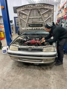

    Now the black 1998 Legacy GT with the v4 WRX engine swap. Was my daily driver basically all winter until very recently. I did a few upgrades to it since I last updated this.
    I Put in the JDM projector headlights and foglights, JDM smoked tail lights, and replaced the power antenna.
    144987338_5917571678256560_9183256308558058097_n.jpg 144362014_5917571768256551_5277609286369915904_n.jpg
    All that salt :(
    When I got the car the factory BPV was broken and not connected, they are made out of plastic and very fragile, found a good one online as well as a silicone turbo inlet, when I installed the BPV the car would now do about 14psi instead of 7psi on the TD04. But that was not enough.
    I had a VF28 on the shelf from my old 1st gen Tleg from a few years back, so I put that on after I sourced a V4 STI ECU, Injectors and MAF.
    171559462_6244831938863864_5739527249286992645_n.jpg 170259114_6231091850237873_5448962470039203998_n.jpg
    After fighting some bad injectors (typical old garbage) It now runs great! Much much quicker, and 8250rpm rev limit with the 75 STI ecu. Not the smartest move without the shim under bucket STI heads, but definitely worth all of the effort for the upgrade.

    I went to the DMV for tabs and was told I needed new plates so I got the critical habitat NEW style with the bees and the butterflies, Im not the biggest fan of vanity plates honestly.

  44. Quinn
    Quinn Well-Known Member
    314
    255
    Hastings, MN
    Little mockup of a GT28rs (I think? absolutely no idea) Something to do for winter.

  45. Quinn
    314
    255
    Hastings, MN
    If you look way back at the beginning of this thread, you will probably recognize this car, Sold it to a buddy but the engine let go due to them putting a microsquirt ecu on it. Another friend bought it from him and we got it going again how it should be.
